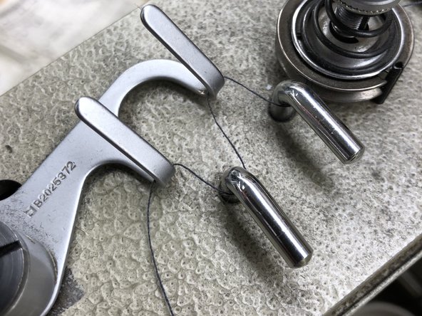

    3. Juki Chainstitch Machine Thread and Needle Replacement: step 3, image 1 of 1
      • Continue the threading, weaving through the pull-off lever.
      Ask FixBot
    4. Juki Chainstitch Machine Thread and Needle Replacement: step 4, image 1 of 2 Juki Chainstitch Machine Thread and Needle Replacement: step 4, image 2 of 2
      • Adjust the thread pull-off lever as well as adjust the position of the nipper bar block to the left or the right.
