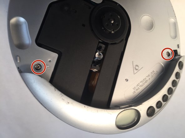

    • Flip the CD player back and open the lid. You will see two 10 mm Phillips screws on the left and right side under the lid.
    • To open the lid, push the button on the far right with an ejection symbol. Once the button is pushed, carefully lift the lid.
  4. Jensen CD Player Electric Motor Wire Replacement: step 4, image 1 of 2 Jensen CD Player Electric Motor Wire Replacement: step 4, image 2 of 2
    • Unscrew each 10 mm Phillips screw with the screwdriver, and place them outside safely.
    • Note the order in which you took the screws out.

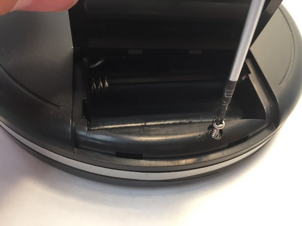

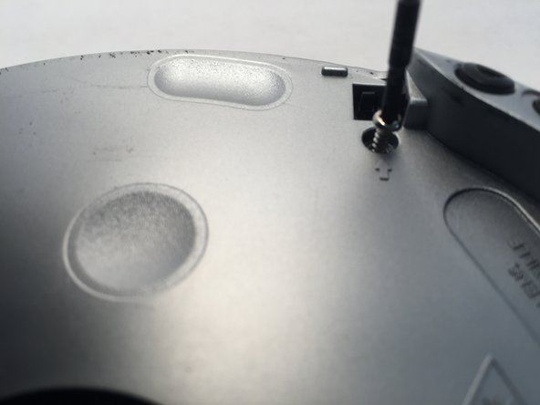

  5. Jensen CD Player Electric Motor Wire Replacement: step 5, image 1 of 2 Jensen CD Player Electric Motor Wire Replacement: step 5, image 2 of 2
    • Turn the CD player upside down and open the battery compartment. You will see one more 10 mm Phillips screw inside. Unscrew it.
    • Use the Phillips screwdriver to remove the screw. Place the screw outside safely.

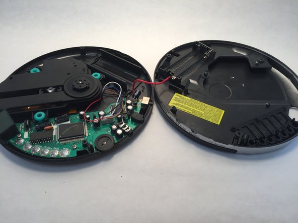

  6. Jensen CD Player Electric Motor Wire Replacement: step 6, image 1 of 3 Jensen CD Player Electric Motor Wire Replacement: step 6, image 2 of 3 Jensen CD Player Electric Motor Wire Replacement: step 6, image 3 of 3
    • Now, open the CD player, and check the components inside.
    • Be careful as this step requires some force.

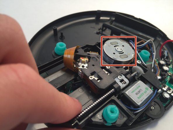

  7. Jensen CD Player Electric Motor Wire Replacement: step 7, image 1 of 3 Jensen CD Player Electric Motor Wire Replacement: step 7, image 2 of 3 Jensen CD Player Electric Motor Wire Replacement: step 7, image 3 of 3
    • Locate the motor on the bottom portion of the CD player. Lift the motor up and turn it over.
    • Operate the motor carefully, since it is still connected to some wires.

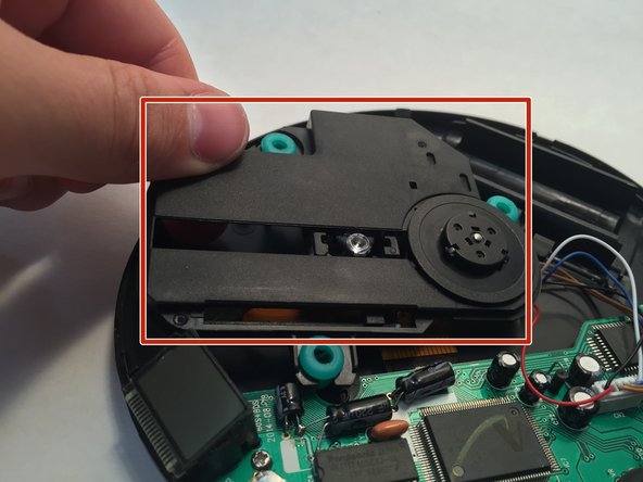

  8. Jensen CD Player Electric Motor Wire Replacement: step 8, image 1 of 1
    • Locate these two small wires.
    • Check whether both the wires are connected to the electric motor. If not, that is a probable reason why the CDs are not spinning once the device is turned on.

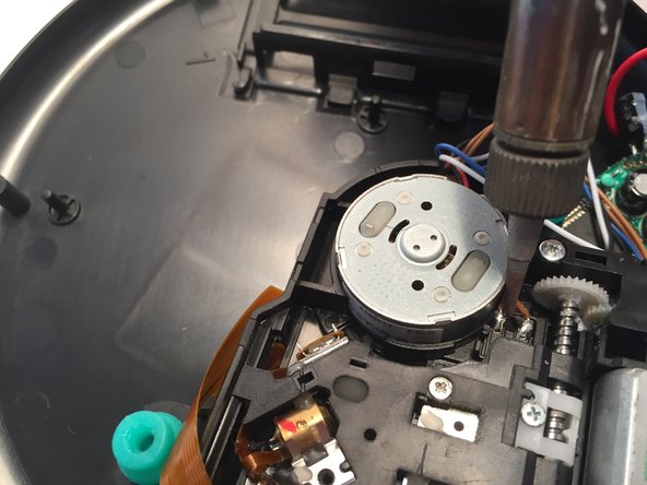

  9. Jensen CD Player Electric Motor Wire Replacement: step 9, image 1 of 2 Jensen CD Player Electric Motor Wire Replacement: step 9, image 2 of 2
    • Resolder the disconnected wires. This is a lengthy procedure.
    • Be cautious, as the soldering iron is hot and may cause skin burns.
    • Make sure to wash your hands after dealing with the solder.
