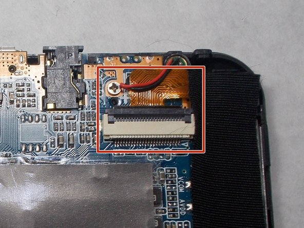

    1. JLab Pro-7 Front Facing Camera Replacement, Front Facing Camera: step 6, image 1 of 2 JLab Pro-7 Front Facing Camera Replacement, Front Facing Camera: step 6, image 2 of 2
      • This guide will show you how to remove the front facing camera.
      • At the top right of the motherboard there is a ribbon cable. The red rectangle shows where we are referring to.
      Ask FixBot
    2. JLab Pro-7 Front Facing Camera Replacement: step 7, image 1 of 1
      • Disconnecting ribbon connectors don't need a lot of force to be done. Like always, be gentle with all of the components that you're working with.
      • In order to disconnect you are going to need your iFixit pry tool to lift the black tab. The black tab is shown using red arrows in the picture.
      • Once the black tab is flipped up you can easily just pull the ribbon connector out of the ribbon cable connector.
      Ask FixBot

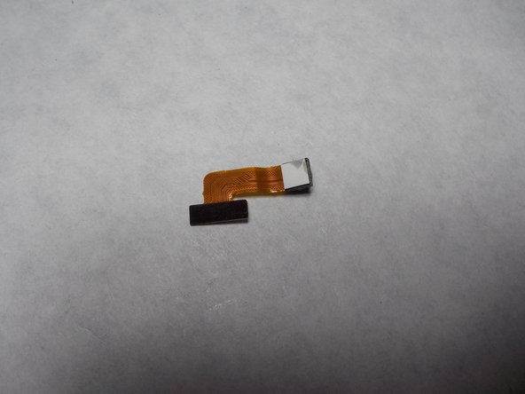

    3. JLab Pro-7 Front Facing Camera Replacement: step 8, image 1 of 2 JLab Pro-7 Front Facing Camera Replacement: step 8, image 2 of 2
      • Once the ribbon connector and cable have been properly separated the front facing camera will just pop out.
      • Now the front facing camera can be easily replaced.
