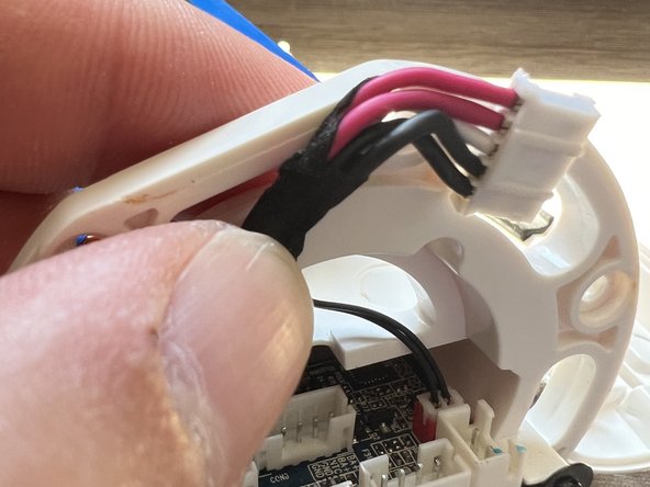

    8. JBL Pulse 3 Battery Replacement, Separating the lower section and the LED tube + battery: step 8, image 1 of 3 JBL Pulse 3 Battery Replacement, Separating the lower section and the LED tube + battery: step 8, image 2 of 3 JBL Pulse 3 Battery Replacement, Separating the lower section and the LED tube + battery: step 8, image 3 of 3
      • Remove the screws securing the LED tube, which also contains the battery.
      • Disconnect the cables connecting it to the lower section.
      Ask FixBot

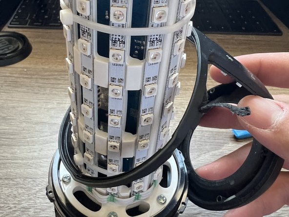

    9. JBL Pulse 3 Battery Replacement, Removal of the remaining support screws: step 9, image 1 of 2 JBL Pulse 3 Battery Replacement, Removal of the remaining support screws: step 9, image 2 of 2
      • Almost there! Remove the screws from the top and bottom of the LED and battery tube.
      • Take this opportunity to remove the cable ties by cutting them with a pair of flush cutters.

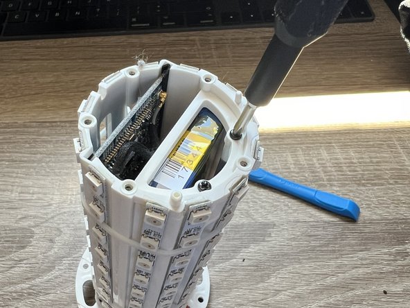

    12. JBL Pulse 3 Battery Replacement, Opening the battery compartment: step 12, image 1 of 2 JBL Pulse 3 Battery Replacement, Opening the battery compartment: step 12, image 2 of 2
      • There you go! You can open the battery compartment; it's like a shutter. You can open it with your nylon tool.
      Ask FixBot
    13. JBL Pulse 3 Battery Replacement, Disconnecting the battery: step 13, image 1 of 2 JBL Pulse 3 Battery Replacement, Disconnecting the battery: step 13, image 2 of 2
      • All that remains is to remove the battery and replace it.
      • You must unplug the Glued-Down Cables connecting the battery to the board, there are two!
      • WARNING: If your battery is glued in place, DO NOT use a box cutter, knife, or any other sharp object. Doing so could cause a fire or even very serious burns.
