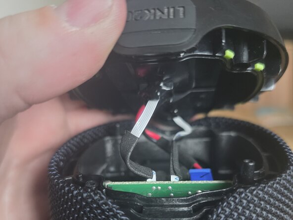

    2. JBL Link 20 Battery Replacement: step 2, image 1 of 2 JBL Link 20 Battery Replacement: step 2, image 2 of 2
      • Use your Angled Tweezers to gently pry up the gray clip to release the cable.
      • Remove the screws in the corners, but leave the plastic in place for now. It is still secured by 2 difficult screws elsewhere.

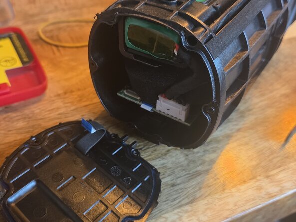

    3. JBL Link 20 Battery Replacement, Bottom cover: step 3, image 1 of 2 JBL Link 20 Battery Replacement, Bottom cover: step 3, image 2 of 2
      • Follow the same procedure as step 1: detach using a Jimmy and remove the Phillips screws.
      • Disconnect the cables using your angled tweezers (flip up the grey flap).

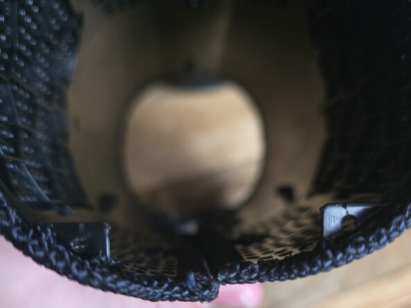

    4. JBL Link 20 Battery Replacement, Removing the casing: step 4, image 1 of 2 JBL Link 20 Battery Replacement, Removing the casing: step 4, image 2 of 2
      • Use your Jimmy and spudger to pry along the seam of the casing to lift it.
      • There are clips at the top and bottom that are snapped over a tab. It may be helpful to carefully insert a tool behind these areas if the casing remains stuck at the top or bottom while you are prying it loose.
      • Once loose, slide the casing off the internal assembly.
