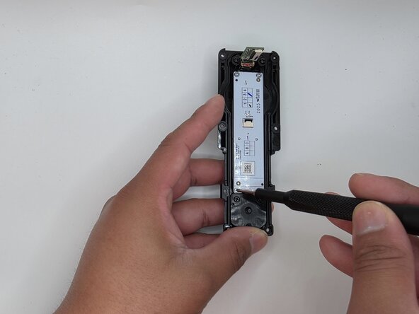

    1. JBL Grip LED Board Replacement, LED Board: step 5, image 1 of 3 JBL Grip LED Board Replacement, LED Board: step 5, image 2 of 3 JBL Grip LED Board Replacement, LED Board: step 5, image 3 of 3
      • Remove the four 3mm screws securing the board to panel with a Phillips #2 screwdriver.
      Ask FixBot

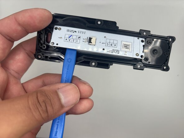

    2. JBL Grip LED Board Replacement: step 6, image 1 of 3 JBL Grip LED Board Replacement: step 6, image 2 of 3 JBL Grip LED Board Replacement: step 6, image 3 of 3
      • Pry the board with the plastic opening tool from the panel.
