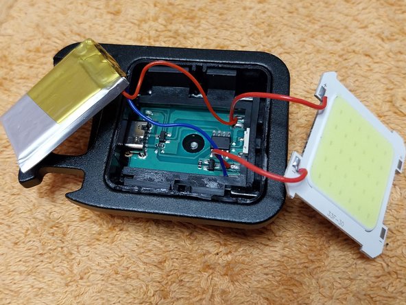

  3. Intermittent ON/OFF Push Button Fault, Push Button Repair, Mini Square Chinese Flashlight: step 3, image 1 of 2 Intermittent ON/OFF Push Button Fault, Push Button Repair, Mini Square Chinese Flashlight: step 3, image 2 of 2
    • View of the very simple internal composition; separated into 3 parts, rechargeable battery, PCB board with mini USB socket and push button, LED board.

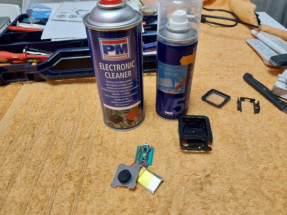

  5. Intermittent ON/OFF Push Button Fault, Push Button Repair, Mini Square Chinese Flashlight: step 5, image 1 of 2 Intermittent ON/OFF Push Button Fault, Push Button Repair, Mini Square Chinese Flashlight: step 5, image 2 of 2
    • Therefore, the 2nd repair option, (since I don't have a suitable replacement button) is to apply "ELECTRONIC CLEANER" contact cleaner copiously while simultaneously sliding the button from one side to the other to try to clean the interior contact.
    • Subsequently, canned air was applied (Air canister on the right for cleaning keyboards) by means of which the inside of the button and the PCB were dried.

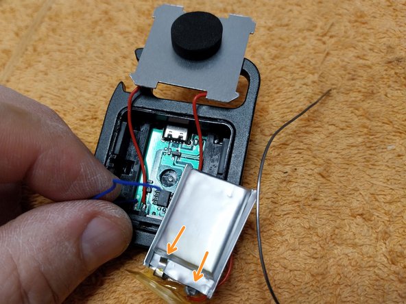

  6. Intermittent ON/OFF Push Button Fault, Push Button Repair, Mini Square Chinese Flashlight: step 6, image 1 of 3 Intermittent ON/OFF Push Button Fault, Push Button Repair, Mini Square Chinese Flashlight: step 6, image 2 of 3 Intermittent ON/OFF Push Button Fault, Push Button Repair, Mini Square Chinese Flashlight: step 6, image 3 of 3
    • Once the PCB and the switch were dry, it was repeatedly tested, responding perfectly, so the flashlight was reassembled.
    • BE CAREFUL WITH THE BATTERY the truth is, it gave me a scare, during assembly; it became very hot in a few seconds because one of its terminals was short-circuited with the aluminum sheet of the LED, so to protect the terminals I chose to place protective insulating tape (Orange) covering the 2 terminals.
    • In order not to apply force in the re-assembly. A piece of black rubber was cut from the LED plate. (blue arrow)

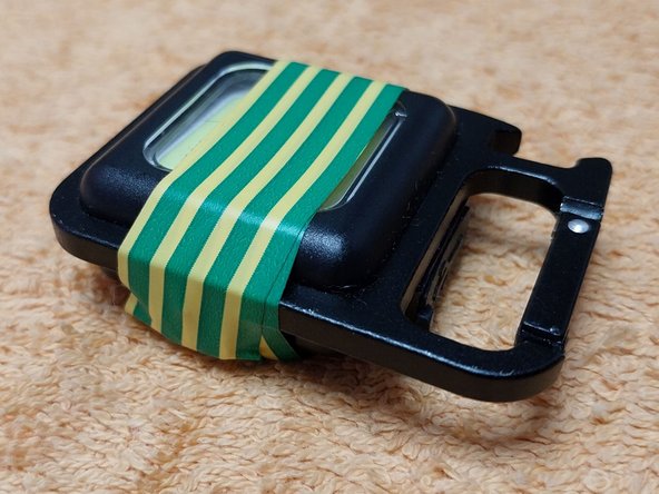

  7. Intermittent ON/OFF Push Button Fault, Push Button Repair, Mini Square Chinese Flashlight: step 7, image 1 of 2 Intermittent ON/OFF Push Button Fault, Push Button Repair, Mini Square Chinese Flashlight: step 7, image 2 of 2
    • Since the two halves were fused together, during assembly and we forced it open; we must make sure that the lid is correctly positioned and apply a little silicone onto the lid before assembling it, so that it dries properly and remains perfectly closed.
