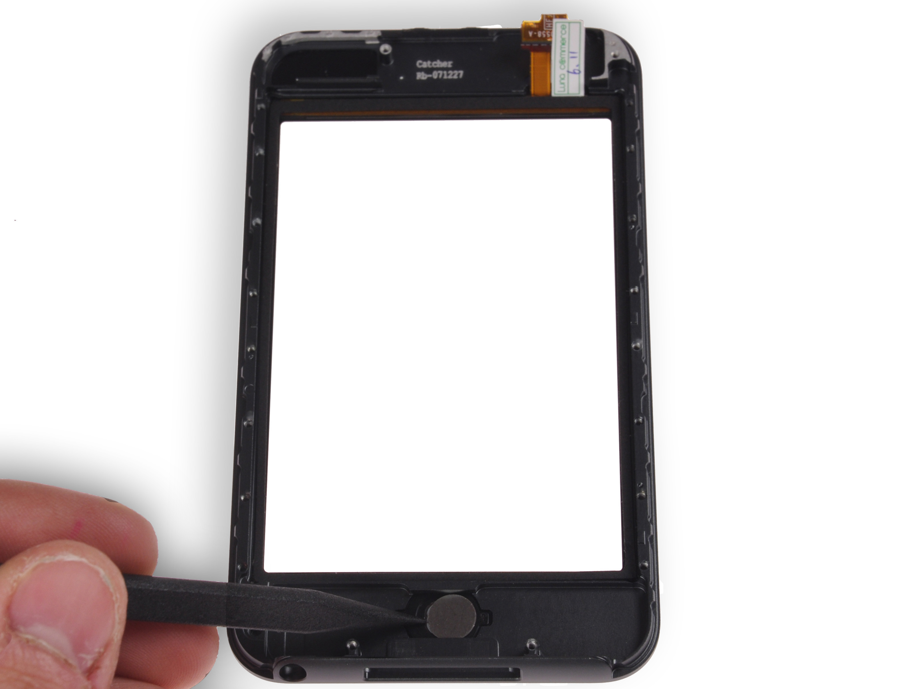

  14. iPod Touch 1st Generation Front Panel Assembly Replacement, Front Panel Assembly: step 14, image 1 of 1
    • You now need to transfer the metal spacing into the new front panel. This allows the home button to get in contact with the logic board.
    • This spacing is glued to the front panel. Carefully insert a spudger below it and pry it out.
