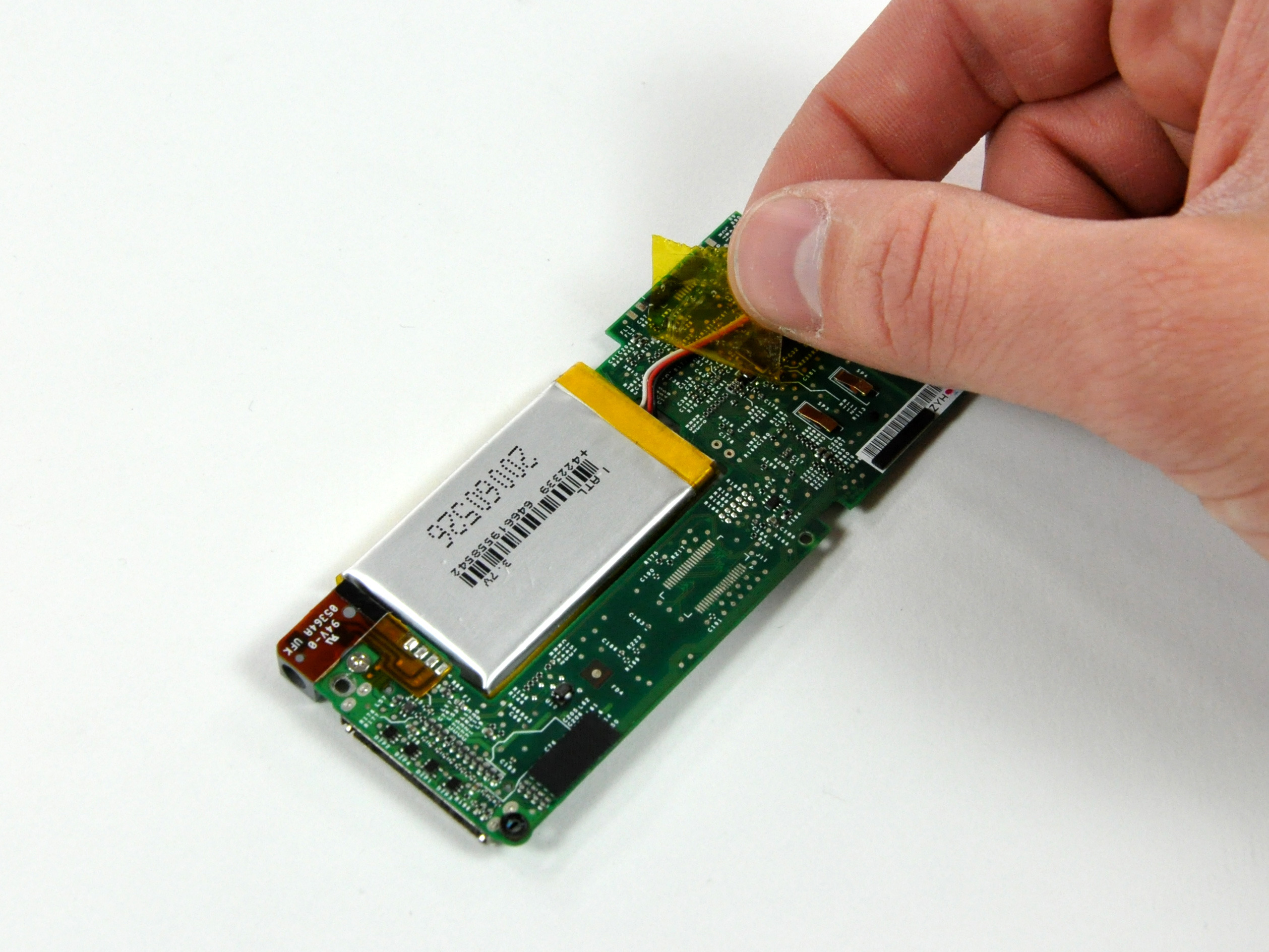

Insert the flat end of a spudger between the battery and the headphone jack side of the front case to pry the battery up off the adhesive securing it to the front case.
Rotate the battery out of the iPod and lay it next to the iPod. The battery is still soldered to the logic board by three wires, so don't remove it entirely.
Tool used on this step:Tweezers$4.99
Begin by heating the exposed end of the white battery lead with the tip of a soldering iron while simultaneously pulling the lead away from the connection, using tweezers to grasp the lead by the insulation.
De-solder the remaining leads, following the procedure illustrated above.

Place the logic board flat on a table with the gold ground contacts (shown in orange) facing up.
Using a pair of tweezers, insert the stripped ends of the battery leads into their respective holes.
Insert the black lead into the hole nearest the hold switch (shown in red).
Insert the red lead into the center hole.
Insert the white lead into the hole furthest from the hold switch.
Solder the connection by momentarily placing the tip of the soldering iron against the connection, melting solder into the connection, and quickly removing both the solder and the tip of the soldering iron from the connection. The solder should flow around the new battery lead, solidly connecting it to the pad on the logic board.
Solder the other two battery leads in the same fashion, taking care not to bridge any of the connections together.
