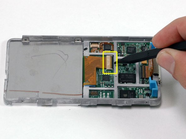

  31. iPod Classic Display Replacement, Display: step 31, image 1 of 1
    • Use a spudger to flip up the plastic tab holding the orange display ribbon in place. The tab will rotate up 90 degrees towards the display, releasing the ribbon cable.

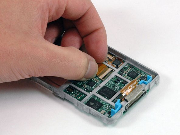

  32. iPod Classic Display Replacement: step 32, image 1 of 1
    • Slide the orange display ribbon cable directly out of its connector.
  33. iPod Classic Display Replacement: step 33, image 1 of 1
    • Lift the framework assembly up, and slide the display and LCD metal backplate out of the framework assembly.
