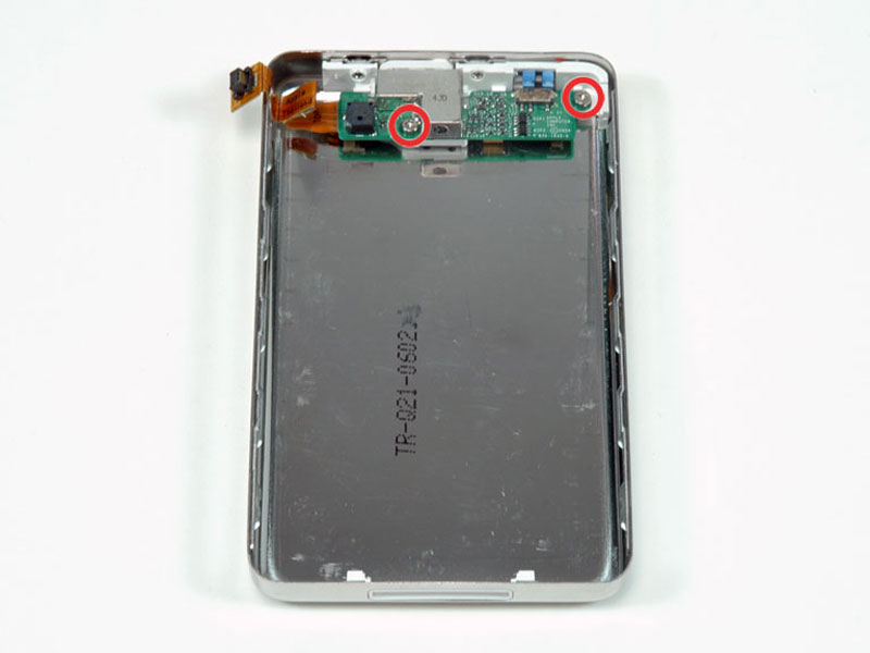

  5. iPod 4th Generation or Photo Headphone Jack Bracket Replacement, Headphone Jack Bracket: step 5, image 1 of 1
    • Remove the 2 silver T6 Torx screws from the headphone jack.
  6. iPod 4th Generation or Photo Headphone Jack Bracket Replacement: step 6, image 1 of 1
    • Remove the 3 silver Philips screws securing the headphone jack to the rear panel.
  7. iPod 4th Generation or Photo Headphone Jack Bracket Replacement: step 7, image 1 of 1
    • Grasp the white headphone jack bracket and lift it out of the iPod.
