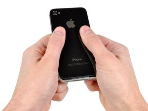

Push the rear panel toward the top edge of the iPhone.
Pinch the rear panel with your fingers and lift it away from the iPhone. Alternatively, use a Small Suction Cup .
