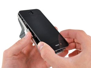

Image 1/2: The panel will move about 2 mm. Image 2/2: The panel will move about 2 mm.
  • Push the rear panel toward the top edge of the iPhone.
  • The panel will move about 2 mm.
the back won't budge! I cant get it off! what do i do?
Debbie - Reply
Use a suction cup to pull the back screen gently.
snazzify -

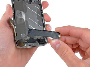

Image 1/1: Be careful not to damage the plastic clips attached to the rear panel.
  • Pinch the rear panel with your fingers and lift it away from the iPhone. Alternatively, use a Small Suction Cup .
  • Be careful not to damage the plastic clips attached to the rear panel.
  • If you are installing a new rear panel, be sure to remove the plastic protective sticker from the inside of the camera lens and the sticker from the large black area near the lens.
using suction cup with too much force breaks rear panel
lily einstein - Reply

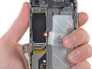

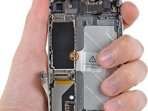

Remove the single 2.5 mm Phillips screw securing the battery connector to the logic board- for me this Phillips screw won't budge from its place have tried all the phillips combinations 000, 00, 0, 1 and the straight /slotted 1.5 mm but nothing. can some help me please purchased a replacement battery for my iPhone 4 but not able to do it just because of this screw.
Naved Zaidi - Reply
If the screw head is not buggered, press the tip of a hot soldering iron to the screw for a second or two. Don't get it too hot, or you'll damage something.
splaye -
Image 1/1: Some devices may have two screws, one of which holds down the contact pad which is located above the screw indicated in red in the photo.
  • Remove the single 2.5 mm Phillips screw securing the battery connector to the logic board.
    • Some devices may have two screws, one of which holds down the contact pad which is located above the screw indicated in red in the photo.

Stuck on step 4 can't unscrew the battery screw. stopped trying as all i seem to be doing is damaging the screw any tips as to how to approach this?
Tazziii - Reply
I ended up drilling the head of one of my screws off. It was already damaged. Then I think I used needle pliers to spin it out once the plate came off and there was more room to grab the shank.
torqvette -

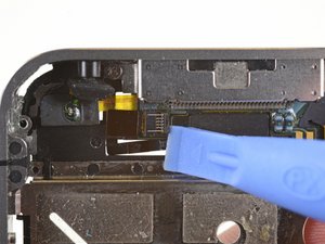

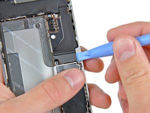

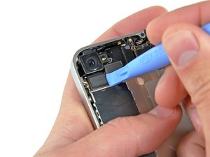

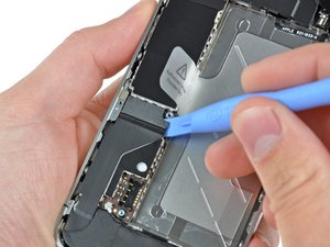

Image 1/1: Pry from the top and bottom of the connector bracket—there isn't as much of an overhang on the sides, and you may damage the connector.
  • Use a plastic opening tool to gently pry the battery connector up from its socket on the logic board.
    • Pry from the top and bottom of the connector bracket—there isn't as much of an overhang on the sides, and you may damage the connector.
  • Be very careful to only pry up on the battery connector and not the socket on the logic board. If you pry up on the logic board socket, you may break it entirely.

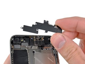

  • Remove the metal clip covering the antenna connector.
There is a small black L-shaped bracket of some sort that tits between the battery connector and the motherboard socket, with a loop on one corner that sits betwen the riserand the battery connector. Remove this now, and do not forget to re install it on assembly.
stevesontheroad - Reply
When reattaching this bracket make sure your Battery ribbon is already tucked underneath the battery with only the minimum clearance required. Then make sure the brackets overhang is over the battery ribbon. Dont try to slide it under the Ribbon.
crimney - Reply
In Step 5 be EXTRA careful with the battery connector as the socket can come off extremely easy. This can mess up the replacement a little bit and cost you extra. Otherwise, this guide is excellent.
Good luck, fixers!
I fix(ed) it!
mateuszkus - Reply
When removing this L shaped piece, it should be shown ON CAMERA where it came from and the exact position it was in while in the phone, I had to take 2 screws (not 1 like said in the video) out to get to this piece and once that second screw came up I didn't get a chance to see where this piece came from because it popped right out. I was extremely nervous but I believe I got it back in properly.
kellicaudill - Reply
Putting the antennae cover back in place is impossible without a good photo. I used this link to refer to:

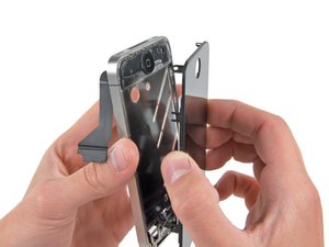

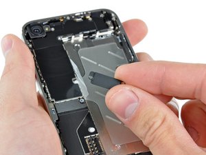

Image 1/3: You may need to use a plastic opening tool to loosen the adhesive under the battery. Image 2/3: Before reconnecting the battery connector, be sure the contact clip (shown in red) is properly positioned next to the battery connector. Image 3/3: Before reassembly, clean metal-to-metal contact points with a de-greaser such as windex. The oils from your fingers have the potential to cause wireless interference issues.
  • Use the clear plastic pull tab to gently lift the battery out of the iPhone.
  • You may need to use a plastic opening tool to loosen the adhesive under the battery.
  • Before reconnecting the battery connector, be sure the contact clip (shown in red) is properly positioned next to the battery connector.
  • Before reassembly, clean metal-to-metal contact points with a de-greaser such as windex. The oils from your fingers have the potential to cause wireless interference issues.
  • Perform a hard reset after reassembly. This can prevent several issues and simplify troubleshooting.
Just be careful when removing the battery with the plastic pull tab. On some units, they use so much glue that it's virtually impossible to take the battery.
In such an instance, you could use the iPod opening tool to assist (just be careful where you stick it!)
klubn - Reply
use the iPod opening tool to pry gently under the battery from the outer edge of the phone and work towards the plastic tab. the tab is not actually attached to the battery itself, but a plastic sheet between the battery and inner frame. the adhesive on the battery tends to be under the edge of the battery nearest the center of the phone.
David Iwanicki - Reply
Understand that the plastic pull tab is part of the phone. It sits under the battery like a tray and is not connected to the battery so it needs to stay in tact.
mattcfi - Reply

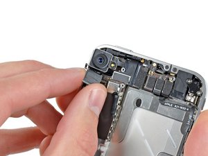

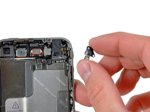

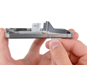

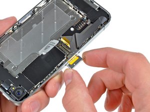

Image 1/2: This may require a significant amount of force. Image 2/2: Remove the SIM card and its holder.
  • Use a SIM card eject tool or a paperclip to eject the SIM card and its holder.
  • This may require a significant amount of force.
  • Remove the SIM card and its holder.
The grey cable on the top right of the 1st picture might be confusing, it's the connector with cable which you'll disconnect in step 9 only, so you can't see it this way in this phase.
mhejjas - Reply

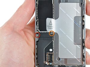

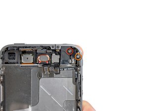

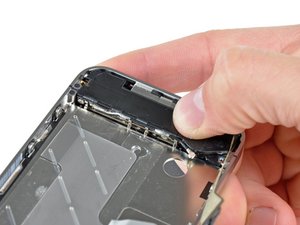

Image 1/2: One 1.2 mm Phillips Image 2/2: One 1.6 mm Phillips
  • Remove the following two screws:
    • One 1.2 mm Phillips
    • One 1.6 mm Phillips
  • Remove the thin steel dock connector cable cover from the iPhone.
  • Before reassembly, be sure to clean all metal-to-metal contact points on the dock connector cable cover with a de-greaser such as windex. The oils on your fingers have the potential to cause wireless interference issues.
Be careful to make sure you don't pinch the clear plastic tab under the mobo when reinstalling. :P
jonathan - Reply
Box 3 BOx 3 Box 3 petite vis a gauche
bigben8 - Reply
I had trouble with my SIM card at this point. It wouldn't go all the way in - only about 1mm short but enough to keep the phone from being able to read it. It seems that the red screw in this step is the culprit. I loosened it up a bit and the SIM card tray was able to fit flush.
budgetbooksfl - Reply

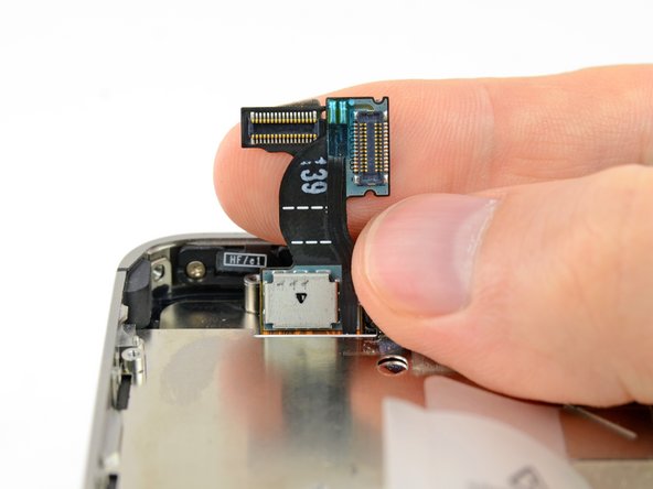

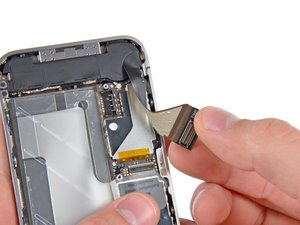

  • Use an iPod opening tool to gently pry the dock cable connector up off the logic board from both short ends of the connector.
Use the 1.6mm screw standoff as leverage against to lift the connector.
Mark - Reply
Make sure not to pry too much under the flex cable because you will likely damage the gold / silver shining adhesive tape that is located beneath it.
The guide is missing a comment on this and one would not expect the tape there. Check out the photos of step 10 to get an idea of how the tape looks like.
I assume this to be some kind of head-conductive component.
It won't be much of a problem if you damage parts of it though.
But if you peel off / coil up too much of it, it could get too big and the flex cable could get damaged when it's pressed against it.
Stefan - Reply

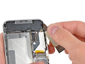

Image 1/2: Do not use excessive force to peel the dock ribbon cable off the logic board. Doing so may tear the cable. Image 2/2: Do not use excessive force to peel the dock ribbon cable off the logic board. Doing so may tear the cable.
  • Carefully peel the dock ribbon cable off the logic board and the lower speaker enclosure.
  • Do not use excessive force to peel the dock ribbon cable off the logic board. Doing so may tear the cable.
be extremely careful to check that there isnt any metallic conductive glue sticking, some may remain attached to the motherboard-connecter position in its space on top of the logicboard
Dai - Reply
So if that glue does stick to the 'motherboard', does it damage the phone?
Dalton - Reply
Image 1/1:
  • Use a plastic opening tool to pry the lower antenna connector up off its socket on the logic board.
NOTE: When replacing the logic board, be sure this antenna remains exposed and doesn't become trapped under the board.
charlesholt - Reply
Just wondering if it is possible and where to get one of those indicators
edward - Reply
what are you talking about here???
Steven Munoz - Reply
Yeah, would like to know the value of the little blue inductor ... my iPhone 4 doesn't have it any more and I have the worst signal.
PressureFM - Reply
I wasn't sure how to carefully detach the antennae. Can anyone offer some insight on how to reattach the antennae? Is it supposed to be soldered to the board? Or is it a pin attachment?
kulpsterdaman - Reply
see that tiny little blue thing just to the left of the antenna connector but before the screw? make sure you DON'T knock that out of place otherwise your iphone becomes a heavy ipod touch (yes. this idiot made that mistake while struggling to get the antenna connector back in - which for the record just clips back in). this would have been a handy tip for me while i was reading the instructions, which apart from that little trinket of information, were very easy to follow.
-dan
dan - Reply
Image 1/1:
  • Remove the 1.9 mm Phillips screw securing the bottom of the logic board to the inner case.
Be careful, I almost damaged this specific screw by using a Phillips #00 screwdriver. It's screwed in tighter than most others. You will need a Phillips #000 or else your #00 has to be a really sharp one.
Kelvin Leong - Reply
The cross on top of the screw on my phone is all messed up - not from me stripping it, it just looks like a manufacturing error. The screwdriver won't even fit into the screw, and I can't get it out (I have no idea how they got it in in the first place). Any suggestions?
Mike Machado - Reply
same here, screw stripped any suggestions?
Gary Woodward -
Couple of ways to get rounded-out-head screws;
1) use a tiny drop of super glue on the top place your screwdriver on the drop/screw, then sprinkle a bit of bicarb-soda on to the wet super glue, it'll harden very rapidly and form a fillet; wait a minute and you should be able to then unscrew the screw.
Be VERY CAREFUL when doing this, because you don't want to have superglue wicking between the screw and the circuit board.
Perhaps practice on some other things first.
I've removed several like this before; frequently I find the culprits for rounded out slots are ham-fisted people trying to do their own repairs in the past.
Paul L Daniels - Reply
Get a set of these precision screw extractors. I own a small electronics repair shop and I wouldn't be without them. If you buy them remember that the ends are reversible in case you dull one end. http://www.ifixit.com/Tools/Precision-Sc...
Joshua - Reply
Image 1/1: One 2.3 mm Phillips
  • Remove the following five screws securing the Wi-Fi antenna to the logic board:
    • One 2.3 mm Phillips
    • Two 1.6 mm Phillips
    • One 1.4 mm Phillips
    • One 4.8 mm Phillips
  • When re-assembling, start off with replacing the 4.8 mm Philips screw first, then the 2.3 mm. This is to ensure there is no mix-up, and avoid rendering the LCD and digitizer useless.
  • Also make sure to put the long 4.8 mm Philips back in correctly when reassembling. This is the ground for the Wi-Fi antenna and is often the culprit if you are having bad Wi-Fi reception after reassembly.
Be careful about the very small spring contact that is under the shield and around the 4.8 mm screw - it can spring out when the shield is removed. It must be reinserted prior to installing the shield, with the thick part up and the spring in contact with the gold pad to the right of the screw hole in the case.
Steve Noland - Reply
INCREDIBLE! Steve this probably happens to people all the time. The "very small spring contact that is under the shield and around the 4.8 mm screw" I will elaborate on. It's not so much around the 4.8mm screw as it actually part of the assembly where the 4.8 mm screw is tightened. I added an arrow to this picture to visually illustrate:
http://imageshack.us/photo/my-images/9/i...
I had no wifi at all until this was present. I had overlooked the piece and spent hours trying to figure out where it went. BIG THANK YOU to Steve for his comment. After fixing, my wifi was perfect.
Jimmy -
When re-assembling, start off with replacing the 4.8 mm Philips screw first, then the 2.3 mm. This is to ensure there is no mix-up, and avoid rendering the LCD and digitizer useless. Steve or someone -- can you explain what is meant by this? My LCD and digitizer now does not work, but I don't think I have any screws in the wrong place.
david -
I have the same issue than David. Could anyone elaborate on the brief note in the manual? Thank you!
Christoph Biehl -
Thanks for your notice! It really helps me.
antonvbondarev -
There is a washer under the plate that is held together by the 1.4mm Philips. This might come loose. Be careful not to lose it.
nsolis - Reply
Confirming this. It's not in the description and it came out when I disconnected the screw. At first I was unsure where it came from, but when I reassembled the phone, the yellow screw didn't make contact, so I realized the washer had to go under the contact plate.
marcx77 -
So that small washer behind the 1.4 screw became detached during reassembly. What affect does this have? My phOne started to overheat; I then turned off my wifi and things are fine.. How is this related you think?
mallorypichler -
If a nut under the YELLOW screw is rotating, hold the nut with tweezers.
yujin yamada - Reply
Somehow i twisted the head off of the 4.8mm screw (ground) during reassembly and not i have terrible wifi. Trying to come up with a solution.... any suggestions?
racaruso90 - Reply
On my phone the "washer" that the 1.4mm screw goes into I think is actually the mounting post that had come detached. I realize afterwards there was therefore no point removing this screw, but I did remove (and put it back afterwards) by holding onto the loose post/washer with tweezers to prevent it turning.
Anthony Berkow - Reply
Print this image out (step 13) - trust me, you'll need it later!
Alan Shenton - Reply
The "washer" that a few of the commenters have mentioned isn't a washer nor a broken post. It is a circular nut that helps the WiFi antenna get a good connection to the logic board. It is part of a sandwich: 1.4mm screw head WiFi antenna logic board ++ circular nut. I held it in place with tweezers and then screwed the 1.4mm screw in. Don't lose this nut!
tdroz - Reply
I found that the 1.4 mm screw measured a little less than 1.1 mm on my phone. So don't be confused by that.
Daniel - Reply
When I came to reassemble at this step, I noticed the 1.4mm screw no longer had anything to screw to. The nut or washer or whatever it is that you mention has gone. My screen does not work any more. Is this connected and/or is there anything I can do to peplace what is lost?
Chris - Reply
This screw is supposed to tie into a very small nut that sits under a small u-shaped tab in the EMI shield that is fixed to the PCB. Maybe that nut has moved or got lost. I recommend you to lift that small tab to find it because if loose it could create a short-circuit.
But that screw/nut is absolutely not essential to the LCD. It should work without it.
Christophe De Wolf -
I didn't see that small "nut" and the 1.4mm screw is loose. So I didn't install it back. My iPhone is working now but wondering any thing would turn wrong later...
Judy - Reply
Does any one know where to source a replacement for the little round "nut" trapped between shield and nut. I have lost mine... the yellow 1.4mm screw fits into this... it has a knurled edge.
It seems it should be captive soldered to the MB, but it comes lose...
franklydude - Reply
Do you need a different screwdriver for every one of these screws? They all seem to have different sizes.
Kaz - Reply
The second of the Two 1.6 mm Phillips was stripped...or I stripped it? So I got this far and now i'm retreating and putting the iphone back together. Was going to sell on ebay but now I can not. Oh well...
brian - Reply
I used an elastic band pulled taught over the blade of a flat headed screwdriver to hold the nut (beneath the yellow screw) in place. Alternatively I was thinking of carving the eraser on the end of a pencil into a wedge shape to do the same job when tightening the screw on reassembly. Just needs something to grip it in place to stop it spinning.
Lee Noble - Reply
Image 1/3: Use the tip of a spudger to pull the Wi-Fi retaining clips away from the inner frame. Image 2/3: Remove the Wi-Fi antenna from the iPhone. Make sure you don't lose the metal clips on the top of the cover where the 4.8mm screw attaches or the 4.8mm screw. That's the primary reason for abnormal Wi-Fi performance after the reassembly. Image 3/3: Before reassembly, be sure to clean all metal-to-metal contact points on the connector cover with a de-greaser such as Windex. The oils on your fingers have the potential to cause wireless interference issues. '''Do not''' clean the connectors themselves with Windex.
  • Use an iPod opening tool to slightly lift the top edge of the Wi-Fi antenna away from the logic board.
  • Use the tip of a spudger to pull the Wi-Fi retaining clips away from the inner frame.
  • Remove the Wi-Fi antenna from the iPhone. Make sure you don't lose the metal clips on the top of the cover where the 4.8mm screw attaches or the 4.8mm screw. That's the primary reason for abnormal Wi-Fi performance after the reassembly.
  • Before reassembly, be sure to clean all metal-to-metal contact points on the connector cover with a de-greaser such as Windex. The oils on your fingers have the potential to cause wireless interference issues. Do not clean the connectors themselves with Windex.
watch for the connector cover here - it tends to be quite "springy" and may fly towards you when you attempt to release the clips
What do these metal clips look like?
ryanporter - Reply
Be Careful of a tiny metal piece attached to the black bit on top that acts as the screw spot for the blue screw. I just slid it back on. Hopefully no harm done.
crimney - Reply
do you have a photo or description?
David Holmes -
The clip actually looks like it might be a ground. it's gold and is folded in two. There's a screw cutout and something that looks like it physically is supposed to touch something. Phone works fine without it, though.
stores - Reply
So as I'm prying the plate off a tiny little nut falls out. I've repaired 4 iPhone 4s now and this is the first time this has happened. Anyone know where exactly it goes? I'd upload a pic, but this forum doesn't support images I see. I'm pretty sure it goes to the long bolt at top center, but where in the stack it goes I'm not certain.
powers74 - Reply
It's probably the nut for the yellow screw of step 13. It sometimes comes off the motherboard, with no adverse effects. Just put it back, under the small u-shaped metal shielding
Yes, that belongs to the yellow screw and is (badly) glued to the motherboard. You'll need very thin pliers to place and fix the nut while reassembling.
mcbohdo -
Can this be cleaned with isopropyl alcohol?
Jimfixer - Reply
I left this part out, and my phone still functions properly in every way I can see. I have proper wifi, cell service, flashlight, both cameras work, vibration works, and speakers work. What is the function of this piece?
Luke Taylor - Reply
Image 1/2: Remove the rear camera. Image 2/2: Remove the rear camera.
  • Use an iPod opening tool to carefully lift the rear camera connector up off its socket on the logic board.
  • Remove the rear camera.
the rear camera has an extra long tab which runs under the digitizer cable - be careful not to bend this while removing the camera.
To avoid damaging the Main Camera, it will probably be better to do Step 18 first before doing this step. This is because part of the camera is actually under the Digitizer and LCD cable.
nsolis - Reply
Took me a few tries to get the camera seated properly - if it's not seated correctly, you'll have problems attaching the WiFi antenna. Should sit flat and square.
rolfsf - Reply
Image 1/2: Remove the 2.4 mm Phillips screw that was hidden underneath the sticker. Image 2/2: Remove the 2.4 mm Phillips screw that was hidden underneath the sticker.
  • Remove the small circular white sticker (warranty sticker and water indicator) covering the screw near the battery pull tab.
  • Remove the 2.4 mm Phillips screw that was hidden underneath the sticker.
There was no screw underneath the warranty sticker or even a place for a screw. Disappointed.
Ed Wiliams - Reply
I removed by accident the other white sticker on the logic board. What happens now? Will the phone work?
Vit Rozehnal - Reply
It won't hurt anything.
Joshua -
I have a big Problem with this screw, it seems that it is more stuck and weaker than the other screws. Now the Phillips screw is totally !@#$%^ up after several attempts of trying to get it out, do you have any idea how i can get it out?
Peter - Reply
Danger! Since the last screw I took out before is the 4.8 mm (step 13) it can happen that one messes up the order and uses this one instead of the 2.4 mm! This will break the new Display again. I'd add a distinct warnig here to use the right (short) one.
Now I'll a order a new display...
Eric Lehmann - Reply
I agree with Ed Williams: no screw under the sticker on my phone.
jamminactor - Reply
Step 16 is very simple but unfortunately, the screw spins and spins but can not remove. It is still tightly in place. What is causing the screw to spin and spin. I have this bad feeling that is may be broken inside. Any advice
Anastasia Weigle - Reply

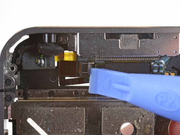

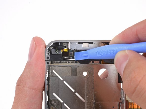

Image 1/1: Digitizer cable (pry from bottom)
  • Use the edge of a plastic opening tool to gently pry the following connectors up and out of their sockets on the logic board:
    • Digitizer cable (pry from bottom)
    • LCD cable (pry from bottom)
    • Headphone jack/volume button cable (pry from top)
    • Top Microphone/sleep button cable (pry from top)
    • Front camera cable (pry from top)
What are these types of connectors called? anyone know where to order just the connectors? or even better would be extension cables
Chris - Reply
blue, green and yellow down, orange and red up. red BEFORE orange, as part of the ribbon is UNDER red.
unklbyl
unklbyl - Reply
Windex didn't work well for me for degreasing the connections. It made the connections worse in fact. Now my digitizer AND my screen don't work.
johnpetraborg - Reply
It seems that you misunderstood the notes throughout the guide. You should only clean metal to metal contact points, such as the contact area between the EMI fingers and the metal case on the speaker enclosure. Applying Windex in connectors or sockets of any type will almost certainly destroy components in your phone.
Andrew Bookholt -
when i was replacing the logic board a small gold piece came off. It is above the top left corner of the orange box for the LCD cable. What is it for?
romaine - Reply
If you are replacing any of the cables that connect here, be sure to save the foam from the top of the connector to put on your replacement part. It helps secure the connector once the connector cover is put back during reassembly.
Blarg - Reply
When re-plugging the yellow connector (the leftmost of the 3 connectors that you disconnected from the top) put the cables behind and not before the metal part with a hole where the EMI Shield 2 clips in. Otherwise you will not be able do step 13.
Philippe Leledy - Reply
Be carefull of a very small component soldered near the yellow connector. It can pop off and make your front camera irresponsive.
Christophe De Wolf - Reply
When reassembling, the various connectors have a leading plastic lip that allows you to align and then slowly snap in place. i pushed on the pads on top of the connectors with the flat tool provided in the kit. Also, the first time, i did not press the LCD cable very well, so the phone was working, but no display showing. once i snapped this in place the second time, it worked like a charm.
hansiemys - Reply
After reassembly, when I changed to the front camera, the display got stuck in shutter mode. The website bellow suggests I lost a microscopic jumper that enables the front camera. I am guessing this happened when I disconnected the 3 connectors. The dang jumper is so small I never even noticed that I lost it. Oh well at least the rear camera still works... After replacing screen camera app now stuck on shutter?
Slobird - Reply
I ran into a not workin front camera after a screen replacement on Iphone4. I found out that I had broken the tiny jumper on the main board when I pried off the headphone plug. That jumper is next to the right upper corner of the headphone/volume button plug (yellow marked in step 17 of relacement guide), you can see it in the picture as two silvery dots. If your prying tool sits on that jumper when levelling the plug off, it is history. I took a ampoule of conducting silver liquid, but instead of shaking it I took some of the sediment out with a thin wire and aplied a tiny blob over the two remaining soldering pads left. And alas, it worked ! Front camera is ok again. Thanks to those who found out about that jumper.
dl7utx - Reply
On reassembly, be really careful when reattaching the digitizer cable - the cable breaks very easily, rendering your nice new display useless. In my case, I must not have threaded the cable through properly, so it was just a bit too short to reach the connector. I gave it a gentle tug... and snap!
I was much more careful the second time through :(
rolfsf - Reply
did you have to buy a whole new display?
same thing just happened to me:((((
mstutz12 -
Image 1/1: When reassembling the device, this standoff sets the height of the Wi-Fi shield removed in step 13.  If not torqued down, the shield will be above the plane of the frame and the back will not slide into place in step 2. The shield should be flush with the headphone jack.
  • Use a small flathead screwdriver to remove the 4.8 mm standoff near the headphone jack.
    • When reassembling the device, this standoff sets the height of the Wi-Fi shield removed in step 13. If not torqued down, the shield will be above the plane of the frame and the back will not slide into place in step 2. The shield should be flush with the headphone jack.
    • When reassembling the motherboard, ensure that its edge sits under the circled standoff, otherwise the screws will not fit.
  • When reassembling ensure that the small rubber spacer attached to the top of the motherboard is in place.
    • Without this part, the motherboard could damage the ribbon cables around it.
There is a small rectangular rubber bumper on the top of the logic board. You can see it a little at the top of the picture. I knocked mine off and had no idea where it came from! Took my wife forever searching the pictures to locate where it was from.
nickbits - Reply
Take care to put the small ruber piece into place to protect the ribon cable for the lcd dyplay
Hanspeter - Reply
The smallest screw below the Digitizer connector is held by a tiny nut which is fixed below the EMI shield. Beware because this thing can get loose easily.
mcbohdo - Reply
I believe that's the one he's referring to...
Joshua -
The screw anchor/stud came loose on me as well... How did you repair it? If you left it broke did it effect anything?
iyacyas -
Thank you Rajan for this picture. The rubber piece fell out and i was frantically trying to find its spot.
hansiemys -
Yes! Thanks for this pic! I found this little piece in the body of the phone after I removed the logic board and was stumped! Real lifesaver!
Joshua -
how do i remove the 4.8 mm stand off? ifixit instructions arent detailed enough.
Austin - Reply
I have found that the easiest way to remove these standoffs is to loosen them with a 2.0 or 2.3 mm standard (flat) blade driver bit. Then, once it is loose, you can either loosen it the rest of the way, or for better control, insert your pentalobe driver into the center of it and loosen it the rest of the way. If your pentalobe driver won't turn it, then it is not loose enough, or the end of one of the small screws has broken off in it (actually fairly common).
Best of luck to you! Just ask if you need more info!
Joshua -
When reassembling, ensure the ribbon cables for the connector are between the silver metal and the circuit board. the wifi antenna plate clips into the silver metal.
Victor - Reply

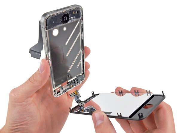

Image 1/1: Be careful not to damage the small gold prong (marked in red, near the top) as it's very fragile.
  • Carefully remove the logic board from the iPhone, minding any cables that may get caught.
    • Be careful not to damage the small gold prong (marked in red, near the top) as it's very fragile.
  • On reassembly, be careful not to trap the lower antenna cable beneath the logic board.
Note where the little rubber thing is. It's there to protect the digitizer and LCD ribbons curving over the top of the mobo. If you do these a lot, you're going to have a WTF moment when you go to put it back together and you have this short rubber strip....
jonathan - Reply
where can i buy logic board from the iPhone
jamie - Reply
be careful when putting the logic board back in: i trapped the lower antenna cable under it (see step 11). Also, it 'hooks in' at the top and rotates down; there is a notch cut into the outer case to capture the top of the motherboard.
awr - Reply
Missing rubber guard can causing touchscreen sensitivity & accuracy problem.
Otniel Yoreiza - Reply
Do not forget the rubber piece. When replacing my home button, I noticed this rubber piece fall out of the phone, and couldn't figure out where it went. I left it out, and my touchscreen had all sorts of problem. I thought I had damaged the digitizer ribbon. I even bought a new screen and had similar problems after putting that in. I finally put a makeshift piece of rubber that I cut up into the spot where this rubber piece had gone, and currently haven't had problems for over a week. This rubber piece must suppress interference problems of some kind.
dreyna - Reply
Great point! I had the logic board put back in and then found this little thing hanging out. I found a "tip" on a different site that showed it going between the rear-facing camera and the logic board! Thanks!
Joshua -
Can we get a better photo of where rubber piece goes? Mine fell off, and I have no idea where to put it back on to.
csuslog - Reply
It goes on the edge of the logic board where the Digitizer and LCD Panel ribbon cables bend over the Logic Board before they plug into it. The rubber piece protects the ribbon cables from chafing like a bumper and from interferance.
fasthans -
You can see it on the upper left of the Logic Board, just to the right of the camera in the photo for Step 18. It is easier to see if you click on the view huge link to blow up the photo.
fasthans -
Note that when re-installing the logic board, do not forget about the antenna connector near the bottom of the phone. Make sure that it does not get trapped under the logic board when you are placing the logic board in the case.
Scott - Reply
Ear piece metal connectors: You can see them on step 22. If those are not bent up enough (laying flat) you won't have contact with the logic board... and no more audio from the ear piece. This is what happened to me. I had to unmount it again to bend them and hop the ear piece worked again!
chuvux - Reply
This was a very tricky part. Just make sure that you don't put pressure on the login board to get it into place, take your time and ease it in. There will be a bit of spring in it when you push down which is a combination of the folded LCD and Digitizer Ribbon Cables and the two copper contacts underneath.
gregjames - Reply
This was absolutely the hardest part - had to do it over many times. The digitizer ribbon cable kept insisting on folding up under the logic board. Tip: do not let the cable fold up, even it that's how it naturally wants to go, it will be too short.
Julian Boilen - Reply
My small gold prong fell off, what do I do now?
Eric - Reply
Mine did too but I don't notice anything wrong yet???
C Khripin -
hi, the small gold prong (step 19) in my phone is fragile what should i do? what function from that small gold prong? thank you
Syekh Sulthan R - Reply
Image 1/1:
  • Remove the single 2.4 mm Phillips screw securing the speaker enclosure to the side of the inner frame.
Note: During assembly, do not put another screw on the left side just yet. Otherwise you would not be able to install the motherboard in the next step.
taras - Reply
step 20 speaker screw was stripped from the factory! aaaagh! took some tweaking but got it out using a little drill bit and forcing a standard screwdriver in the divot and cranking it out. the screw is absolutely necessary to reinstall too, so that was tough.
travisray - Reply
that screw is unscrewable!! I think the factory ruined the cross while assembly and no screwdriver can grab it anymore!!! arrggg... coming to this point it's already so hard.. I don't want to re assemble everything without fixing this home button!!!
supernova - Reply
Image 1/2: Before re-fastening the speaker enclosure to the inner frame, be sure the four small EMI fingers rest below the lip of the LCD frame. Image 2/2: Before reassembly, be sure to clean all metal-to-metal contact points between the EMI fingers and the internal frame as well as the brass screw mounting point with a de-greaser such as Windex. The oils on your fingers have the potential to cause wireless interference issues.
  • Remove the speaker enclosure from the iPhone.
  • Before re-fastening the speaker enclosure to the inner frame, be sure the four small EMI fingers rest below the lip of the LCD frame.
  • Before reassembly, be sure to clean all metal-to-metal contact points between the EMI fingers and the internal frame as well as the brass screw mounting point with a de-greaser such as Windex. The oils on your fingers have the potential to cause wireless interference issues.
the EMI fingers are VERY fragile...
Agreed. I broke mine off the first time I removed it.
Scott Head - Reply
Me too, are they that important, can i put it back together without them?
romaine -
'and then there were THREE' yup i broke off one as well. hint on re-assembly; put in the speaker box, and working from left to right, apply a fair amt of downward pressure and use a tiny flat-blade screwdriver to push the tip of the emi fingers toward the speaker box, go left to right so you can put in the screw on the right side when done.
awr - Reply
what happens if they break off?
bobop10 - Reply
I broke 2 of the 4 off (both on the left side) and haven't noticed any difference in the functioning of the phone.
justinstayton -
I broke off the right-most one (closest to the microphone) and after reassembly my signal strength was poor and dropped easily. I replaced the antenna/speaker unit with one from a 4s (the cable was a touch longer; but, solved with some bending) and made sure to really clean the contacts (and not break any)... long story short, intact fingers and cleaning has resulted in better signal strength than prior to the repair! go figure!
ccfoster - Reply
I agree they are very fragile! I broke off 1 EMF finger by pressing it down - wish i had read comments 1st! Phone still seems to work Ok, but gave me a scare.
Paul baskeyfield - Reply
Image 1/2: One 6 mm Phillips Image 2/2: One 1.4 mm Phillips
  • Remove the following two screws securing the vibrator to the inner frame:
    • One 6 mm Phillips
  • Remove the vibrator from the iPhone.
There is a square, metal bar that fits into a slot on the right side of the vibrator. The 1.4mm screw threads into this bar. It fell out when I first flipped it over the phone to remove the screen. Look out for that.
Andy Dittrich - Reply
On reassembly I broke the 1.4mm screw. The head fell off and the thread stood within. It worked fine attached just by the other one, but caution when fastening these 1.4mm screws.
Marcos Lima - Reply
Image 1/1:
  • Remove the 1.5 mm Phillips screw securing the front panel near the headphone jack.
When I removed the screw from here I also found a small rubber piece. It is about 8mm long and 2mm wide, and it has a channel down the centre of it. I couldn't figure out where it came from but the phone seems to be perfectly fine without it. I thought it could possibly be some sort of anti-vibration damper for the vibrator although I am not sure. I couldn't see it in any of the pictures.
The Talent - Reply
You can find ist on picture step 20 - right down under the red circle, between frame an speakerbox
Thorsten - Reply
The rubber piece Thorsten is describing is a different one, smaller than the one The Talent is mentioning. The one with the channel down the centre of it, I dont know where it goes.
computer - Reply
hi,
what do i do if i have lost that screw i droped it and now i cant find it does it matter if i dont put it in?
jett - Reply
Referring to the exact screw that is circled in red, I cannot seem to get this particular screw to thread properly during the reassemble process. I have found that I had to add another 15-20 min to my assembly/dis-assembly due to the fact I have to remove the earphone jack and the antenna that is in this corner, too. Any suggestions on how to get this screw to thread w/o doing the extra steps? Need of help, Please
aggiphixit - Reply

Image 1/1: Keep track of the washers under each of the screws.
  • Remove the three large-headed 1.5 mm Phillips screws along the SIM card side of the iPhone.
  • Keep track of the washers under each of the screws.
  • Tip: It can be tricky, but it is also possible to just loosen the large-headed 1.5 mm Phillips screws slightly, without having to remove and replace the screw-and-washer set.
  • Remove the small-headed 1.5 mm Phillips screw near the rear camera (previously removed).
I just loosened them and it worked fine!
Leigh Ellis - Reply
Yep, absolutely. And you will save a great amount of time. :)
Titelive -
Removing the washer and screw is easy, but getting them back on is extremely hard unless you have midget fingers. The magnetic driver really doesn't help, just keeps dislodging the washer in its place when attempting to to reinsert screw. Using a non magnetic Phillips 0.
Chris - Reply
I cannot get the flat headed screws out for the life of me - I've been trying for about half an hour! any tips?
kxthleen - Reply
Same problem
gelmi -
No matter how hard I try, I cannot get these screws out! I had the same problem on the other side (step 24) as well. My screen has previously been replaced by a 'trained professional' but they have stripped all of the large flat-headed screws, making it impossible for me to get them out!
In need of serious help/advice/techniques for getting these God-forsaken screws out!!!!
Becca H - Reply
Did you find a solution? Same problem
gelmi -
Use a thin rubber-band between the screw and the screwdriver to compensate for the lack of grip for the screwdriver
Joe Is -
i couldn't get all the large headed screws out, two where stuck. So i gently removed all the other screws in the following steps, and pulled the front cover gently out by moving gently and breaking some parts of the front screen (which i throw away anyway) After that the remaining screws became looser, and were able to screw up and down.
nickzielinski - Reply
anobody please tell me which one screwdriver i should use to loose the flat-headed screws?
aiman Danial - Reply
The tools are listed at the top of the guide, all of the Phillips screws in the guide are the same #000 size listed there.
Sam Lionheart -

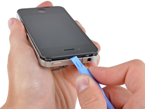

Image 1/2: Do not attempt to insert the tool between the glass and the rubber bezel. Image 2/2: Carefully pry the upper edge of the front panel assembly away from the steel inner frame.
  • Carefully insert the edge of an iPod opening tool between the rubber bezel around the front glass panel and the steel inner frame.
  • Do not attempt to insert the tool between the glass and the rubber bezel.
  • Carefully pry the upper edge of the front panel assembly away from the steel inner frame.
A small approx 8mm by 3mm by 1mm black piece of rubber fell out of the phone when I turned it over. Any idea where it's from? Thanks.
Courtney - Reply
happened to me too.. did you ever hear anything from anyone else?
sgoodwin -
If it's square then it could be the piece that sits next to the dock connector on top of the little black speaker? Do you have a photo of it?
Dan Simon - Reply
This is the photo:
http://imageshack.us/photo/my-images/543...
Any idea where this goes?
Rajan -
Found it. It's clearly mentioned in step 18.
http://img442.imageshack.us/img442/835/i...
Rajan -
Great guide. When you are prying the glass screen off be extremely careful not to lift the top of the too high. If you do lift it too high then the glass at the bottom of the phone will easily crack.
jeffchambers - Reply
My glass refuses to budge ! I broke two ipod tools trying to get the glass off ! Reassembling phone, will try again some other time... There has to be an easier way to get the glass off...
Demetre - Reply
If you use a hair dryer to soften the glue, it seems to do the trick. Just dont hold too close to melt anything. Did this with an Atrix a few times.
Jim - Reply
Definitely use a hairdryer to loosen the glue below the power button to get the spudger started.
BradfordB - Reply
Since my screen was shattered, let's face it which is the main reason to replace the screen, it completely came apart around the button. Use of a hair dryer would have been a useful tip, however I don't blow dry my hair and so don't have one. A warm towel just doesn't cut it.
I just need it to work for a few more months until the iPhone 6 comes out.
zeristor - Reply
The square piece your are referring to is the rubber piece that fits on the logic board. It seats on the logic board between the orange circled screw and the green circled screw in step 13. To date, I had one fall off during my third IPhone 4 screen repair. Needles to say, I had to part the entire phone out due to one stripped screw in the corner that was holding on the bracket to the screen. Luckily the screen and LCD was already missing and all that was left was the backlight.
aggiphixit - Reply
Image 1/2: Continue to rotate the front panel assembly away from the steel inner frame until it slowly begins to peel off the adhesive applied below the home button area. Image 2/2: It may be easiest to insert a spudger at the top and work it around the edges, spreading gently as you go.
  • Slowly and gently lift the top edge of the front panel assembly away from the steel inner frame.
  • Continue to rotate the front panel assembly away from the steel inner frame until it slowly begins to peel off the adhesive applied below the home button area.
    • It may be easiest to insert a spudger at the top and work it around the edges, spreading gently as you go.
  • Carefully pull the lower edge of the front panel assembly away from the steel inner frame.
  • Be careful, if the home button sticks to the front panel you may tear the home button cable.
  • Do not flip the front glass completely away from the frame. Doing so may result In damage to the digitizer cable.
  • If the glass is cracked (which it probably is since you're replacing it) removing the panel is likely to cause it to bend, kicking off small shards of glass. Before you do this step, cover the front with clear tape, then perform the actual removal over a trash can. Protective eyewear would also be prudent.
Be very, very careful when removing a broken screen. My experience was that while most of the broken screen came off, there were many smaller pieces which were stuck to the area around the home button as well as the camera lens. I took my time and used narrow-headed tweezers to remove countless shards of glass. Likewise, I found what I think was an adhesive membrane which I think was supposed to come off with the front screen but remained stuck to the frame. After some head-scratching on my part, I removed the adhesive membrane (tape) and hoped I wasn't removing something important. Thankfully, once reassembled, the phone worked fine!
ellamama - Reply
I have used clear tape placing it on the screen so that the shards of glass will stay in one piece. This worked out for me hopefully someone will try it.
aggiphixit - Reply
Image 1/3: When reinstalling the display, carefully straighten the digitizer and LCD data cables, and feed them through the slot cut in the steel frame. [https://d3nevzfk7ii3be.cloudfront.net/igi/pOnFkdECiyCBgkjU|This photo|new_window=true] shows the display assembly being installed '''incorrectly''', with a fold in the digitizer cable. Image 2/3: When the front panel has been correctly installed, both the LCD and digitizer cables should be immediately next to one another and should be the same length, as shown in the second photo. Image 3/3: If the digitizer cable has not been installed correctly, it will not reach its socket on the logic board. '''Do not''' attempt to pull it through by force, or it will tear. Remove the display assembly, straighten the cable, and feed it through to its full length, as shown.
  • De-route the digitizer and LCD cables through the steel inner frame, and remove the display from the iPhone.
  • When reinstalling the display, carefully straighten the digitizer and LCD data cables, and feed them through the slot cut in the steel frame. This photo shows the display assembly being installed incorrectly, with a fold in the digitizer cable.
    • When the front panel has been correctly installed, both the LCD and digitizer cables should be immediately next to one another and should be the same length, as shown in the second photo.
    • If the digitizer cable has not been installed correctly, it will not reach its socket on the logic board. Do not attempt to pull it through by force, or it will tear. Remove the display assembly, straighten the cable, and feed it through to its full length, as shown.
  • During reassembly, do not touch the metallic area at the base of the LCD data cable, as this can cause problems with the LCD. If you do touch it accidentally, clean it gently with an alcohol wipe before continuing.
It is indeed easy to pinch the digitizer cable in particular between the top of the glass and the metal backing underneath. Be careful.
jonathan - Reply
one of the cables has a fold or something making it 'double' so there are really THREE cables that must be fed through the hole (one just doesn't go anywhere). I used a tiny tweezer to aid with re-routing the cables and it was FAR easier.
awr - Reply
If you do have to replace the Camera Ring, I find it much easier to put some double sided 3m on the Display where the ring would go, then put the ring ON the camera, not the display. Also if you need to replace the camera ring, your prob gonna have to replace the ear screen, its easier in the long run just to replace it. Please do not glue either piece on.
Mark - Reply
Sounds dumb but make sure you remove the (usually blue) protective sheet from the mirror surface on the interior of the new display. I didn't and I had to redo the whole process!
Colin - Reply
CAUTION! When rerouting the LCD and Digitizer cables, DO NOT PULL ON THEM! I tried to re situate the Digitizer cable in order to mount onto the speaker enclosure, which broke the digitizer right off.
Henry - Reply
This is the only part that was a little tricky for me. When I was reinstalling the LCD panel it took me a few tries to get the connectors and cables through the holes correctly, and not pinched by the frame. Take it slow and be gentle.
jefferydunn - Reply
My bf claims I have to replace the LCD if I take it off. Is that true?
Crystal - Reply
This part was very tricky because you need to make sure you have enough slack from the LCD and Digitizer cables. Take your time to make sure that the cables are fully through, even the slightest pinch will be enough for this to not reach and you have to redo it again (a massive pain if you've already started the reassembly. - A good way to test this is to before you reassemble try placing the logic board on top where the LCD and Digitizer cables will fit into, if they reach fine then you are good, if not then adjust the cables again until you know they are through completely, this saves you having to disassemble again if its not correct. - Good Luck and Take your time!
gregjames - Reply
It's easy to get the digitizer cable caught and sandwiched when reassembling, make sure you carefully feed it through. I got everything almost assembled and then the digitizer ribbon cable wouldn't reach the connector! I was stuck for 45 mins till I figured it out.
Slawek - Reply
Had to back track to this step as the feed through got folded a bit and I couldn't clamp down one of the digitizer cables..... all in all a fantastic tutorial.
Thanks!
kaykills - Reply
I had the same problem and the issue is that ribbon cable gets squared off towards the bottom and has to be fed into the slot more carefully.
Great guide and great parts offering. Thing 4's ancient iPhone 4 is back in business until I hand him down my 5 when I get the next iPhone this fall.
larryleonard -
For some reason when I put the phone back together the screen is dark on the upper left corner. The touch sensitivity works perfectly and the button replacement went well.
subzerodeath - Reply
I received a dodgy digitiser - even when i took the screen off again the cables were not the right length.
alex - Reply
I thought I had the same problem, but I removed the screen again and found that the thinner cable had folded under itself. At every motion of re-installing the screen, I had to hold those dang cables taught to keep them from folding under again! Ugh. The thin one had a fold in it, but it still worked.
robin -
I ripped the LCD cable pulling it too hard, is it fixable?
Andy - Reply
At this point make sure that you don't have any broken glass left on the phone. I had, and the screen wouldn't go all the way down.
Sebastian - Reply
CHECK AND DOUBLE CHECK THE RIBBON CABLES BEFORE YOU PUSH IT DOWN! It really is very easy to mess the whole thing up here...I did! Even when you think you've got both cable through, check from the side, there's a little square bit that catches. If you damage the ribbon at all it's time to buy a new screen and learn from your mistakes.
andiskin - Reply
Im at the steap where you have to put the lcd screen and the frame together but at the beginning of this steap removing it! 2 small pieces felt off and I can't find where they belong any one
Sinuhe Nolazco - Reply
Don't forget to change the adhesive strips if they're dirty or not enough sticky or your screen will break more easily. :(
Titelive - Reply
Does both cables (digitizer and screen) go through the same route (hole)? I did not pay attention while opening the phone and now passed them through the same area. Now the digitizer cable does not reach the board! What should I do?
Aref - Reply
Image 1/3: Be sure you are prying up on the cable retainer, '''not''' the socket itself. Image 2/3: Be sure you are prying up on the cable retainer, '''not''' the socket itself. Image 3/3: Be sure you are prying up on the cable retainer, '''not''' the socket itself.
  • Use the edge of an iPod opening tool or your fingernail to lift the home button ribbon cable retainer.
  • Be sure you are prying up on the cable retainer, not the socket itself.
Take a look at step 31. it shows him prising off the socket with the tool. why? Your not meant to do that, and I broke my iPhone following this. all you have to do is disconnect the ribbon. you don't lift anything up!
oranjj - Reply
Hi oranjj, I did the same :-( can you do anything about it? Did you get yours fixed?
leroy978 -
The picture is right. There is a very very tiny tab that needs to be lifted, so the socket releases the flex cable. It's barely noticeable but it's there. After replacing the home button you connect the new flex cable and then you lower the socket tab again to secure it. I'm sorry you broke yours :-/
pic10F206 -
@oranjj actually you should lift up the small plastic retainer flap which locks the ribbon in or you won't be able to lock the new one in, the warning does explain you don't lift the whole thing
Leigh Ellis - Reply
This step is really tricky. I broke the connector accidentally.
Meng - Reply
this step is the most difficult part of the entire process. a closeup photo or two of how this connector works would be very useful. i nearly destroyed mine too!
garymohr001 - Reply
Nearly broke the connector too, although this was down to me not reading the step thoroughly. Was very tricky working that ribbon cable back in there, but all back together now and touch wood seems to be working fine! Thanks : )
Marc - Reply
My home button had gone really bad and had to be pushed hard so I installed a complete new button w/socket cable.
I followed the guide and lifted the ribbon retainer before removing/inserting the ribbons.
Now there's no functionality at all?! .. :(
Any ideas?
stroelsen - Reply
me too! did you ever hear back from anyone?
sgoodwin -
It is a ZIF type connector. Careful!!
similar to this: www.youtube.com/watch?v=AqalgC6zbHw
travisray - Reply
I really don't understand how to put the home button back. I finally was able to get the old homebotton with cable out...though I am affraid I broke something.
Getting the new one is, is a pain in the $#$ and does not keeps in position. Is there a way to obtain a new socket? Or are there other posibilities?

I have the same problem. Getting the cable out was no problem, but getting it in again does not work. I think my socket is okay but I cannot connect the button again... The cable still does not get in... :-/
Christian -
Hi! I actually broke the connector... took it out from the iPhone.
Can I just glue it back? Will it work?
My iphone doesnt want to reset... it asks for restore mode all the time
Alex - Reply
Putting the new home cable in the socket was impossible. After pushing and wriggling for half an hour on the old cable to see how to get it back in, I gave up, put the new one in as far as possible, put the clip down and put the phone back together in the hope that it was I'm far enough. Turns out, it was!
Reversing instructions is not that simple. Some photos or more notes on how things go back would be great.
That said, I am so grateful these guides exist. Thank you!
Fiona Palmer - Reply
Well, I too separated the "socket itself" because I thought it was a pushdown connector instead of sizeways ZIF. First attempt to put it back in place with superglue ended in a non-working home button (although the phone was still usable via Settings/General/Accessability/AssistiveTouch).
In my second attempt I removed the suplerglue and, with a fine soldering iron, very carefully, reconnected the socket in place by soldering the two back leads and (perhaps) one or two of the front leads. And now it works! Just afraid that if I drop the phone the hole thing will come apart, but for the moment I remain a happy camper.
Very many thanks for the guide, but please add a statement in Step 31 about the ribbon cable having to slide out of the socket horizontally, since the pictures are misleading.
jnavarro - Reply
Putting the cable back into the connector is not easy. I broke the cable off the *old* button and played around to see how it all worked before attempting to fit the new one. I would recommend doing this as a few dummy runs of plugging them together makes it clear. Important to remember, the tiny, almost invisible, clip on the socket is up open, down locked.
If you have a lit magnifying glass, use it.
Victor - Reply
Is there any way to repair the socket if I accidentally removed the whole thing instead of just the cable???
kevinmorris - Reply
Did anyone find a solution for braking the connector off?
Gallai Kamilla - Reply
Image 1/1: Do not excessively strain the home button ribbon cable, as it is very thin and delicate. Also, be careful with the two small electronic parts on the ribbon cable. It is very easy to damage them with tweezers.
  • Use a pair of tweezers to pull the home button ribbon cable out of its socket.
  • Do not excessively strain the home button ribbon cable, as it is very thin and delicate. Also, be careful with the two small electronic parts on the ribbon cable. It is very easy to damage them with tweezers.
The guide did not specify which part of the home button ribbon cable to squeeze when installing it, so the moment I tried to put in the new home button, I used my tweezers to squeeze the flat part of the home button ribbon—which was a terrible mistake, because on the other side of the ribbon were the two small transistors (or whatever) that I demolished instantly. As a result, I had to clean and reinstall my old button. :(
mig81 - Reply
The directions are not very clear on the "direction" the cable connects. Does it lift off? Does it pull off? Does it pull out? The answer is it pulls out to the right as shown in the picture. I discovered this only after I had damaged the two little copper wires (thick as a human hair) and now have to toss the fone as they are part of the underlying electronics. This is an extremely frangible connection. Be VERY careful pulling this guy out.
inettransactions - Reply
An oblique photo would REALLY help show just exactly where the tab is supposed to go. I opened the high-res photo provided here and zoomed in on it, then looked at my phone at an oblique angle to find the slim little slot for the tab.
robin - Reply
Image 1/1: When installing a new part, there may be a protective plastic film on the home button. It can be removed with a spudger or your fingernail.
  • De-route the home button ribbon cable through the inner case and remove the home button from the iPhone.
  • When installing a new part, there may be a protective plastic film on the home button. It can be removed with a spudger or your fingernail.
Thank you. I have a full light grey area on the right screen side (same position as the logic board). What could it be? Please Help.

doesnt work "iPhone 4 Home Button Assembly Black". I remowed the tape from the button, the button is too low. it doesnt work. wrong part maybe? dont buy stuff from this shop!
lauri - Reply
How can I tell if there's a thin layer of plastic on the new part? Is it covering the silver connector?
motionpotion - Reply
I'm also confused about the plastic film. I removed the plastic film from the back of my new home button and the silver disk came off with it - the disk is not glued on to the home button. When I put the new button in place I tried as best I could to keep the disk in the same position it was in before I took the plastic off.
The new home button works OK (I only have to press 2x for it to respond) but it doesn't move at all when I press it.
Should I have left the plastic on? Is the little silver disk necessary? should i have glued the silver disk back on to the home button?
I want to go back and re-do it, but not until I have a better understanding of what to do.
sctuck - Reply
Is there any answer to the plastic film question?? Everything was so thorough till the end. Now I'm at step 33 with my phone 100% disassembled and not sure if the film that holds the silver disc should stay or go!!
dannybelisle - Reply

Everything looks fine after 31+31 steps and 4 hours. Pay attention on reassembly step 30, make sure that all cabes are in the correct position before steps 29 and 28.
Flavio Furlan - Reply

When removing the display assembly, try to slide the ipod opening tool to find a gap. It took me a while before I could detach the display from the body.
yibindeng29 - Reply

This is a great guide, thanks. Although this repair is not for the faint of heart (or unsteady of hand), with some perseverance, I was able to complete it successfully. My only suggestion is that you include some kind of warning that the home button ribbon cable retainer tab is _very_ fragile. It's also not completely clear from the pictures how the ribbon cable is affixed to the connector (the tongue of the ribbon cable slides under the connector). A tighter close up of the entire assembly, or perhaps an animated gif illustrating that part might be helpful.
Mushfeq Khan - Reply
I completely agree, how the home button connects to the board is the only really confusing part. Excellent guide though and now my phone works again.....
Darren Cowasaki -
The clip popped off when I inserted the ribbon, but after losing it 4 times and 1 hour or more of futzing around I somehow managed to get it back in place. I sure hope it works.
Could have really used a close up picture or illustration with this step.
Dwayne Clare -
