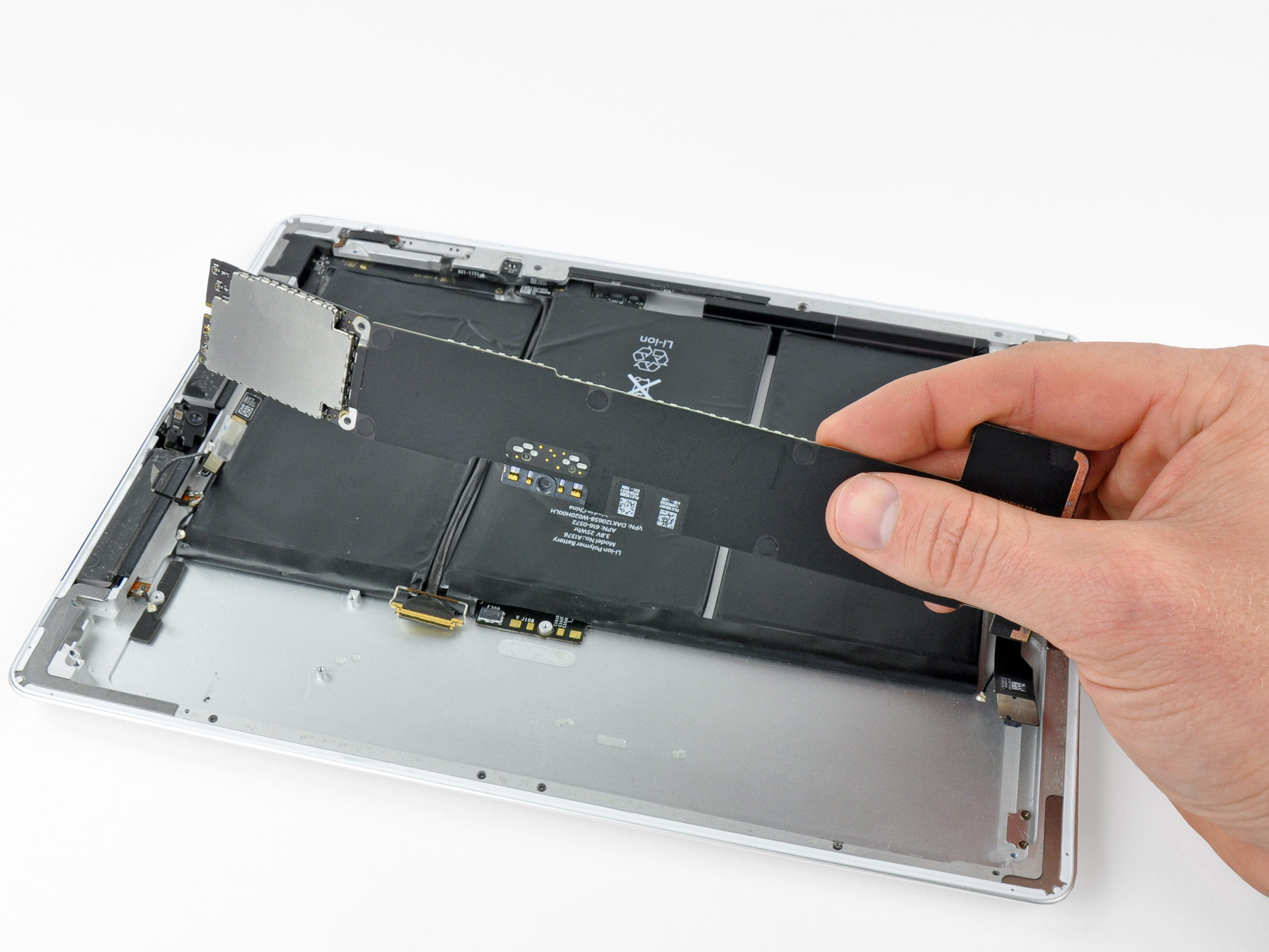

iPad 2 CDMA Logic Board Replacement

  28. iPad 2 CDMA Logic Board Replacement, LCD: step 28, image 1 of 1
    • Remove the four 2.0 mm Phillips #0 screws securing the LCD to the rear case.
  29. iPad 2 CDMA Logic Board Replacement: step 29, image 1 of 2 iPad 2 CDMA Logic Board Replacement: step 29, image 2 of 2
    • The front panel ribbon cables are connected beneath the LCD. To access them, you'll need to temporarily flip the LCD over and out of the way.
    • Be very careful when moving the LCD, and do not attempt to remove it from the iPad—its display data cable will remain connected while it is rotated over.
    • Lift the LCD from its long edge closest to the volume buttons and gently flip it out of the rear case—like turning the page in a book.
    • Set the LCD face down on the front panel.

    • Remove the logic board from the iPad 2.
To reassemble your device, follow these directions in reverse and use our iPad 2 CDMA Front Panel Adhesive strip guide to reattach the front panel.
