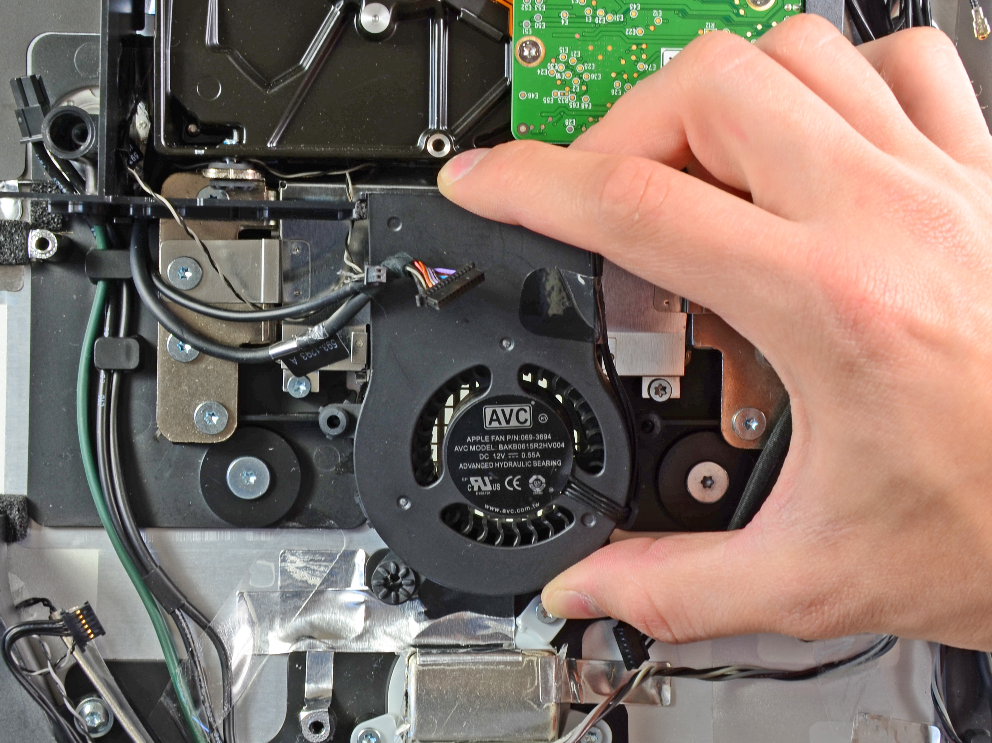

Use this guide to replace a burned-out hard drive fan.

Remove the single 13 mm T10 Torx screw securing the hard drive fan to the outer case.

Thanks, my iMac is dead silent now !! Couldn’t do that whiteout this great guide.
