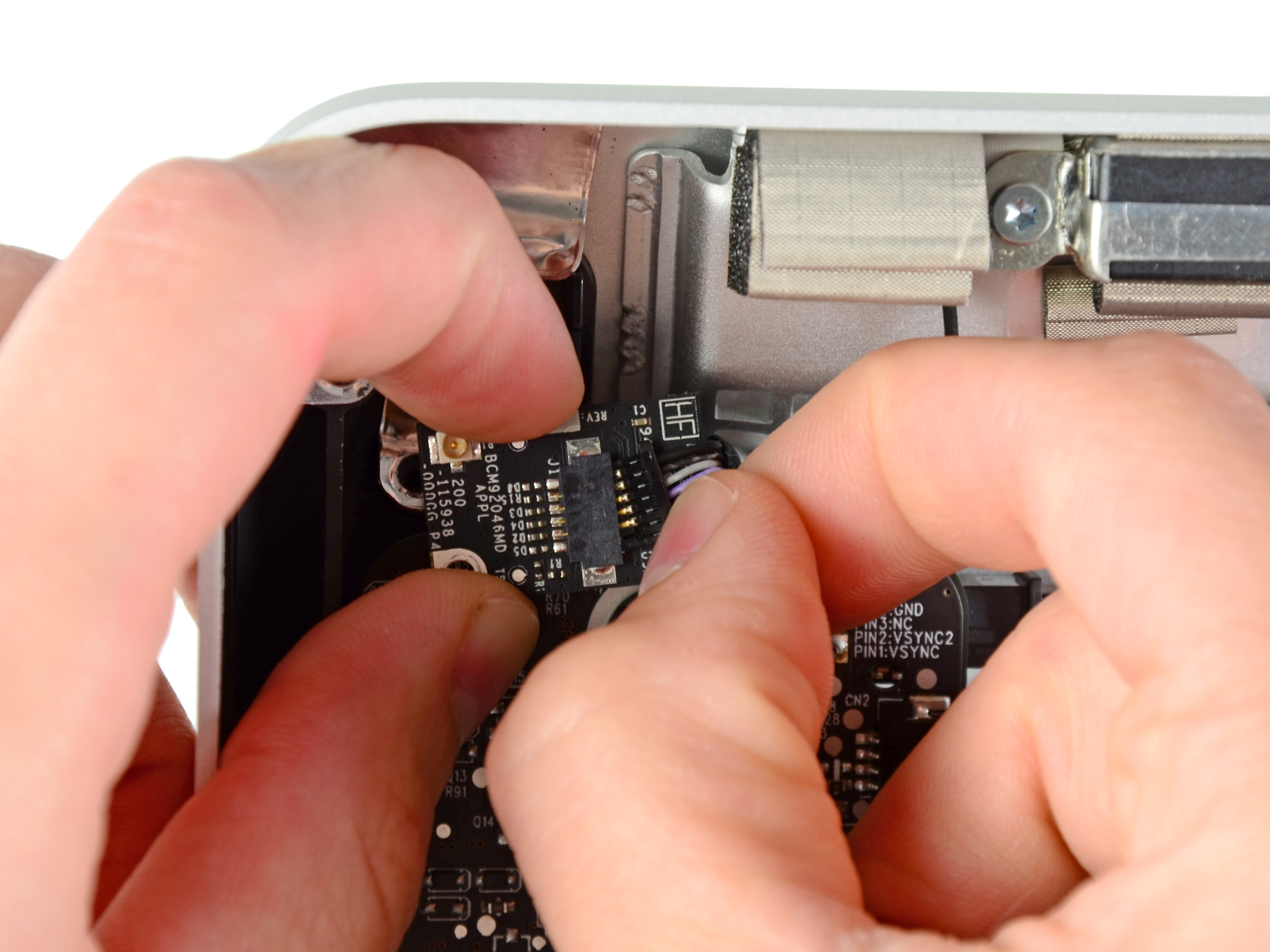

  10. iMac Intel 21.5" EMC 2428 Bluetooth Board Replacement, Bluetooth Board: step 10, image 1 of 1
    • Use the flat end of a spudger to pry the Bluetooth antenna cable connector up from its socket on the Bluetooth board.
  11. iMac Intel 21.5" EMC 2428 Bluetooth Board Replacement: step 11, image 1 of 1
    • Remove the single 6.6 mm T8 Torx screw securing the Bluetooth board to the outer case.
  12. iMac Intel 21.5" EMC 2428 Bluetooth Board Replacement: step 12, image 1 of 1
    • Remove the piece of tape wrapped around the Bluetooth board.
  13. iMac Intel 21.5" EMC 2428 Bluetooth Board Replacement: step 13, image 1 of 1
    • Disconnect the Bluetooth cable by pulling its connector away from the socket on the Bluetooth board.
    • Remove the Bluetooth board from your iMac.

Seriously this is so incomplete! What about the cable that connects the Bluetooth to the logic board!?!??? Like this is so half way explanatory!
mamashannon4u - Reply
it is much easier to replace the bluetooth board if you first remove the glass panel, then remove the 8 screws from the display and carefully lift it about 7-8cm without detaching the cables. With the top of the iMac facing towards you, fix the position of the display with something like a thick book and you should be able to remove and replace the bluetooth board easily.
michael walsdorff - Reply
