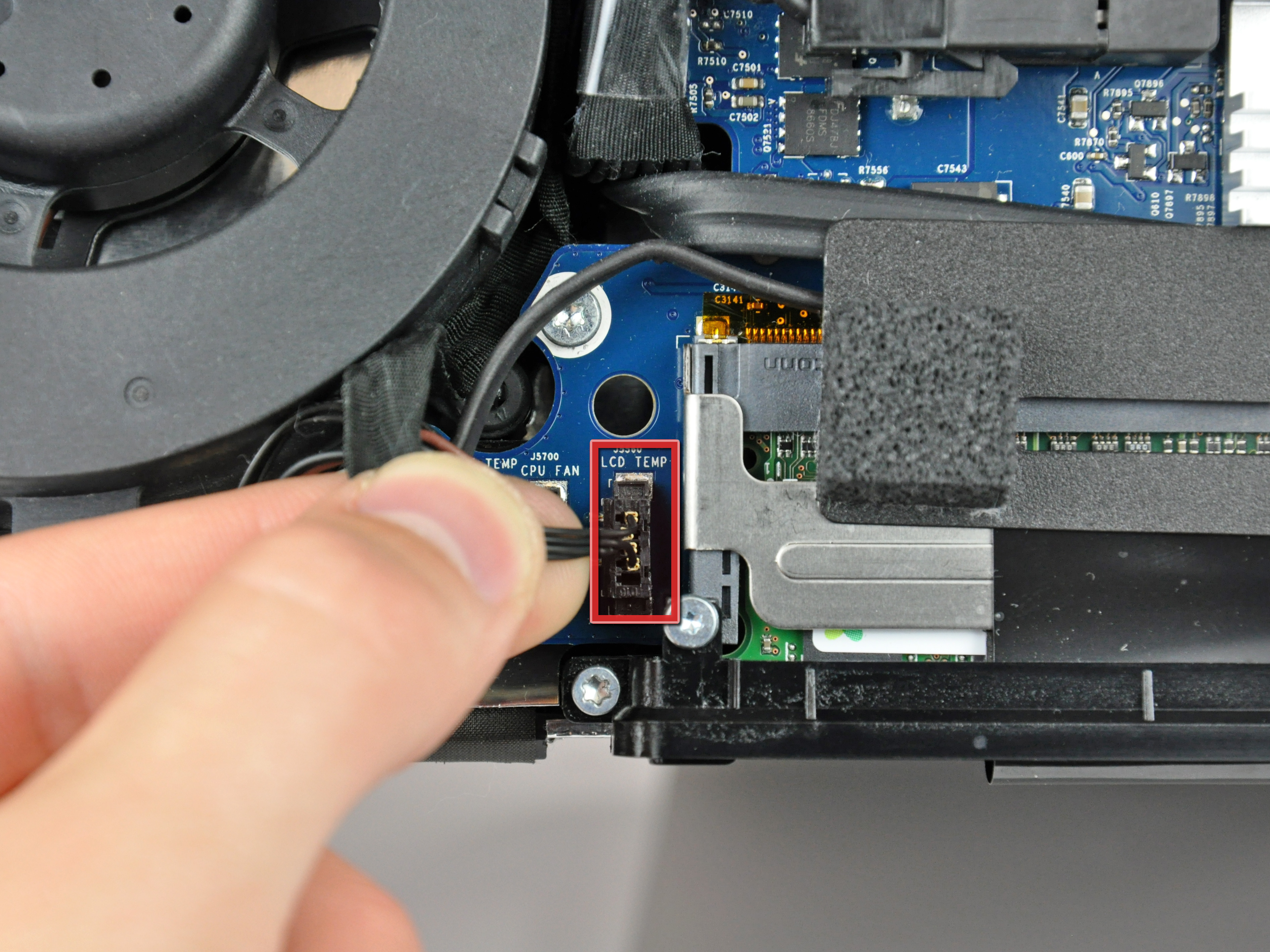

    • Pull the LCD temperature sensor connector straight up out of its socket on the logic board.
    • If necessary, de-route the LCD temperature sensor cable from behind the logic board.
    • When you remove the LCD, check the routing of the LCD temperature display cable. On reinstalling the display, be sure this cable does not block one of the bottom screws for the front bezel.
