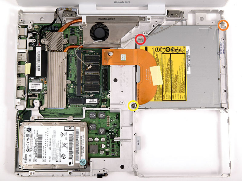

Remove the following 11 screws from the bottom of the computer:
  • Remove the following 11 screws from the bottom of the computer:
    • Three 3 mm Phillips around the battery compartment. (Some models may only have two screws.)
    • Three 4.5 mm Phillips along the optical drive bezel. (a magnetic screwdriver may help to lift these screws out)
    • One 11 mm Phillips in the lower right corner. (if present)
    • Four 14.5 mm Phillips.
The middle screw along the optical drive got sucked sideways into an opening by something magnetic and proved impossible to get out with a bit of blutack on the end of a screwdriver. In the end turning it over and giving it a smart tap worked.
tatterjack - Reply
- the 3 red screws located around the battery compartment are absent. (I never opened my
G4 before).
- the 3 orange screws along the optical drive bezel are deep located and I can't see where to
place the screwdriver. By trying I run the risk to damage the screw head.
su40 - Reply
I realized that there are no screws 3 red and3 orange, the are only 4 green ones and a yellow one.
su40 - Reply

Remove the following 3 screws:
  • Remove the following 3 screws:
    • One 3 mm Phillips in the channel between the optical drive and fan.
    • One 6 mm Phillips from the upper end of the drive bezel.
    • One 6 mm Phillips with a collar from bracket extending from the lower left corner of the drive.
There are two different styles of optical drive ribbon. If the cable extending from the optical drive is white, skip this step. If the cable is orange, then complete this step and skip the next two steps.
  • There are two different styles of optical drive ribbon. If the cable extending from the optical drive is white, skip this step. If the cable is orange, then complete this step and skip the next two steps.
  • Disconnect the orange optical drive ribbon from the logic board.
