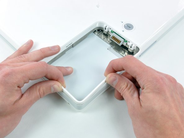

Breathe deeply. Trying times are ahead, but we promise the lower case does come off.
  • Breathe deeply. Trying times are ahead, but we promise the lower case does come off.
  • Push the thin rims of the lower case surrounding the battery compartment in, bending them past the tabs, and then lift up to free that corner of the lower case.
When I did this, it helped to start around the disc drive
kleitscs - Reply
I find that a stiff nylon guitar pick will work if you don't have a spudger.
discodamon - Reply
I didn't find this step difficult at all. I have very short nails. I imagine a woman with long nails might have a problem grasping the rim and pulling up.
syl57 - Reply
Definitely read the rest of the instructions now. I struggled at first... I was using my ipad with the step by step instructions and didnt scroll down past this photo, so I didnt see the sequence of how to loosen the tabs. in fact I didn't know where the tabs might be... Only discovered that part when I reassembled it. The spudger didn't work for me. Too soft, I used mostly a thin very small screwdriver.
manyanelson - Reply

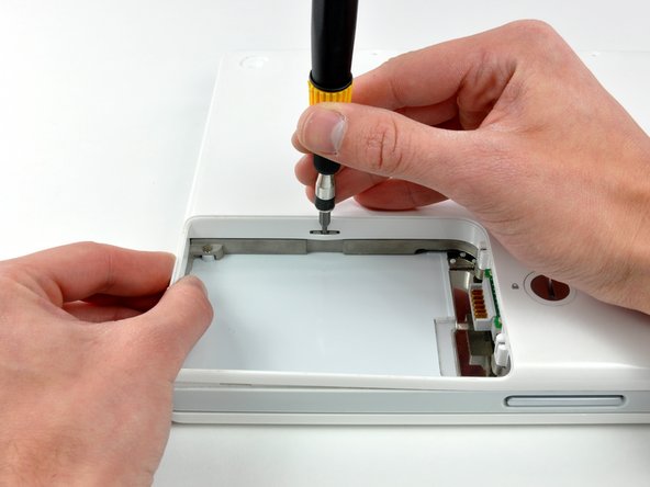

There is a slot on the wall of the battery compartment that locks the lower case in place. Use a small flathead screwdriver to pry out the slot's lower rim and pull up on the lower case to free the slot from the tabs holding it.
  • There is a slot on the wall of the battery compartment that locks the lower case in place. Use a small flathead screwdriver to pry out the slot's lower rim and pull up on the lower case to free the slot from the tabs holding it.

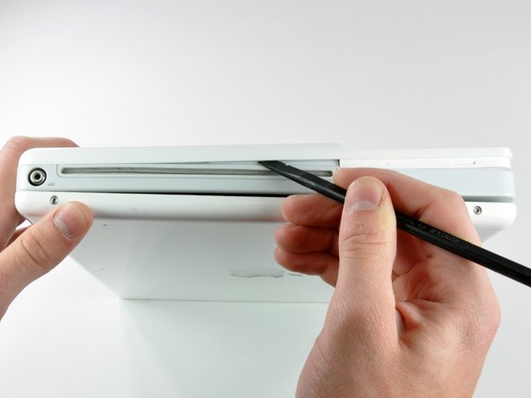

Run a spudger along the seam between the lower case and upper case on the front of the computer to free the tabs locking the lower case. Pull up on the lower case and continue to use the spudger as necessary until you hear three distinct clicks.
  • Run a spudger along the seam between the lower case and upper case on the front of the computer to free the tabs locking the lower case. Pull up on the lower case and continue to use the spudger as necessary until you hear three distinct clicks.
Steps 7-9 were effortless for me.
syl57 - Reply
Continue to run the spudger around the front right corner. There are two tabs on the port side of the computer, one near the front corner and one near the sound-out port.
  • Continue to run the spudger around the front right corner. There are two tabs on the port side of the computer, one near the front corner and one near the sound-out port.
There are three tabs over the optical drive that must be released before the lower case can come off. Slide the spudger into the lower case above the optical drive and run it toward the back of the computer until you hear three distinct clicks.
  • There are three tabs over the optical drive that must be released before the lower case can come off. Slide the spudger into the lower case above the optical drive and run it toward the back of the computer until you hear three distinct clicks.
try using the spudger at the back near the vents. To be specific, on the left side of the hinge when faced upside-down. It's easier this way and it's described on Apple's official repair manual.
Jinhan Liu - Reply
then put a library card or something between the outer enclosure and the optical drive enclosure then pull from the other side to free the casing
Jinhan Liu - Reply

Remove the small greasy springs with white plastic caps from either side of the battery contacts.
  • Remove the small greasy springs with white plastic caps from either side of the battery contacts.
  • Have patience and follow the directions, the end result is up to you. In my case it worked. But I was a Technician TRW Automotive. and worked on Air Bag modules that was returned from customer's that needed them analyzed. I just retired after 26 years.

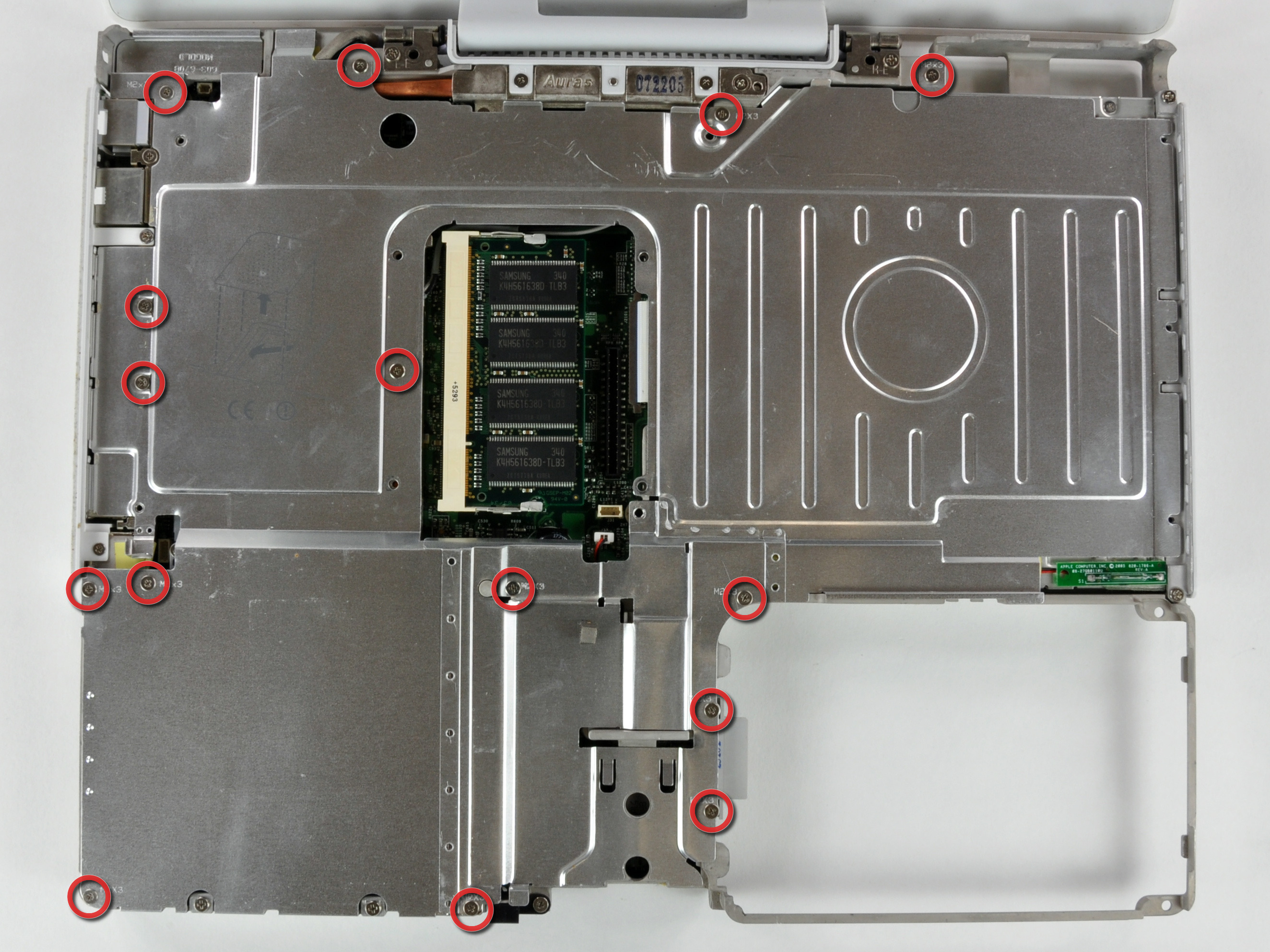

Remove the two 3 mm Phillips screws inside the left edge of the battery tray.
  • Remove the two 3 mm Phillips screws inside the left edge of the battery tray.
    • Three 3 mm Phillips around the battery compartment.
    • Three 4.5 mm Phillips along the optical drive bezel. (a magnetic screwdriver may help to lift these screws out)
    • One 12 mm Phillips in the lower right corner.
    • Four 14.5 mm Phillips.
The first two screws in this step are legit. The next eleven do not exist.

Remove the fifteen 3 mm Phillips screws securing the top shield to the computer.
  • Remove the fifteen 3 mm Phillips screws securing the top shield to the computer.
  • Remove the following 16 screws:
    • Thirteen 3 mm Phillips.
    • One 3 mm Phillips. (actual screw not present in image)
    • Two 4 mm Phillips.
  • Be sure to fit the screw near the left hinge through the loop in the display data cable, securing the cable to the upper case.
Variant:
Upper-left corner is M2.5 x 5.5mm screw.
apenzott - Reply
Lift the top shield up from the right side, minding the upper left corner, which may catch on the metal framework.
  • Lift the top shield up from the right side, minding the upper left corner, which may catch on the metal framework.
