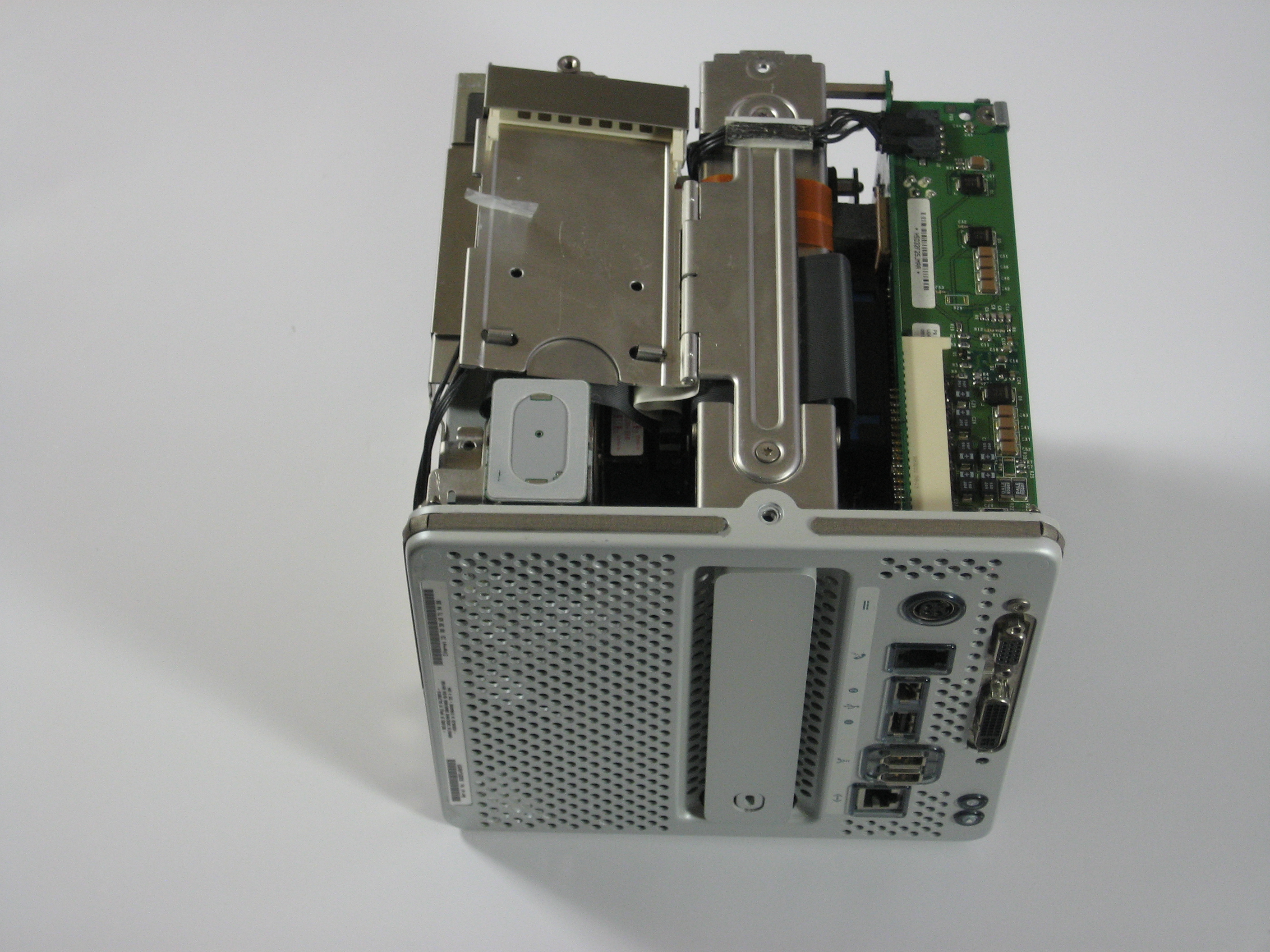

  1. Power Mac G4 Cube Airport Card Replacement, Remove Cube Core: step 1, image 1 of 3 Power Mac G4 Cube Airport Card Replacement, Remove Cube Core: step 1, image 2 of 3 Power Mac G4 Cube Airport Card Replacement, Remove Cube Core: step 1, image 3 of 3
    • Release the handle at the bottom of the Power Mac G4 Cube by pushing it down. Slowly pull out the cube by holding the end of the handle.
    • Watch for any parts that may become entangled with the outer case.
    • Push back the handle after you have taken the core out of the case.

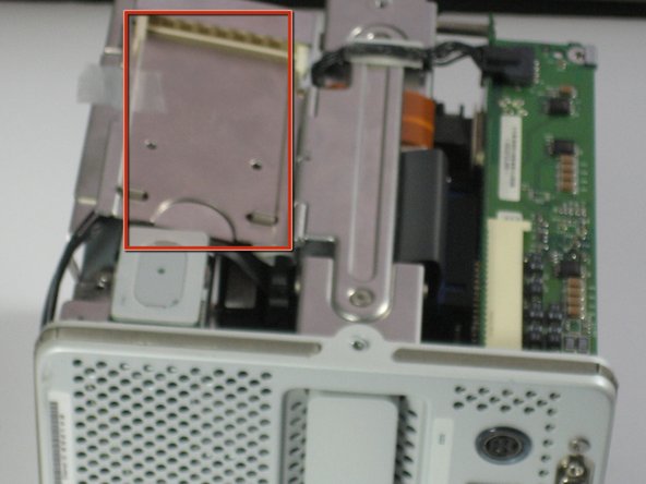

  2. Power Mac G4 Cube Airport Card Replacement, Accessing AirPort Card: step 2, image 1 of 2 Power Mac G4 Cube Airport Card Replacement, Accessing AirPort Card: step 2, image 2 of 2
    • Pull outwards on the antenna cable.
    • The cable should pop out of the card without much force.
    • Pull on the clear tab outwards to remove the existing AirPort card
    • Slide in the new AirPort card.
    • Reconnect the antenna cable.
