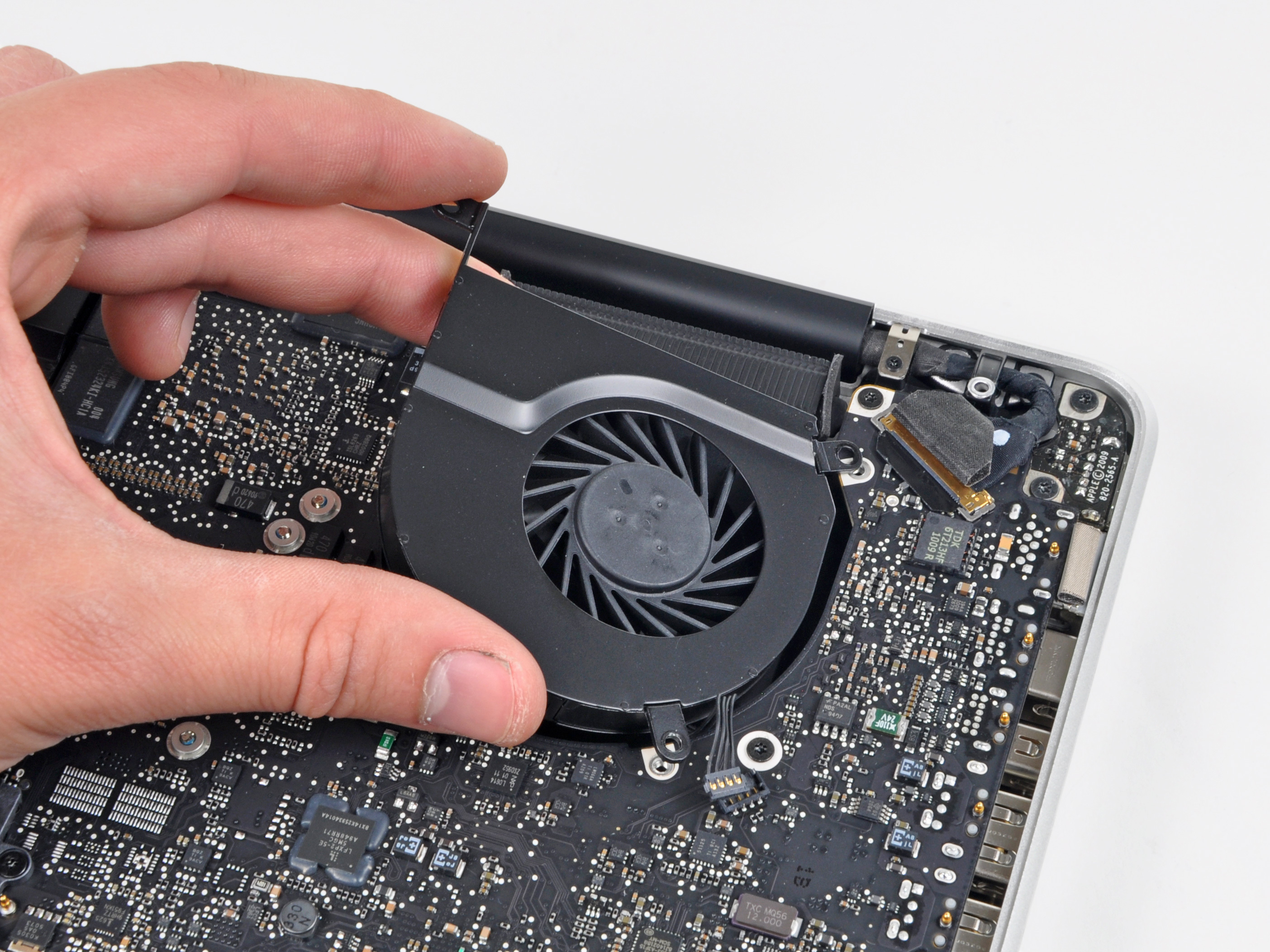

Remove the three 3.4 mm T6 Torx screws securing the left fan to the logic board.
  • Remove the three 3.4 mm T6 Torx screws securing the left fan to the logic board.
    • In some models, these T6 Torx screws may be 3.1 mm long.

Use the flat end of a spudger to disconnect the left fan connector from the logic board. It is useful to twist the spudger axially from beneath the fan cable wires to release the connector. The fan socket and the fan connector can be seen in the second and third pictures. Be careful not to break the plastic fan socket off the logic board as you use your spudger to lift the fan connector straight up and out of its socket. The layout of the logic board shown in the second picture may look slightly different than your machine but the fan socket is the same.
  • Use the flat end of a spudger to disconnect the left fan connector from the logic board.
  • It is useful to twist the spudger axially from beneath the fan cable wires to release the connector.
  • The fan socket and the fan connector can be seen in the second and third pictures. Be careful not to break the plastic fan socket off the logic board as you use your spudger to lift the fan connector straight up and out of its socket. The layout of the logic board shown in the second picture may look slightly different than your machine but the fan socket is the same.
I successfully removed my right fan, cleaned it and installed it back. But when it came to the left one I accidentally broke the connector from the logic board. Now I'm left with only one functioning fan. I'm using an external laptop fan. Do I have to replace the whole logic board or can it be fixed somehow? My temp is between 90-95 C when I run a heavy game.
khalid alodan - Reply
I made the same mistake! Did you solve it?
Rosario - Reply
In case anyone else accidentally breaks a fan connector, check the comment on step #14. It is basically the same connection, so that should work here.
Relevant part of comment - “To replace it, I removed the socket, held it in place against the solder pads and ran a 750degF soldering iron across the pads. It's definitely reattached it, I'm not sure how good the electrical contacts are yet.”
John - Reply
Lift the left fan out of the upper case.
  • Lift the left fan out of the upper case.

The left fan was making hideous growling and screeching noises and the unit was overheating. Replacement was pretty easy with the right tools, which I had already purchased from iFixit. New fan works great and the unit now runs VERY much cooler...!
heuristic77 - Reply
After I had finished installing a new left fan, my mac (for whatever reason) refused to boot up. After turning on, the screen would just show the white background with the grey apple logo, and the pinwheel cursor spinning. After resetting the SMC and NVRAM, however, I booted up right away. Thanks, iFixIt! This was my first time for a DIY Mac repair and you couldn't have made it any easier.
cmay123 - Reply
Just did this replacement. My left fan was totally shot, making the grinding noise etc even after cleaning it with compressed air. My computer is running almost 50 degrees celsius cooler. Its AWESOME
the only tricky bit is the sprudger / re attaching the fan's connector. So worth it. Thanks!
