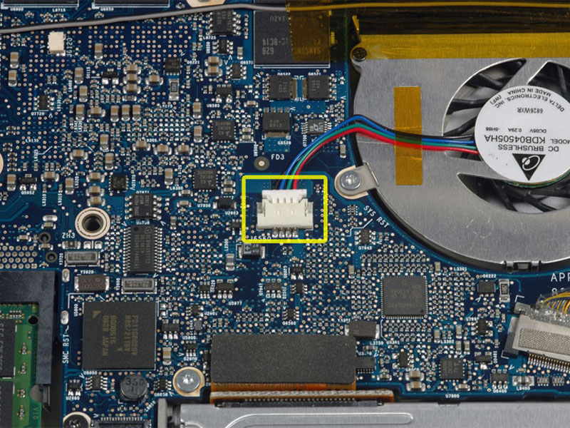

  11. MacBook Pro 15" Core Duo Model A1150 Right Fan Replacement, Right Fan: step 11, image 1 of 1
    • Disconnect the right fan cable from the logic board.
