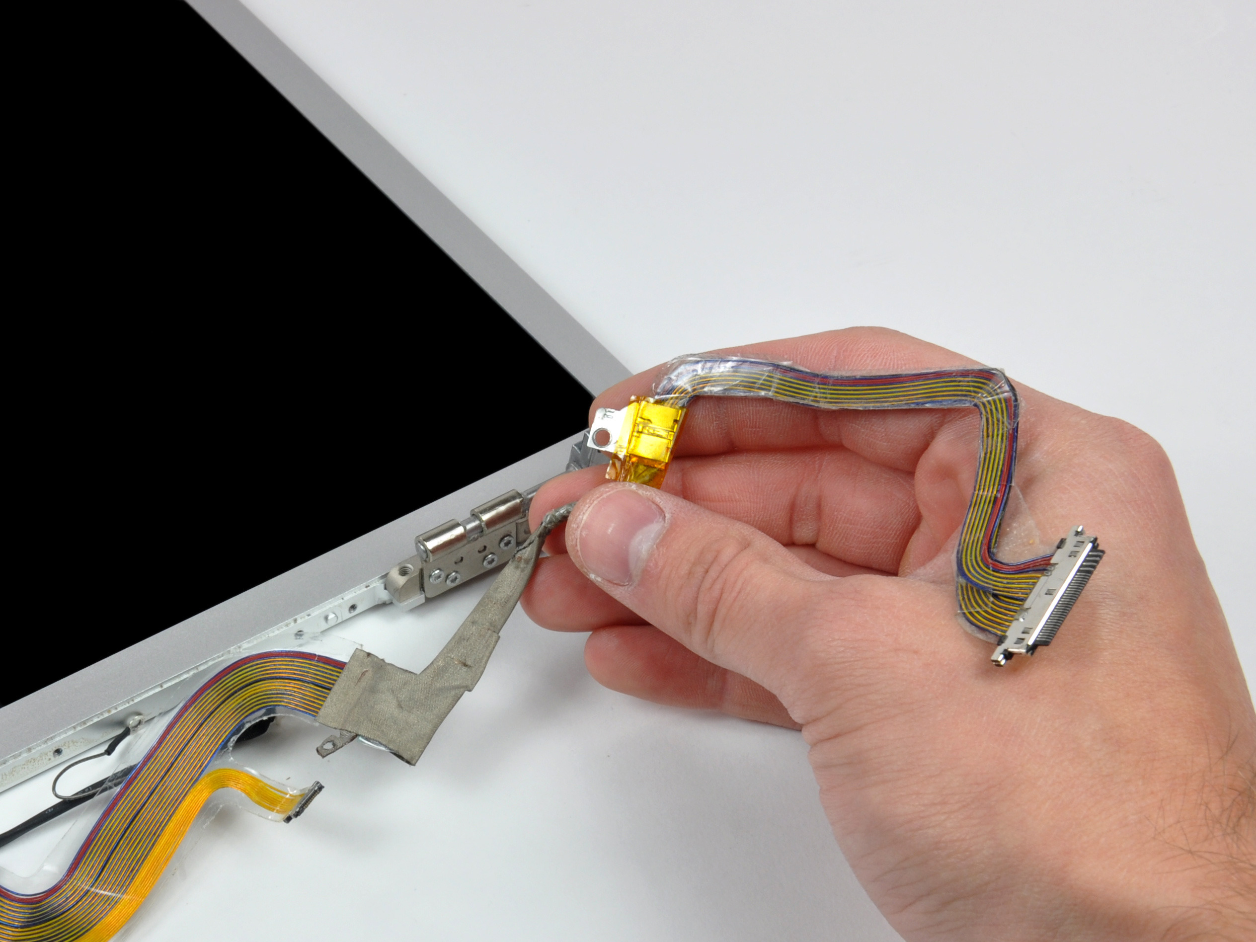

  36. MacBook Pro 15" Core 2 Duo Models A1226 and A1260 Display Data Cable Replacement, Display Data Cable: step 36, image 1 of 1
    • De-route the display data cable from around the right clutch hinge and remove it from the front bezel.
