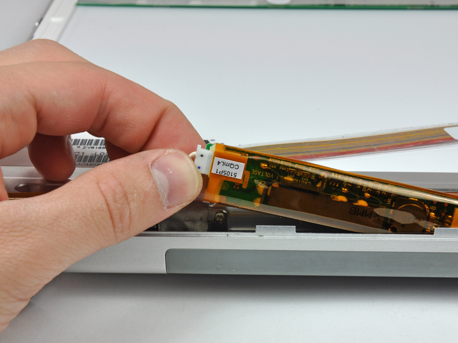

  24. MacBook Pro 15" Core 2 Duo Model A1211 Display Inverter Replacement, Display Inverter: step 24, image 1 of 1
    • The display inverter is a very thin and delicate circuit board that is easily broken. Use caution when handling.
    • Carefully lift the inverter board out of the clutch cover.
  25. MacBook Pro 15" Core 2 Duo Model A1211 Display Inverter Replacement: step 25, image 1 of 1
    • Disconnect the LCD backlight from the inverter by pulling its connector away from the inverter board.
  26. MacBook Pro 15" Core 2 Duo Model A1211 Display Inverter Replacement: step 26, image 1 of 1
    • Be cautious to not put any strain on the inverter cable ground loop, as it is a very thin and delicate wire.
    • Disconnect the inverter cable by pulling its connector away from the socket on the inverter.
