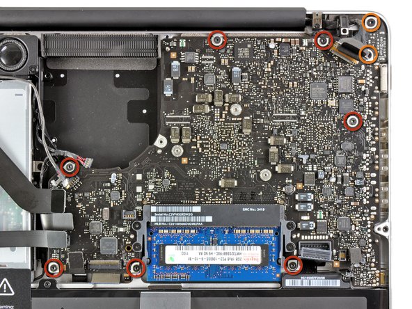

  16. MacBook Pro 13" Unibody Early 2011 Logic Board Replacement: step 16, image 1 of 1
    • Remove the following nine screws:
    • Five 3.6 mm T6 Torx screws
    • Two 4.3 mm T6 Torx screws
    • Two 7.2 mm T6 Torx screws
    • In some models the screws may be slightly shorter as follows:
    • Five 3.0 mm T6 screws
    • Two 3.6 mm T6 screws
    • Two 6.7 mm T6 screws
