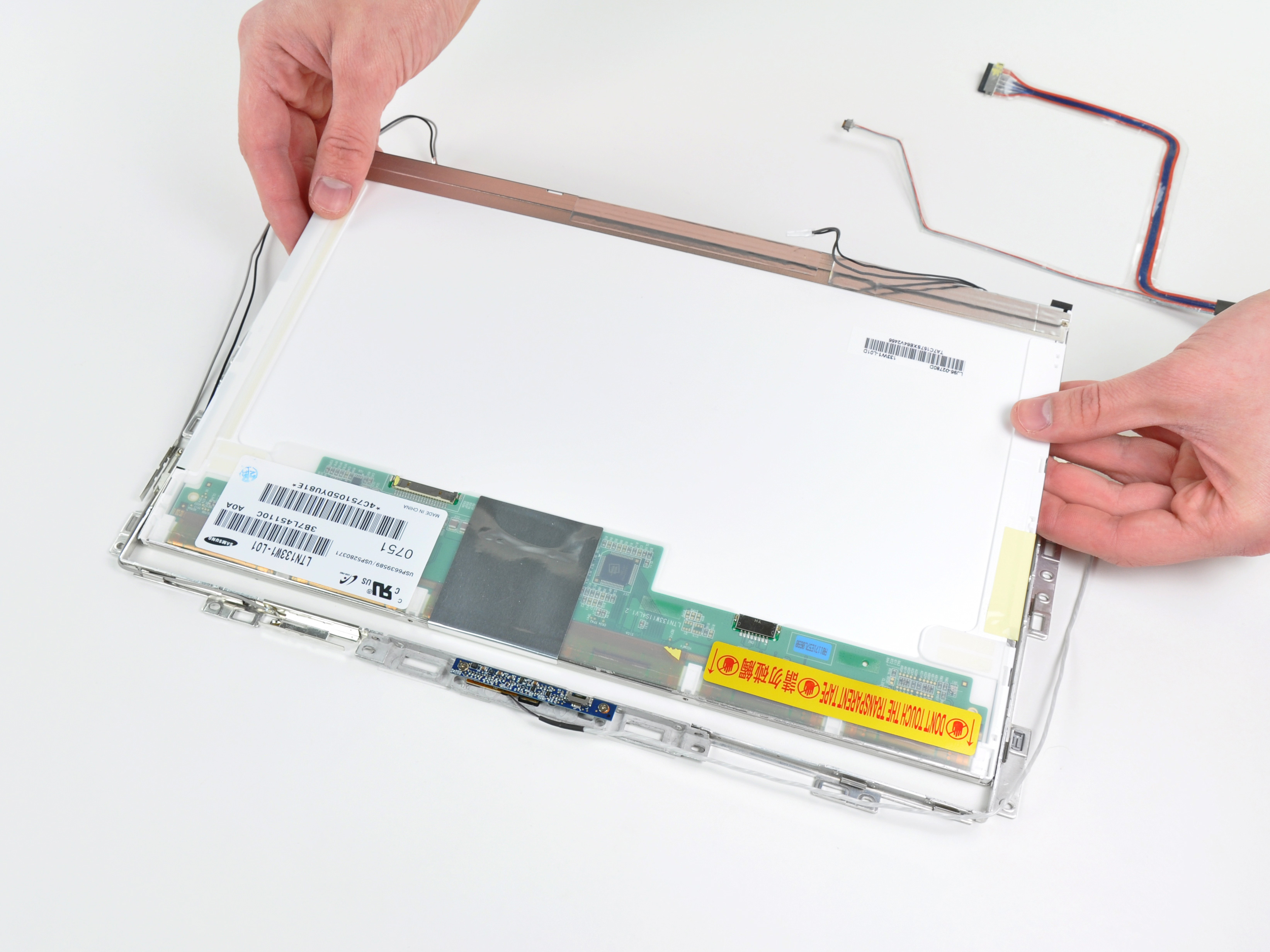

  61. MacBook Core 2 Duo LCD Panel Replacement: step 61, image 1 of 1
    • Lift up the LCD panel by its bottom edge and slide it out of the metal mounting brackets.
