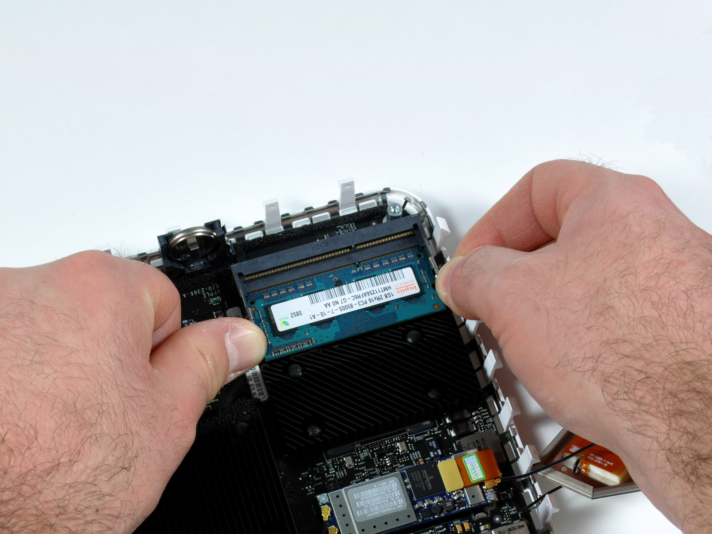

    1. Mac mini Model A1283 RAM Replacement, RAM: step 14, image 1 of 2 Mac mini Model A1283 RAM Replacement, RAM: step 14, image 2 of 2
      • Simultaneously pull the tabs on each side of the RAM chip away from the center of the chip. These tabs lock the chip in place and releasing them will cause the chip to "pop" up.
      • Pull the RAM chip directly out from its connector.
      • If there are two RAM chips installed, repeat the above procedure for the second chip.

if you are upgrading to 8g it may not work. my system would only recognize a mismatched 4g and 2g for 6g. even the 2g boost from 4g made some speed improvement
walang - Reply Share
Well done! Easy to follow and thorough! Took me 10 minutes start to finish!
Bill Finch - Reply Share
You probably need to install Mac Mini EFI firmware update 1.2:
https://support.apple.com/kb/DL888
Kevin Moorman - Reply Share
Wife has the Late 2009 Macmini (MM) originally with 2GB. We upgraded to 4GB a couple of years ago, and it has been running very slow with Yosemite (10.10.5) for far too long.
Ordered the 8GB upgrade kit and set for 2 day delivery. Bummer it came in 1 day via UPS. Thanks for the surprise iFixit. The tools were unnecessary for me (as I have most), but they are totally outstanding and the real deal. So I decided to use them all. ;)
The upgrade took about 15 min (even for this experienced Mac repair guy). Fired it up and the MM recognized all 8GB. It doesn’t scream, however, it is probably 2-3 times faster and can handle the amazing multi-takser that is my wife; 16 Safari pages, Mac Mail, Calendar, and 7 other apps open at all the same dang time. Thanks iFixit for the absolute best in repair universe parts, service, tech commitment, and guides.
ToddR - Reply Share
It worked!!! Love it!!! The websites installation guide was very easy to understand. However, the small screwdriver that was shipped with the kit didn’t fit the screws for step-12, almost stripping the screws. luckily, I had another small screwdriver (for glasses) that worked.
Thank you ifixit!!! Totally worth it.
Justin Basl - Reply Share
