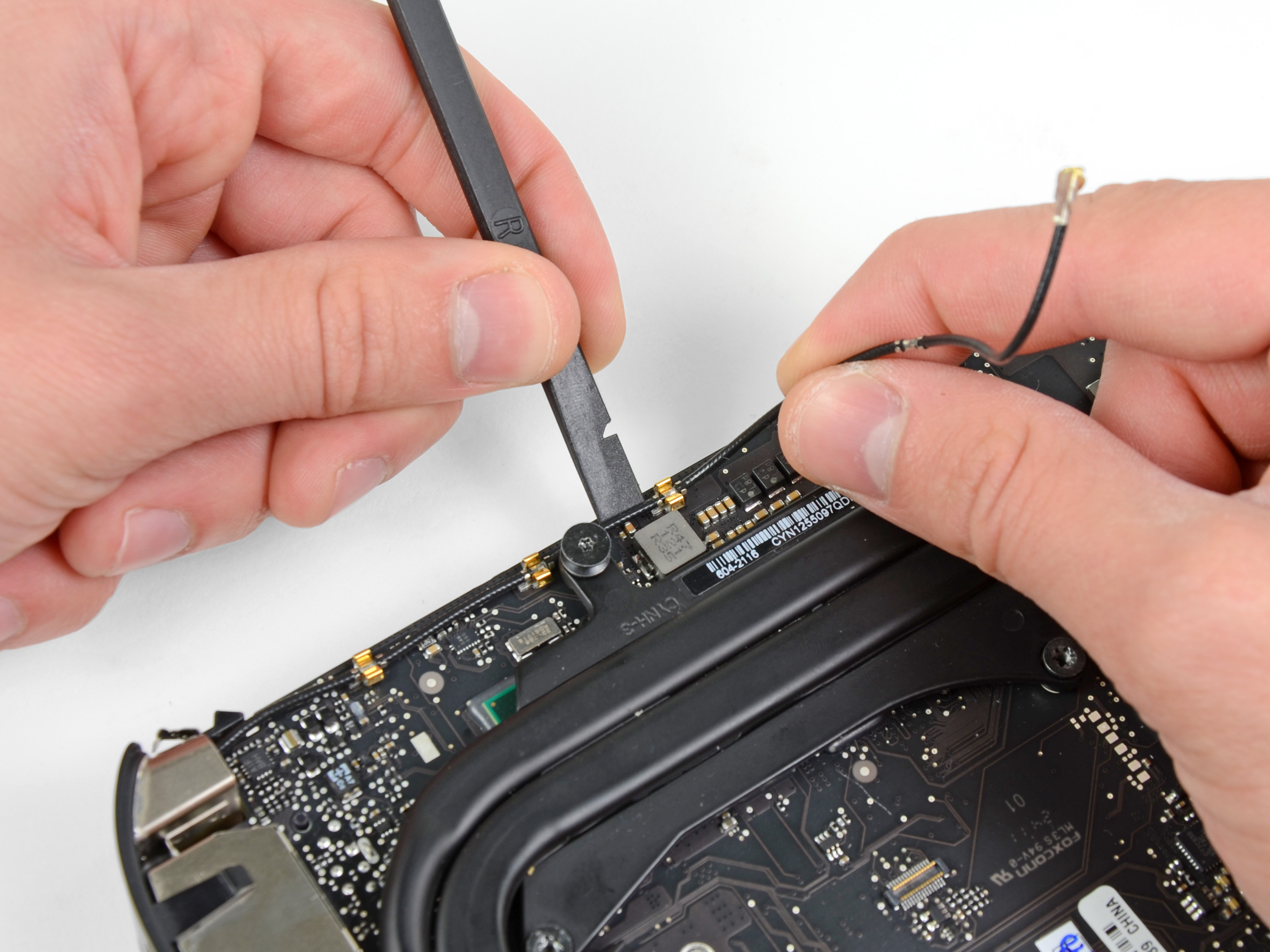

Lift the fan out of the mini for enough clearance to access its connector.
  • Lift the fan out of the mini for enough clearance to access its connector.
  • Carefully pull the fan cables upward to lift the fan connector up out of its socket on the logic board.
  • Remove the fan.
You actually don't need to disconnect the fan. You can just let it hang on the side while working. I accidentally killed my connector trying to pry it loose. It's being held together now by some tape, after spending hours trying to reconnect it and figuring out pin outs.
Nick Michielsen - Reply
Did it just as Nick suggested, hang the assembly to the side.
David Chan -
Agreed. It is much better to leave the fan connected. The only thing you actually need to disconnect is the hard drive.
ablack3 -
Be careful to LIFT UP on the fan connector cable. Using a spudger tool helps here. I mistakenly thought that the connector would slide off the logic board and tried to remove the connector this way. I ended up lifting the connector off of the logic board, thus ruining my logic board and requiring a $350 logic board replacement at the genius bar. The second time I did a HD/SSD replacement, everything worked fine.
wattmagner - Reply
Yeah, I did the same thing by following someone elses "shortcut". Now I am going to shell out 289 for quad core i5 board, and a new fan BTW. . . . . . Oh well never a dull moment :) and it gets an upgrade as well!
rob Stewart -
That's probably the must tricky part of the replacement. I did the same thing, i just pull on my cables and the connector stays on the board. Tried many times to switch cables into but any order i try is not the good one.
The avoid this, now, when i want to pull out my fan, i just use a plate screwdriver and lift up the connector. That's work perfectly.
ayottepl - Reply
I've just pulled out the connector that's soldered to the logic board because I used a pry tool. Be careful at this point to just pull gently on the four cables that go to the fan.
No Name - Reply
The CAUTION in step 13, "Make sure to pry up from beneath the wires and not underneath the socket," applies to this step as well, for removal of the fan wires.
lsbf - Reply
I screwed it too... Not reading carefully enough, I accidentally removed the whole socket from the board. This happened with the IR connector too. When re-assembling the parts, the socket wouldn't stick to the board, now I know why. I don't want to buy a new logic board, because I can't afford one, so I'm trying to find someone to solder it. Seems hard to find someone able to repair logic boards these days. Hope I'll be successful, otherwise this is an expensive upgrade to my mac...
Floffrob - Reply
Don't remove it with your fingers, use a tool for that. And underneath the wires!
sebcthiebaud - Reply
Followed all the instructions, everything went well, but now my mini fan won't turn off. It starts as soon as I boot up. I've tried every fan control software out there, and nothing works; the fan just constantly runs. I was very careful when I disconnected/reconnected the fan cable, and it looks fine. What else can I do?
Ben Dunkle - Reply
The problem is most likely a disconnected or damaged temperature sensor, I had this problem when reassembling a 2007 Mac mini. It can't read the temperature, so assumes the worst and sets the fan to maximum.
patrick27leiser -
I broke the fan wires from the connector plug. Impossible to repair. I have ordered a new fan. Is there a correct orientation to plugging in the new connector?
ronhixson - Reply
For heavens sake please DON'T remove the fan. It's really really hard to reconnect it properly. And besides that you don't have to remove the Logic Board for just changing the HDD.
Greg Kollmann - Reply
Does anyone know how to solve the full RPM fan issue? My computer guy couldn't solve with fan control software
J beneventi - Reply
I removed the fan and everything worked fine, but it’s good to know that it’s a “push-down“ connector, took me some time to relize that, all I needed to do was to press down the connector over the pins, see the picture for more details.
Jan Igerud - Reply

Use the flat end of a spudger to pry both antenna connectors up from their sockets on the AirPort/Bluetooth board. Use the flat end of a spudger to pry both antenna connectors up from their sockets on the AirPort/Bluetooth board.
  • Use the flat end of a spudger to pry both antenna connectors up from their sockets on the AirPort/Bluetooth board.
Carefully un-clip the antenna from the logic board near the heat sink.
  • Carefully un-clip the antenna from the logic board near the heat sink.
Carefully un-clip the antenna from the logic board near the PRAM battery. Gently de-route the antenna cable through the hole in the logic board.
  • Carefully un-clip the antenna from the logic board near the PRAM battery.
  • Gently de-route the antenna cable through the hole in the logic board.
Carefully un-clip the antenna from the logic board opposite the I/O bezel. De-route the antenna cable from the clips on the logic board near the I/O bezel.
  • Carefully un-clip the antenna from the logic board opposite the I/O bezel.
  • De-route the antenna cable from the clips on the logic board near the I/O bezel.
