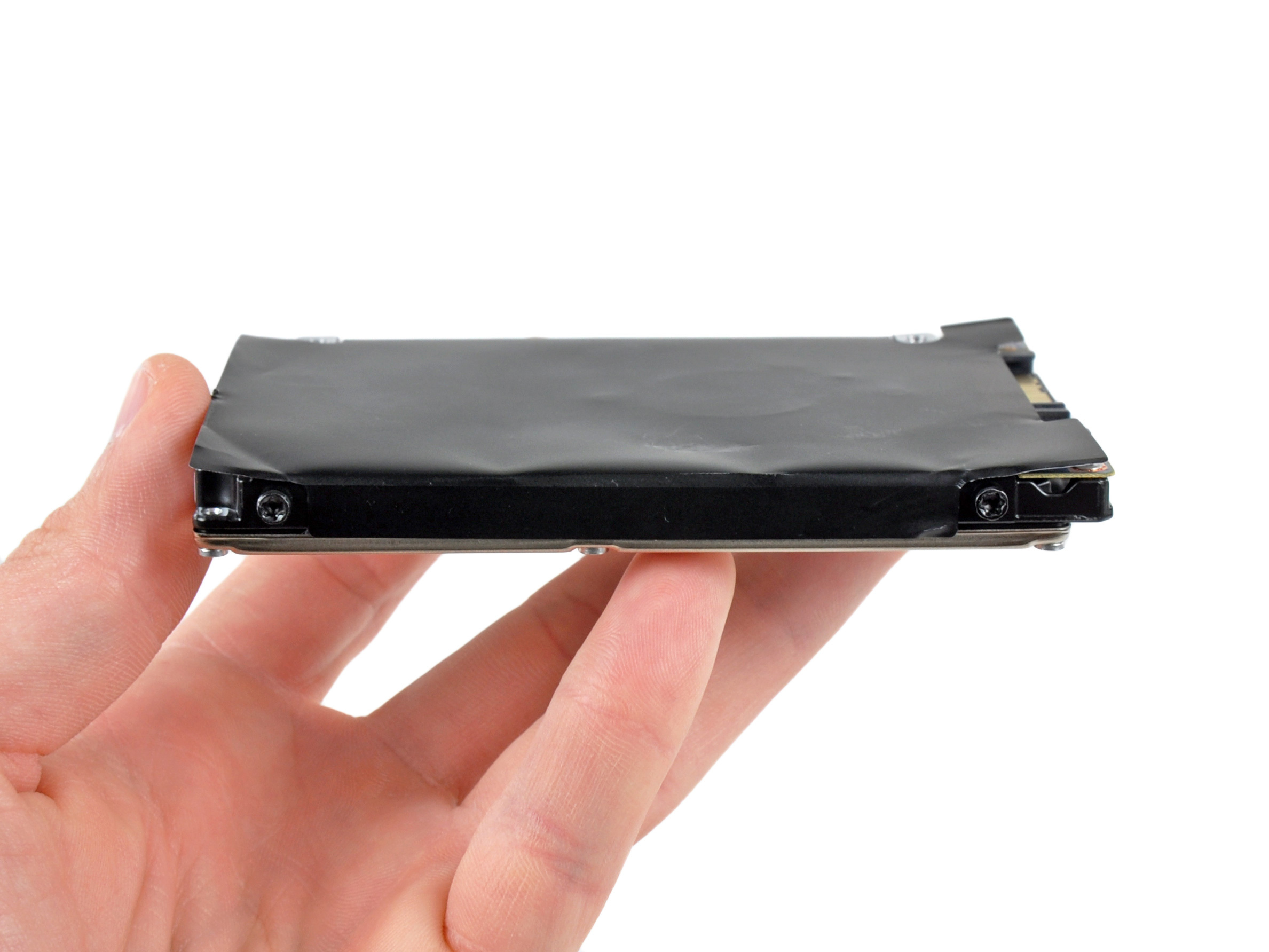

    1. Mac mini Mid 2011 Hard Drive Replacement, Hard Drive: step 19, image 1 of 1
      • Remove the hard drive cable.
      • There may be a sticker connecting this cable to the hard drive. If so, remove the sticker before attempting to remove the cable!
      • Remove the two 6.2 mm T8 Torx screws from the side of the hard drive.
      Ask FixBot
    2. Mac mini Mid 2011 Hard Drive Replacement: step 20, image 1 of 1
      • Carefully peel the hard drive cover off the hard drive.
      • Hard drive remains.
      • If you are installing a new hard drive, we have an OS X install guide to get you up and running.
      Ask FixBot
