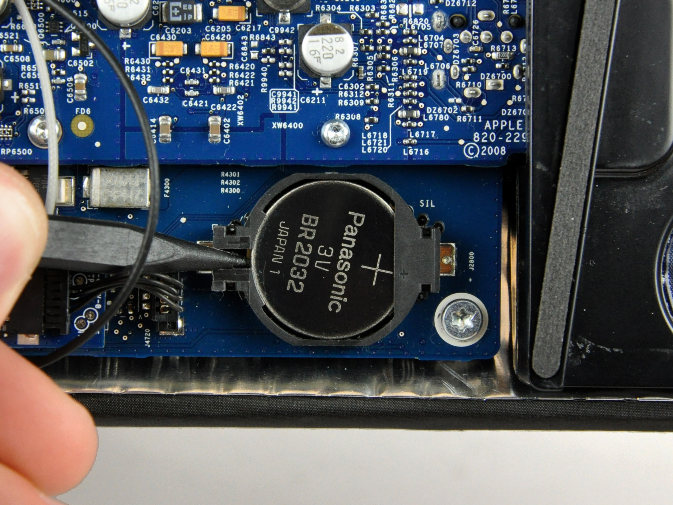

  7. iMac Intel 20" EMC 2133 and 2210 PRAM Battery Replacement, PRAM Battery: step 7, image 1 of 1
    • Use the tip of a spudger to pry the PRAM battery out of its holder.
