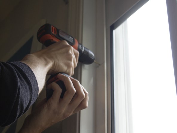

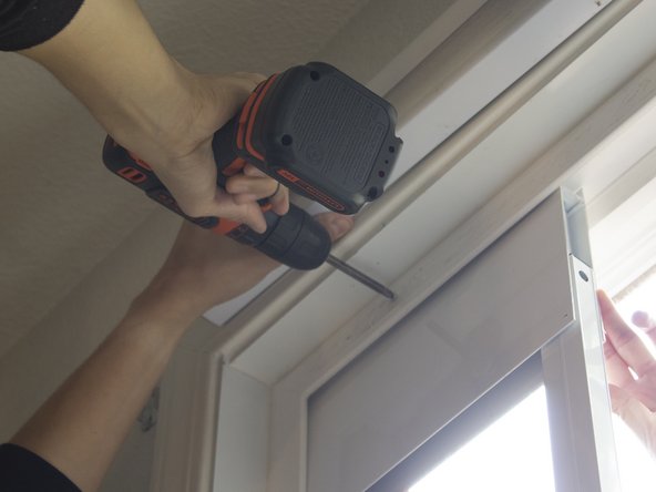

    7. Installing a Petsafe Removable Dog Panel: step 7, image 1 of 3 Installing a Petsafe Removable Dog Panel: step 7, image 2 of 3 Installing a Petsafe Removable Dog Panel: step 7, image 3 of 3
      • With a 9/64ths drill bit, drill clearance holes into the marks made on the sliding glass door frame
      • DO NOT GO THROUGH THE DOG PANEL

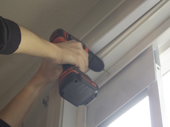

    8. Installing a Petsafe Removable Dog Panel: step 8, image 1 of 3 Installing a Petsafe Removable Dog Panel: step 8, image 2 of 3 Installing a Petsafe Removable Dog Panel: step 8, image 3 of 3
      • Fasten the panel to the interior side of the sliding glass frame with the provided ⅝” screws.
      • MAKE SURE YOU ARE DRILLING OUTSIDE OF THE RIBBED LINE ON THE DOG PANEL.
      • DO NOT OVERTIGHTEN.
      Ask FixBot
