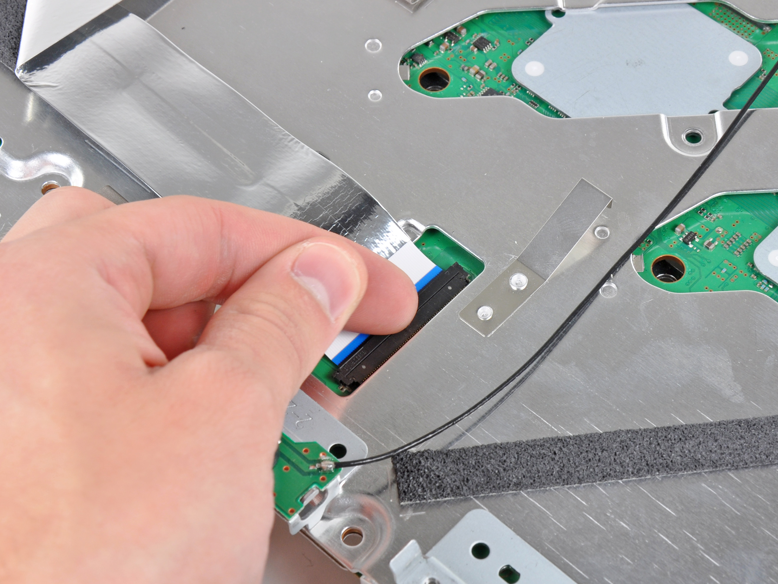

  41. PlayStation 3 Motherboard Replacement: step 41, image 1 of 2 PlayStation 3 Motherboard Replacement: step 41, image 2 of 2
    • Flip up the retaining flap on the Wi-Fi/Bluetooth ribbon cable socket.
    • Remove the Wi-Fi/Bluetooth ribbon cable from the motherboard.
