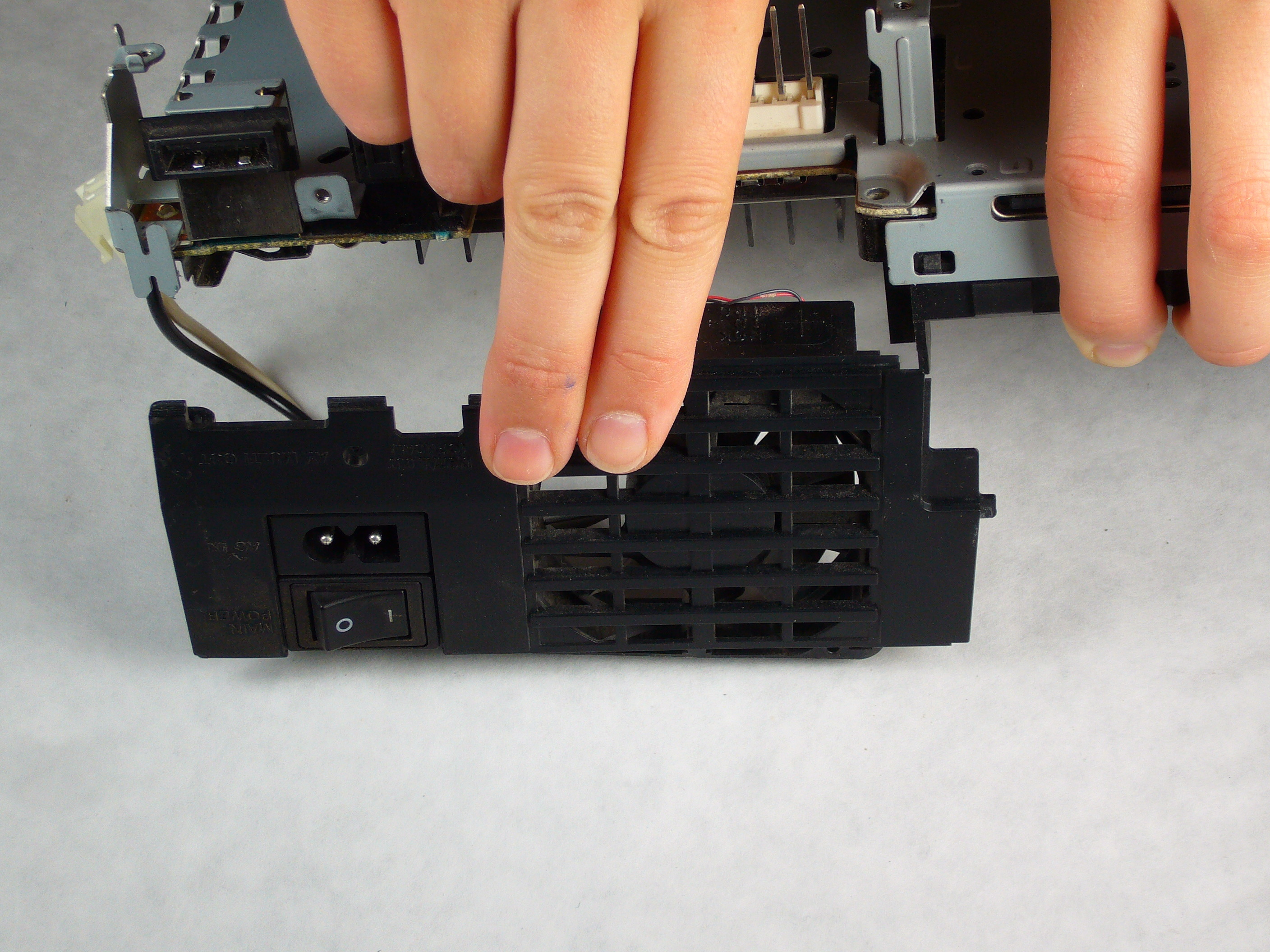

    • We can now remove the fan and main power switch assembly.
    • Remove the small white piece of tape (highlighted in red) that holds the fan cable connected to the fan.
    • Pull the fan cable straight up from its socket on the motherboard.
    • The fan and power switch are now free from the rest of the PlayStation 2.
    • Remove the fan and power switch assembly by pulling it out the bottom case.
  16. PlayStation 2 Fan Replacement: step 16, image 1 of 1
    • Remove the fan from the power switch assembly.
    • The fan simply slides out of the top along its track.
  17. PlayStation 2 Fan Replacement: step 17, image 1 of 1
    • Remove the power switch from its recess within the fan/power switch holder.
    • The power switch simply slides out just like the fan.
