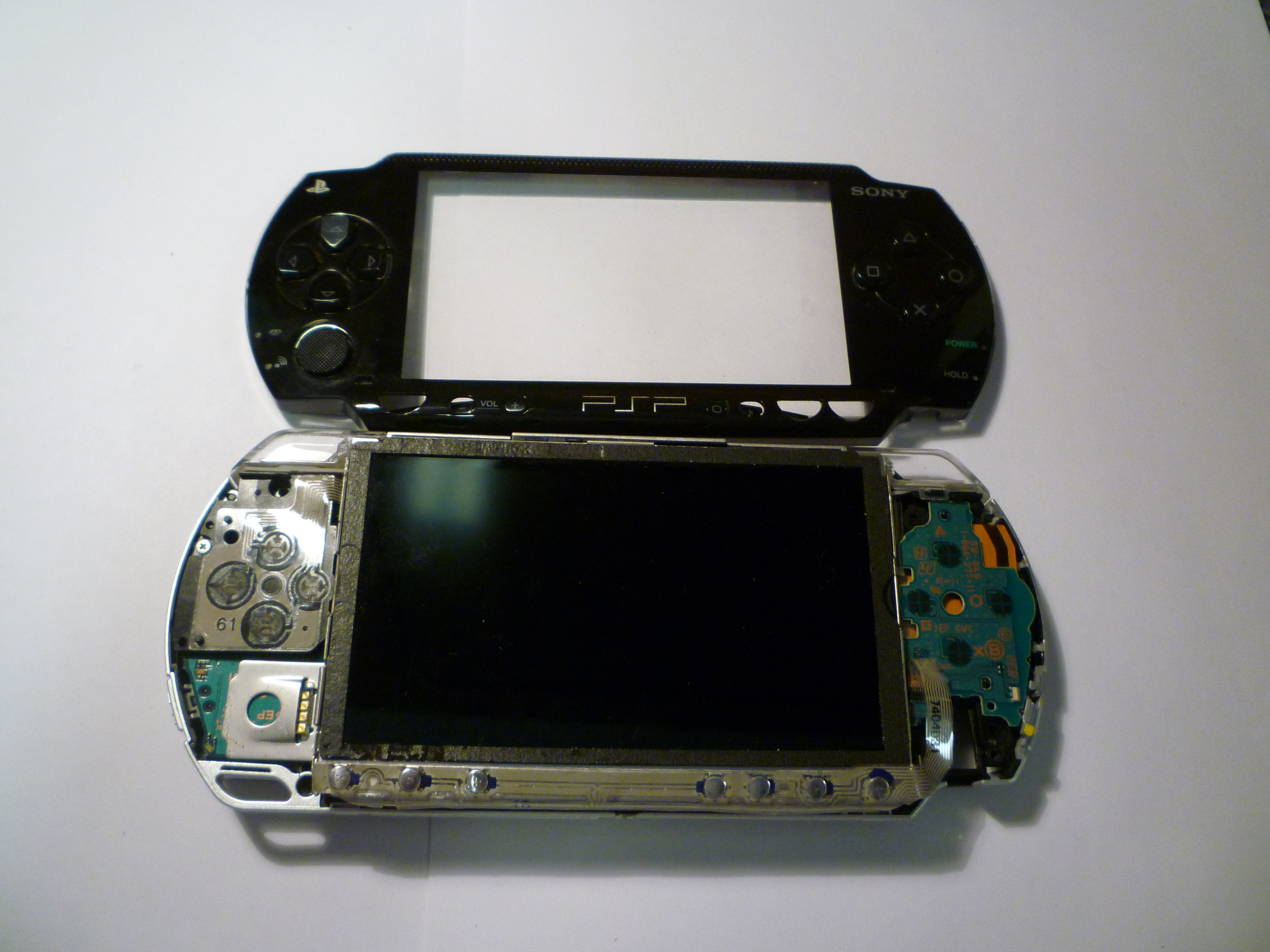

  6. PSP 1000 Buttons Replacement: step 6, image 1 of 2 PSP 1000 Buttons Replacement: step 6, image 2 of 2
    • Gently separate the outer plastic casing from the rest of the system as shown.

    • If function buttons (x, square, circle, triangle) need to be replaced, find the corresponding black rubber backing on the inside of the casing.
    • Carefully remove the back rubber to expose the rear side of the buttons as shown. (This can be done using your hands.)
  10. PSP 1000 Buttons Replacement: step 10, image 1 of 2 PSP 1000 Buttons Replacement: step 10, image 2 of 2
    • Next, carefully clean the receiving end of the buttons on the motherboard (shown on picture) with a cloth.
    • If the buttons are clearly damaged, then they need to be replaced.
    • Add the new ones in the form, with the correct button order. (The correct button order has the Triangle on the top, Square on the right, Circle on the left, and X on the bottom).
    • Be very careful! The buttons only go in one way. If you have trouble fitting them in, rotate them in their given spots until they fit in easily. Do NOT force them. Forcing the buttons in may cause damage.
  11. PSP 1000 Buttons Replacement: step 11, image 1 of 1
    • Once buttons are correctly replaced, the back rubbers are fit back onto the buttons, refer back to Replacing the Housing to reattach the casing.
