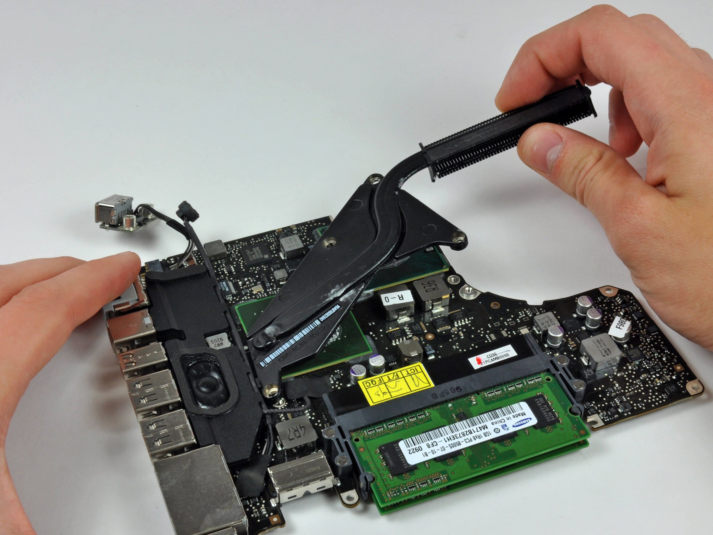

  20. MacBook Pro 13" Unibody Mid 2010 Heat Sink Replacement, Heat Sink: step 20, image 1 of 1
    • Remove the four 8.5 mm Phillips screws securing the heat sink to the logic board.
    • A spring is held under each of these screws. Be careful not to lose it.
  21. MacBook Pro 13" Unibody Mid 2010 Heat Sink Replacement: step 21, image 1 of 1
    • Gently lift the heat sink off the logic board.
    • When you mount the heat sink back onto the logic board, be sure to apply a new layer of thermal paste. We have a guide that makes replacing the thermal paste easy.
