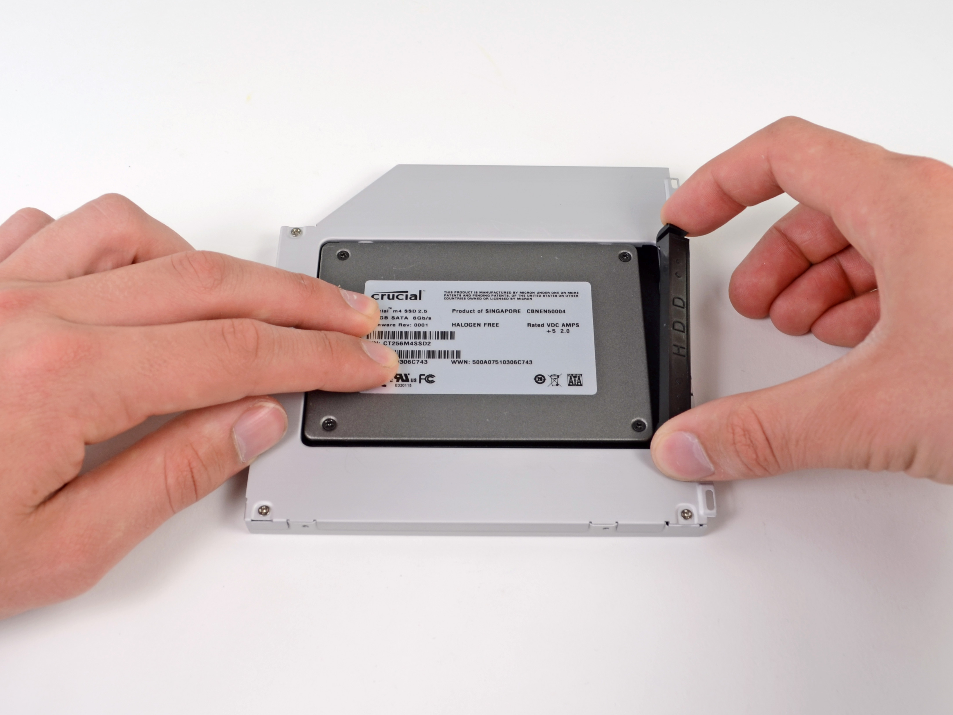

  14. Installing MacBook Pro 13" Unibody Mid 2010 Dual Hard Drive, Dual Hard Drive: step 14, image 1 of 2 Installing MacBook Pro 13" Unibody Mid 2010 Dual Hard Drive, Dual Hard Drive: step 14, image 2 of 2
    • Remove the plastic spacer from the optical bay hard drive enclosure by pressing in on one of the clips on either side and lifting it up and out of the enclosure.
  15. Installing MacBook Pro 13" Unibody Mid 2010 Dual Hard Drive: step 15, image 1 of 3 Installing MacBook Pro 13" Unibody Mid 2010 Dual Hard Drive: step 15, image 2 of 3 Installing MacBook Pro 13" Unibody Mid 2010 Dual Hard Drive: step 15, image 3 of 3
    • Make sure that the hard drive connectors are facing down before placing it into the enclosure.
    • Gently place the hard drive into the enclosure's hard drive slot.
    • While firmly holding the enclosure in place with one hand, use your other hand to press the hard drive into the enclosure connectors.
  16. Installing MacBook Pro 13" Unibody Mid 2010 Dual Hard Drive: step 16, image 1 of 2 Installing MacBook Pro 13" Unibody Mid 2010 Dual Hard Drive: step 16, image 2 of 2
    • Once the hard drive is snug, reinsert the plastic spacer while holding the hard drive against the bottom of the enclosure.
  17. Installing MacBook Pro 13" Unibody Mid 2010 Dual Hard Drive: step 17, image 1 of 2 Installing MacBook Pro 13" Unibody Mid 2010 Dual Hard Drive: step 17, image 2 of 2
    • Use two Phillips #1 screws to secure the drive to its enclosure.
  18. Installing MacBook Pro 13" Unibody Mid 2010 Dual Hard Drive: step 18, image 1 of 1
    • Attach the optical drive bracket to the new enclosure with two Phillips #0 screws.
    • Reconnect any cables you have removed from the original optical drive onto the optical bay enclosure.

I bought a 1TB SSD/hybrid drive from Ifixit.com to upgrade the 256GB HDD that came with MBP 2010. Disk Utility could not see the new drive on the original HDD cable but saw the old one just fine. New replacement cable was not the correct size for the MBP 2010 but worked just fine in my other MBP 2012. Put the stock HDD back in with the original HDD cable, removed the optical drive and replaced with the 1TB dual drive per instructions without problems. I have read online that the SATA HDD cable in MBP 2009 and early 2010 was too slow to read modern high-speed SATA drives.
Only glitch I found is DVD/CDs will not mount in the optical drive using the external USB cable that came with the dual disk kit purchased here. Will eventually have to find time to try swapping the optical drive with my other laptop to test internally as well as the external cable. At this point I don't care, didn't use the optical, love the two working internal disk drives. Thanks guys!
Bob - Reply
I replaced Primary HDD with SSD and moved HDD to optical slot with caddy, and it seems works, but HDD in optical slot is incredibly slow now. Macbook 7.1. Sierra. SSD Savage 250Gb.
Roman Nicolaevich - Reply
Smoooooth, like butta. Thanks for another great guide and parts. My 2010 macbook pro now has an ssd running fast w sierra, and my conventional drive for lots of storage. About $200 for ssd and the parts, and my computer will be in good shape for a few more years!
Brian Eldridge - Reply
