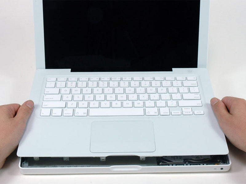

Starting near the display and working around to the front of the computer, pry up on the upper case. It is held with clips on the right above the optical drive. These will release with some firm lifting pressure.
  • Starting near the display and working around to the front of the computer, pry up on the upper case. It is held with clips on the right above the optical drive. These will release with some firm lifting pressure.
  • Be careful when prying up the upper case. It's very easy to slice open a fingertip and thus provide the blood sacrifice the Mac gods sometimes require of those who insist on doing their own repairs.
  • There's a trackpad and keyboard ribbon connecting the upper case to the logic board, so don't pull the upper case off entirely just yet.
  • If you have trouble getting the clips to release, be careful that you are not prying the plastic top of the upper case away from its metal frame.
I had a lot of trouble lifting up the right side. I had to use a great deal of force, and I hesitated for quite some time for fear of snapping the casing.
yowsa - Reply
Danger Will Robinson!! My upper case did NOT want to come out on the right side. I just trusted to cameronmoll and kept lifting straight up. Finally, it came loose, but it wasn't easy. Meanwhile, while I was dealing with the cable -- just had to pull up a black tab hooked to it -- I somehow managed to chip the front, top edge of the upper case -- the edge farthest from the screen -- in two places, one on the right, one on the left. So, watch that edge, it is thin!
adamorth - Reply
Regarding the right side, there is a series of 3-4 plastic snap in locks on that side along the optical drive, holding the case down in lieu of screws. It takes serious pressure to remove the snapped in pieces (just lift straight up). You should also make sure to line them up when you put the casing back on. Another picture might help show that portion better
dougyfresh - Reply
My upper case also came off with a little difficulty. There are some plastic tabs that hold the case down (4 of them). They sorta "pinch" onto 4 little bars that are part of the upper case (note, the bars appear to be metal). I worked my upper case to the left a little and it came out easier. One of the these tabs was really tight. Note: if you do this, one or more of the tabs may stay on the upper case, you'll need to move them back in place before putting the upper case back on (pry it off the upper case with a spudger, or very carefully with a flat screwdriver as to not damage it). It will slide back into a slot on the body.
dmorrison - Reply
Quote from dougyfresh:
Nicholas Stubbs - Reply
Regarding the right side, I found that the 4 clips slide to the left more easily that pull out. However, the front right has a bar which drops into a slots preventing pulling to the left! So ... gently lift the front right (furthest from the screen), pressing just at the front end of the optical slot to bend the faceplate at that point, then gently rock the face plate back and forwards while pulling left, so the that the four clips slide out of their retainers - presto! Remember to bend the faceplate to reassemble.
Step 11 really needs a better description. I started undoing the tape that holds the case above the optical drive slot to the metal before I read the comments and realized what I needed to do. Once you start to pull the top case up from the front, you'll reveal enough of an opening to get a spudger all the way under the metal portion of the top case next to the first snap. Once you have the spudger in, it's easy to release the snap without worrying about bending the whole topcase. Just repeat for the remaining three snaps. Once I got this technique down, it really didn't feel like I was doing anything that might damage the case.
chaos215bar2 - Reply
By the way... don't worry if you undo the tape. It will go right back together with a little pressure. I didn't even need to go out and buy some adhesive to fix it.
I recently replaced the inverter cable. Now the power button doesn't work anymore.. but the keyboard and trackpad still do work. I already replaced the uppercase cable with no success. Does somebody have an answer to this problem?
milanseegers - Reply
There are 4 plastic locks on the right side which prevent the keyboard from lifting up. They slide out easily if the keyboard is moved to the left. To move the keyboard to the left you first have to release the left and front side. On the left and front side there are metal strips that are snapped in. They should release when you push the metal strips with a spudger towards the center of the computer. We had much trouble releasing one metal snap as we didn't know how to do it.
When you reinstall the keyboard put the plastic bars in the frame at the right side of the case, then snap in the keyboard on the left and front side and finally snap the keyboard into the plastic snaps to the right. Be careful so they don't fall out before you snap them in.
A metal piece fell out of the computer. It was a shielding of a connector on the left side.
A tiny plastic disc (4 mm diameter) with a hole in the middle also fell out. I had little hope to find out where it belonged and it didn't seem too important, so I left it, but kept it in a minigrip bag. Does anyone know what it's for?
darsie - Reply
Pull straight up on the section above the optical drive. If you slide this section out, you'll have to slide it back in for reassembly, which is harder than pushing vertically.
unthread - Reply
There are four plastic clips above the CD slot that may come off or stay attached to the uppercase. On reassembly remove them from the upper case and locate the clips into the slots in the frame inside the lower case before lowering the upper case down into position.
James - Reply
Be really careful! I broke the connector easily and had to replace it.
It is out of stock on iFixit. I found it there: https://www.amazon.it/gp/product/B01MSH3...
poissonjerome - Reply
While holding up the upper case (from the bottom or the top), use a spudger to pry up the orange trackpad and keyboard cable from its connector. Take care to pry between the black socket and the white connector. You might have to pry on both sides for it to release properly.
  • While holding up the upper case (from the bottom or the top), use a spudger to pry up the orange trackpad and keyboard cable from its connector.
  • Take care to pry between the black socket and the white connector. You might have to pry on both sides for it to release properly.
  • Do not pry from the bottom or the top, but from the sides.
  • If you happen to break your upper case cable when removing the upper case, we stock the cable individually and we have a guide that makes replacing it easy.
It lifts straight up.
Cameron Moll - Reply
Quote from cameronmoll:
I'd suggest being careful and perhaps having help with step 12, as I have broken the connector piece at the end of the cable by pulling too hard/fast and having the connector stuck in the board and the ribbon dangling without purpose.
Does anybody know of a good way to repair such a ribbon, or am I stuck buying new upper case units?
o2bnited - Reply
An extra picture or warning should be added about this... The same as you, I broke the connector. I didn't even use any force, but the pins got off the cable and now I'm forced into buying a new one. Trying to buy one from ebay as we speak. It might have been due to metal fatigue after 7 years, but it got broken none the less.
schederpetel -
The computer serial number and network IDs are on the underside of the top case (visible in the battery compartment.) In order to prevent misidentification in the future (for instance, while on the phone with Apple tech support), I print the info from the old top case on a sticker and affix it over the label on the new top case.
colleenthompson - Reply
A lot of top case replacements are due to the front edge being broken by the bumpers on the lid of the MacBook. I stick a couple of felt dots on either side of these bumpers to absorb some of the shock when the lid is slapped shut, to prevent damage to the new top case.
I think that one extra picture should be added here. That is to say, the purpose of using the spudger (which I do suggest you should buy so that you don't risk ruining the orange cable), is to unplug a little connection. Basically your are "popping" it open. Had I known this it would have made th4e process feel a little less risky. In any case the mission was successful... Job completed in 45 minutes and my computer has wireless internet once again!!
juztino - Reply
Be really careful. The cable comes up really easily.
Nick Cox - Reply
Do NOT use a spudge!!! Just pull in the tab. Spudge Ruins the cable!
Oliver - Reply
The image is misleading. Don't pry it up from the front, but from the sides. Personally I used a small flathead screwdriver, but sadly - only after ripping apart the soldering on the wire/plug.
Also, be careful to lift the white plastic plug, not the circuitboard/wire attached to it
Magnus Bae - Reply
I'm repairing the Black version which appears to be slightly different from the picture. There is a flexible black tab on top of the connector. All I had to do was lift up the tab with my finger and pull the connector straight up.
David - Reply
After reading everyone's comments, I used the narrow spudger and slid it around from the front to the right then the front to the left and it lifted up easily..
shewearsmanyhats - Reply
