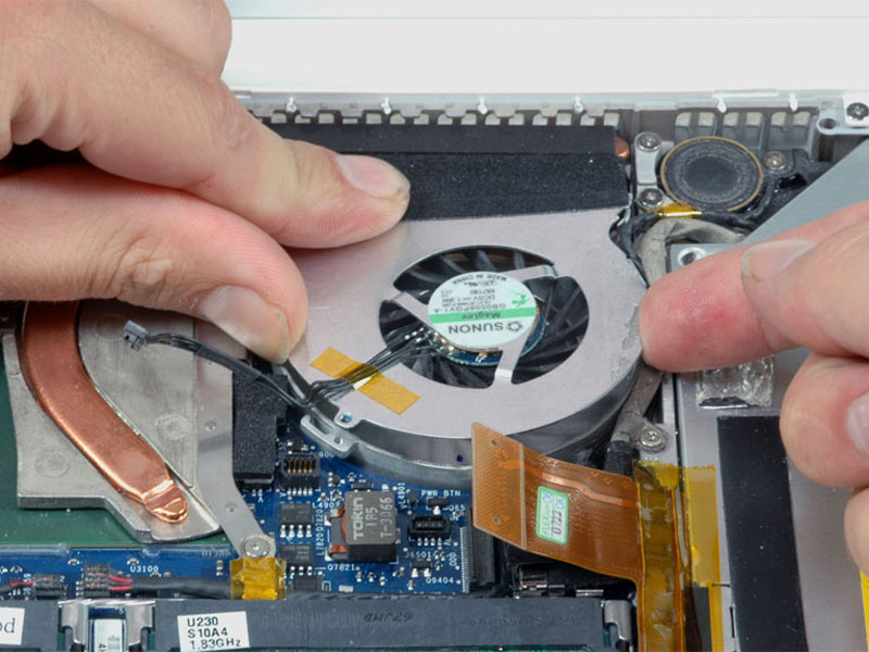

Go to step 1 ↓Replacing a defective fan is relatively easy and will keep your MacBook Core Duo running cool.
Remove the three evenly-spaced Phillips screws from along the rear wall of the battery compartment.
Remove the following 3 screws:
One 11 mm Phillips #00 in the middle of the case.
Two 14.5 mm Phillips #00.
Starting near the display and working around to the front of the computer, pry up on the upper case. It is held with clips on the right above the optical drive. These will release with some firm lifting pressure.
Be careful when prying up the upper case. It's very easy to slice open a fingertip and thus provide the blood sacrifice the Mac gods sometimes require of those who insist on doing their own repairs.

Having opened my MacBook several times before, fan replacement is one of the easier swaps to do. Tip: if your fan is running, but making upsetting noises, first check for a dust clog within the fan housing before you replace the fan. Lift the fan motor up without removing the felt tape seal, and inspect the heat sink grille for clogs (mine had a huge dust bunny on the left side, which was catching on the fan vanes). Carefully remove dust with spudger (or, ideally, a needle attachment on a 3M electronics vacuum). Good luck!
I just completed this on my white macbook which I purchased in 2007. First, while in steps 19 and 20 they tell you to remove all four fan screws (two that hold the fan to it's lower housing, and two that hold the housing to the computer), they then only remove the fan without the housing. The entire housing should be removed in order to clean the heat sink behind the top of the fan. My replacement fan came as one unit anyway, so I replace the entire thing. Second, after many heating and cooling cycles, the black felt tape described in Step 20 was degraded and not able to be removed from the fan without ripping it. I replaced it with a couple layers of electrical tape (hopefully it holds up), but I would recommend getting the correct replacement tape before replacing the fan. Otherwise, if you're used to working on electronics and are relatively patient, it's actually pretty easy to do.
