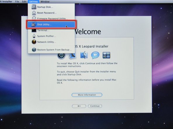

    3. Installing Mac OS X 10.5 Leopard: step 3, image 1 of 2 Installing Mac OS X 10.5 Leopard: step 3, image 2 of 2
      • After the installer loads, you will be greeted by a welcome window.
      • Select “Disk Utility” from the Utilities drop down menu.

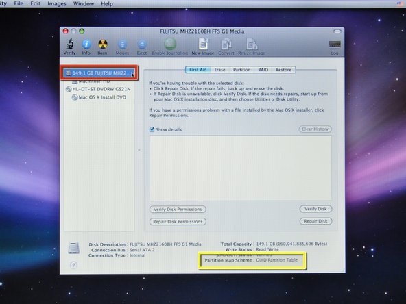

    4. Installing Mac OS X 10.5 Leopard: step 4, image 1 of 1
      • Select your new hard drive from the left column in Disk Utility.
      • The correct partition table type needs to be set for your hard drive.
      • If it's a brand-new hard drive, it may have no partition type listed.
      • For an Intel-based machine, you should have "GUID Partition Table" listed.
      • For a Power-PC-based machine, you should have "Apple Partition Map" listed.
      • If the incorrect partition type is listed, proceed to the next step to delete and re-create the partition. If not, proceed to step 8.
      • Warning: Deleting the partition table will erase the entire contents of the drive.

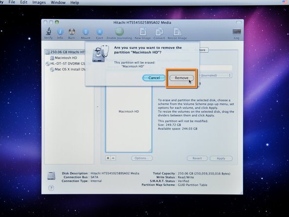

    5. Installing Mac OS X 10.5 Leopard: step 5, image 1 of 3 Installing Mac OS X 10.5 Leopard: step 5, image 2 of 3 Installing Mac OS X 10.5 Leopard: step 5, image 3 of 3
      • The following two steps are only necessary if your drive's partition is set incorrectly. Erasing a partition will permanently erase all information stored inside.
      • Select the partition on the drive and click the "-" button.
      • When prompted, click the "Remove" button to remove the drive's existing partitions.
      • Once the partitions have been removed, click the "Options..." button.

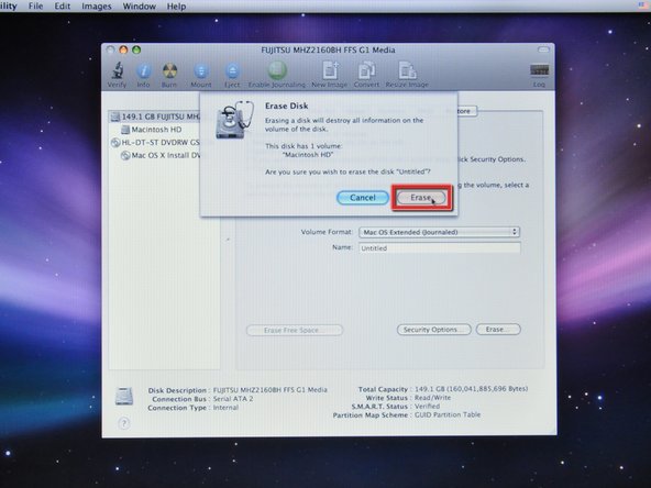

    9. Installing Mac OS X 10.5 Leopard: step 9, image 1 of 1
      • A warning window will pop up and ask if you wish to continue with the erasing process.
      • Click "Erase" on the warning window that has popped up.

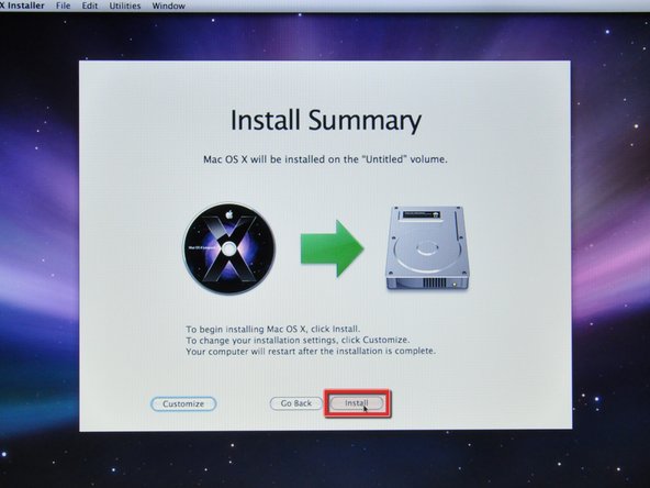

    13. Installing Mac OS X 10.5 Leopard: step 13, image 1 of 1
      • We are now ready to install Mac OS X v10.5 Leopard on the hard drive. Before proceeding to the next step, make sure that all of the installation settings are correct.
      • Click "Install" to commence the installation.

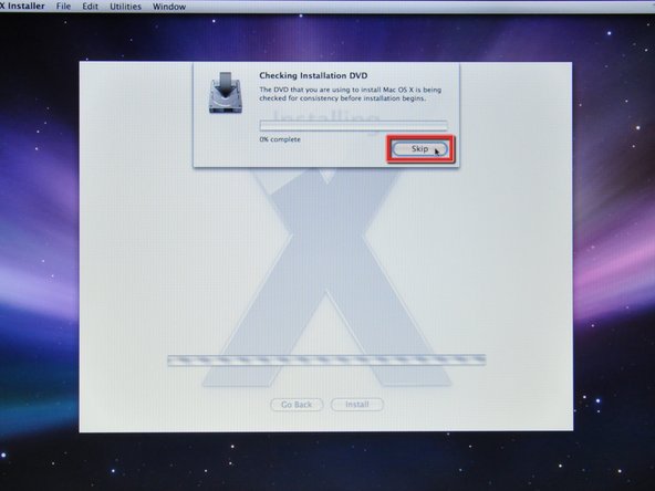

    14. Installing Mac OS X 10.5 Leopard: step 14, image 1 of 1
      • The installer will check the source DVD disk before starting the installation process.
      • During this step, you will see a "skip" button. It is not necessary to check the disk, and the "skip" button may be used. However, if you have never used your disk before, or haven't used it recently, it is highly recommended you check it.
