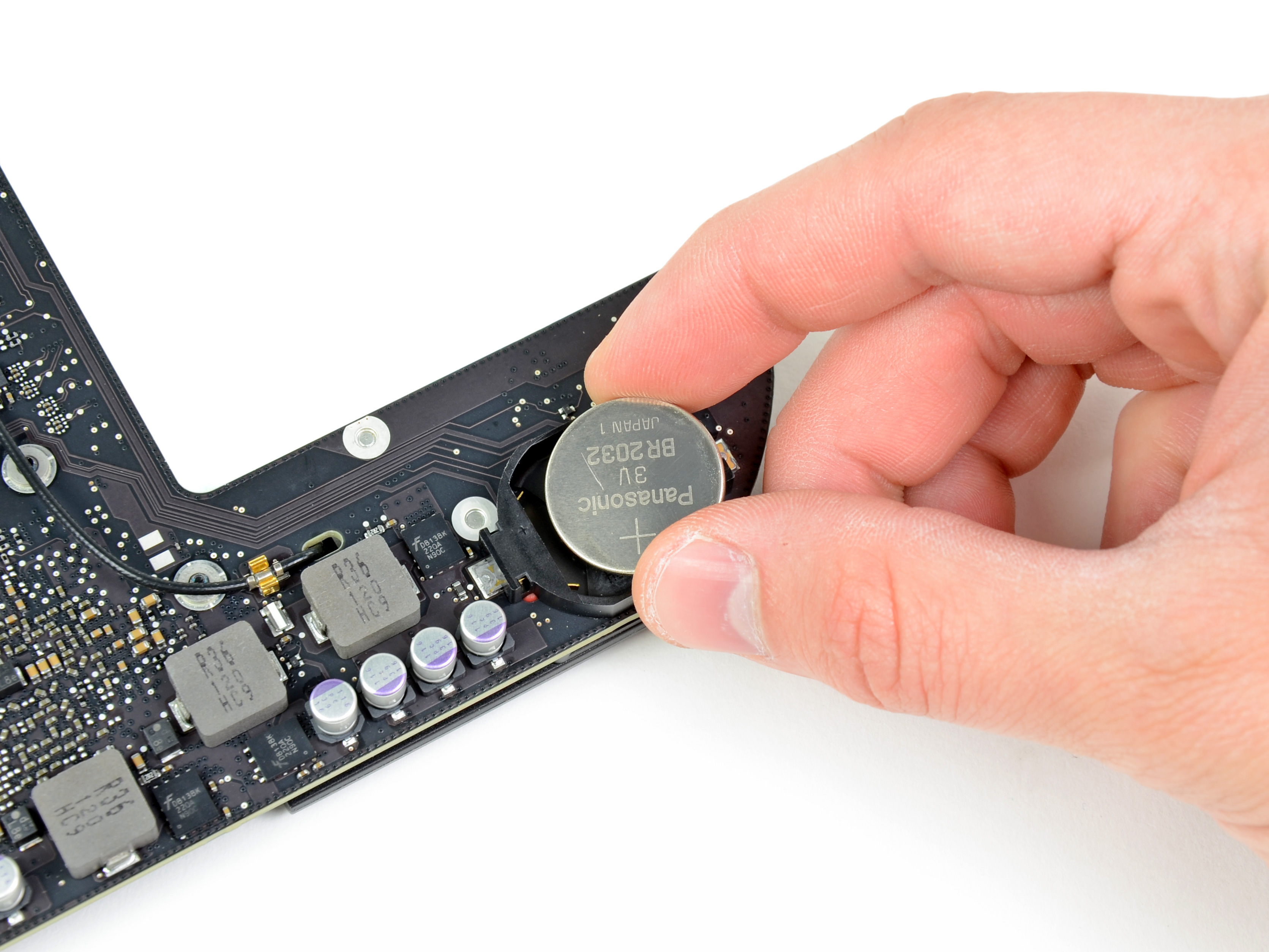

  18. Mac mini Late 2012 PRAM Battery Replacement, PRAM Battery: step 18, image 1 of 1
    • The PRAM battery is located on the top side of the logic board.
    • Use the tip of a spudger to carefully pry the PRAM battery up and out of its holder on the logic board.
  19. Mac mini Late 2012 PRAM Battery Replacement: step 19, image 1 of 1
    • Remove the PRAM battery from the logic board.
    • The PRAM battery is a commonly available BR2032 coin-cell.
