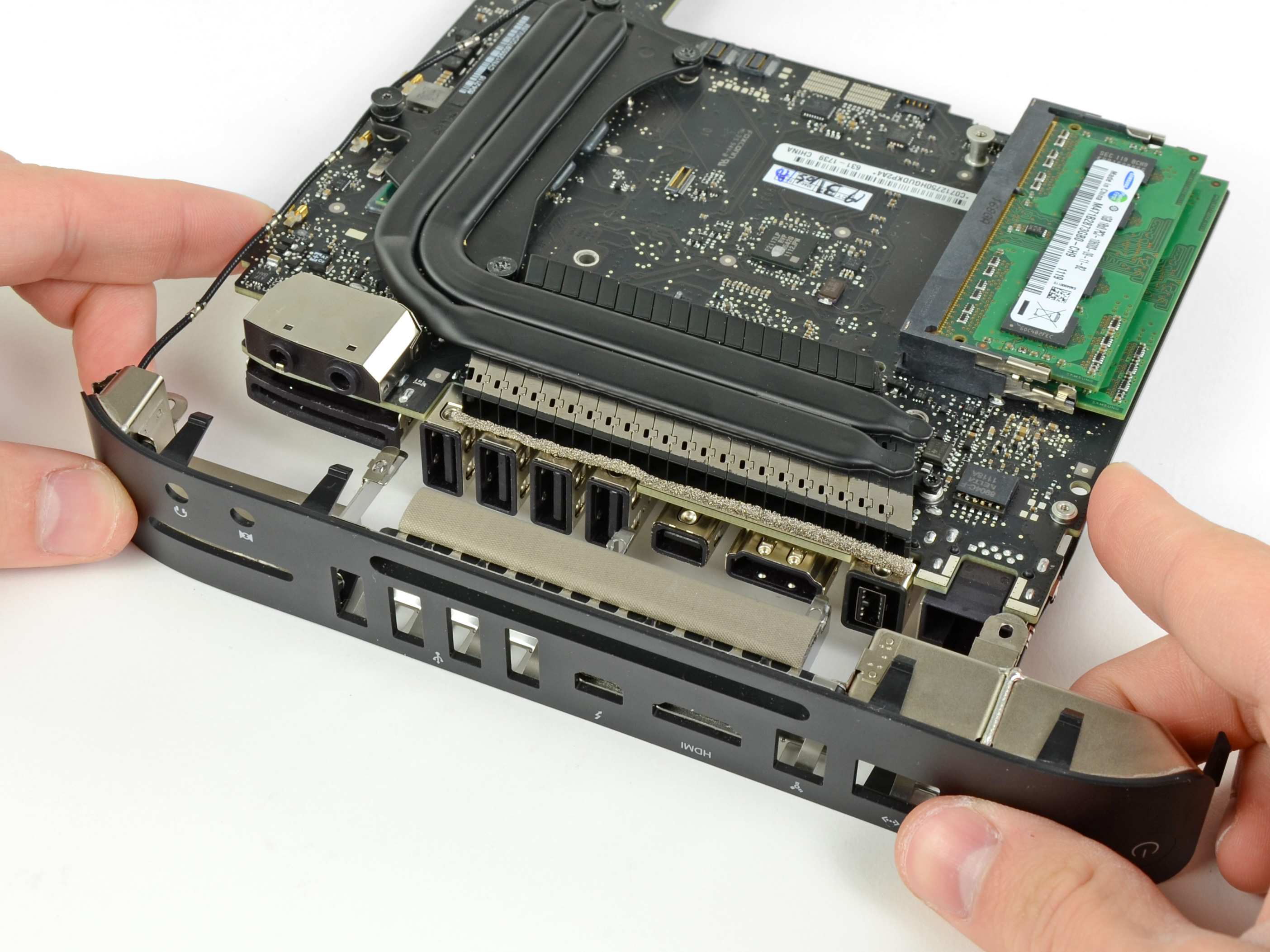

  27. Mac mini Late 2012 I/O Bezel Replacement: step 27, image 1 of 1
    • Pull the I/O bezel away from the logic board, minding any cables that may get caught.
    • Try not to handle the small steel EMI fingers on the logic board and I/O bezel, as oils from your fingers may cause interference issues. Before installing the logic board assembly, clean the EMI fingers to remove any oils transferred during the removal process.
