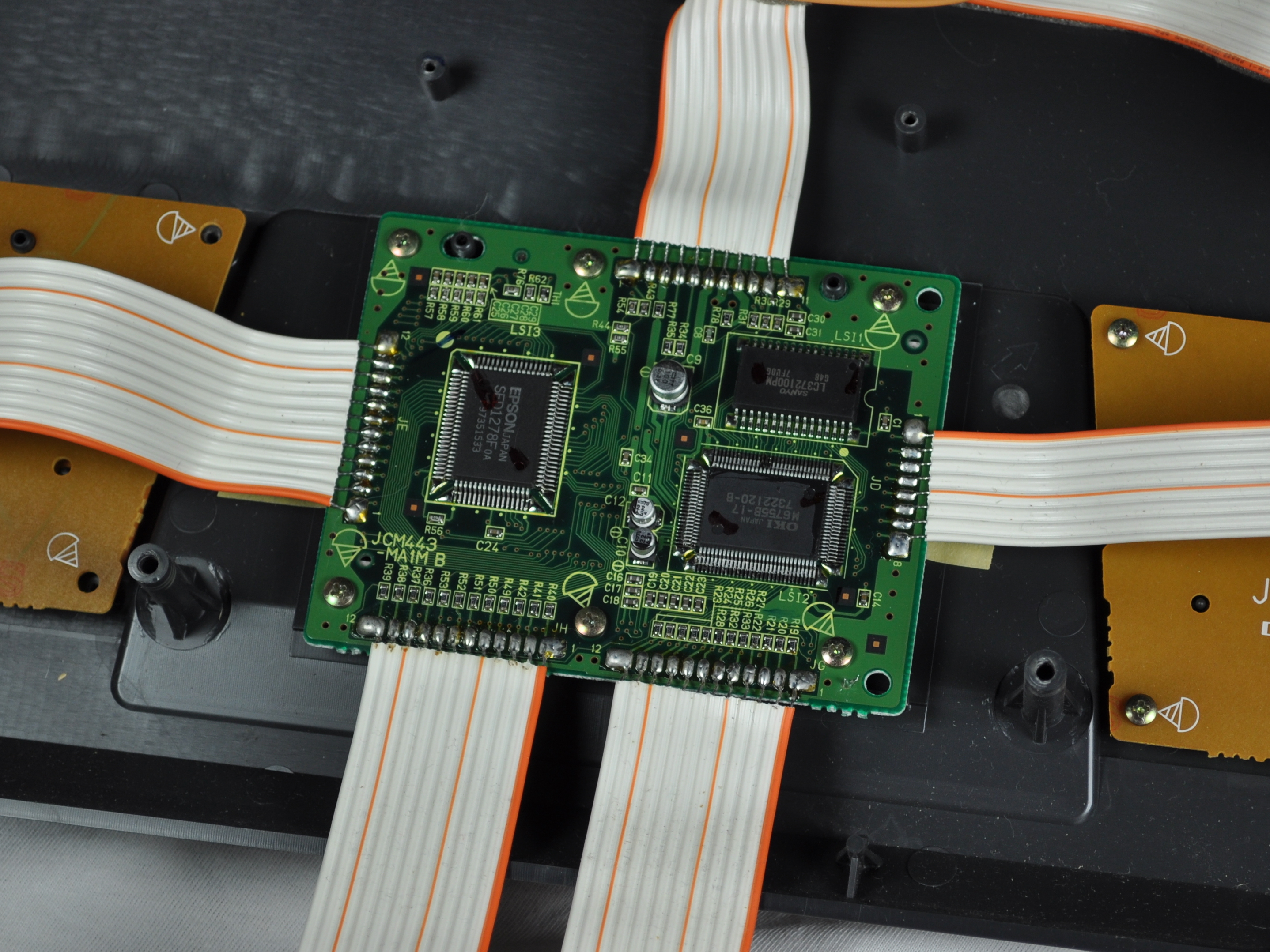

    • Completely unscrew and remove all six of the screws on the central circuit board.
  5. Casio CTK-501 LCD Screen Replacement: step 5, image 1 of 1

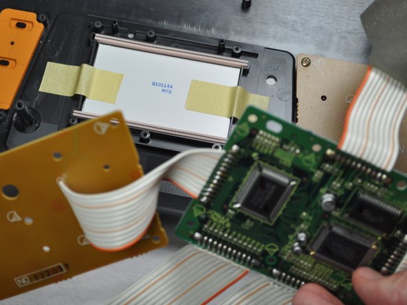

    • Lift the circuit board out of your way.
  6. Casio CTK-501 LCD Screen Replacement: step 6, image 1 of 1

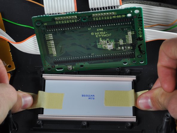

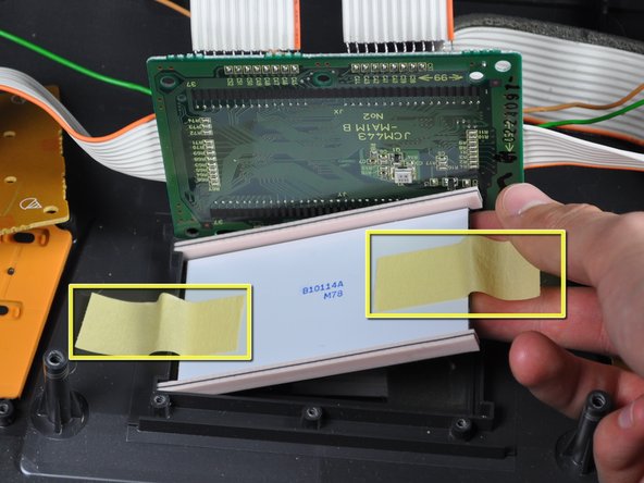

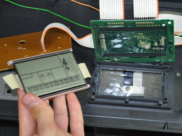

    • Remove tape from the LCD screen and remove the screen completely.
  7. Casio CTK-501 LCD Screen Replacement: step 7, image 1 of 2 Casio CTK-501 LCD Screen Replacement: step 7, image 2 of 2
    • Replace the LCD screen and tape it down to the top cover.
