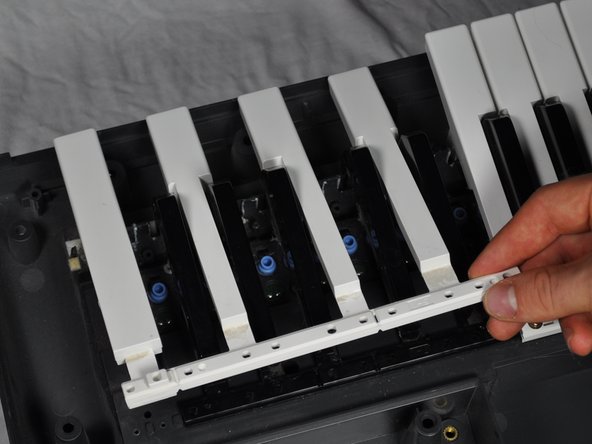

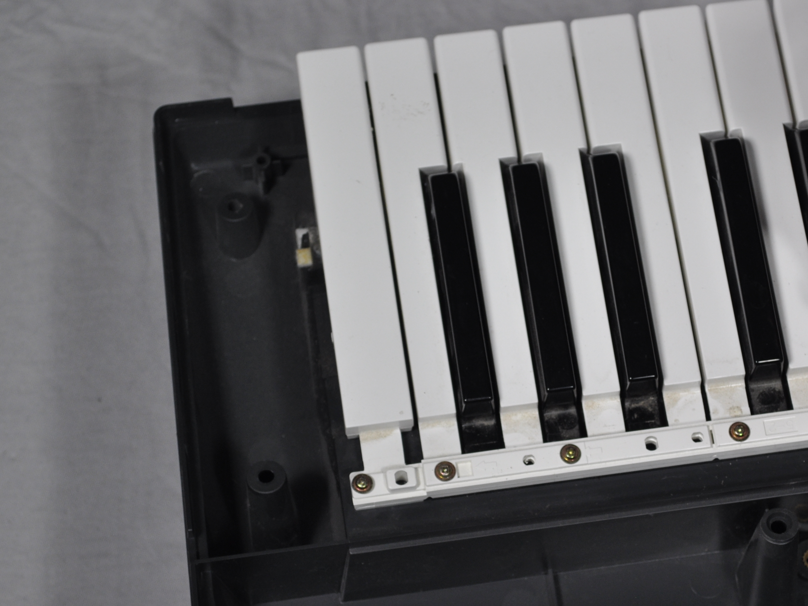

  4. Casio CTK-501 Keys Replacement, Keys: step 4, image 1 of 1
    • Completely unscrew and remove the screws holding the broken string of keys in place.
  5. Casio CTK-501 Keys Replacement: step 5, image 1 of 1
    • Pull up the top layer of white keys to remove them from the keyboard.
  6. Casio CTK-501 Keys Replacement: step 6, image 1 of 1
    • Pull up on the last layer of white keys to remove them.
  7. Casio CTK-501 Keys Replacement: step 7, image 1 of 1
    • Push the black keys toward the front of the keyboard and rotate them until they fall out of the keyboard.
