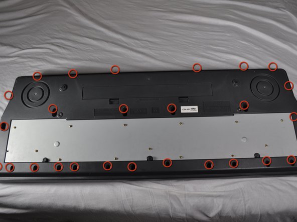

    • Flip the keyboard over so that the bottom is facing up.
    • Remove the twenty-seven 12 mm screws from the dark-grey panel using a Phillips #2 screwdriver.

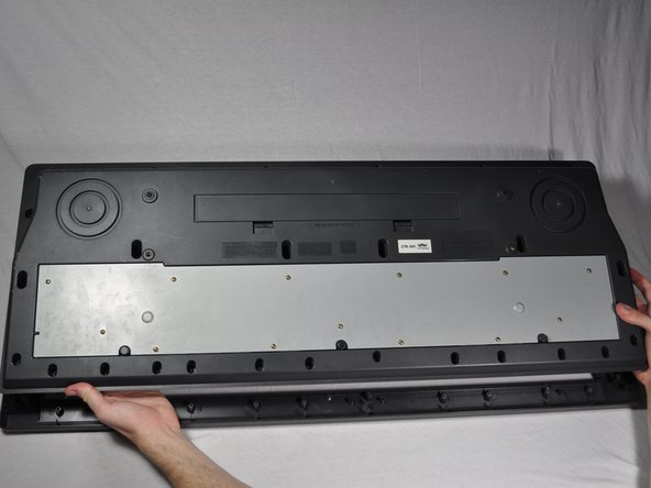

  2. Casio CTK-501 Battery Connection Replacement: step 2, image 1 of 1
    • Remove the bottom panel by lifting and pulling it towards yourself.
  3. Casio CTK-501 Battery Connection Replacement: step 3, image 1 of 2 Casio CTK-501 Battery Connection Replacement: step 3, image 2 of 2
    • Flip open the top half of the keyboard.
    • Set the keyboard onto the bottom half with the internal parts facing up.
    • Be careful not to let the bottom drop.

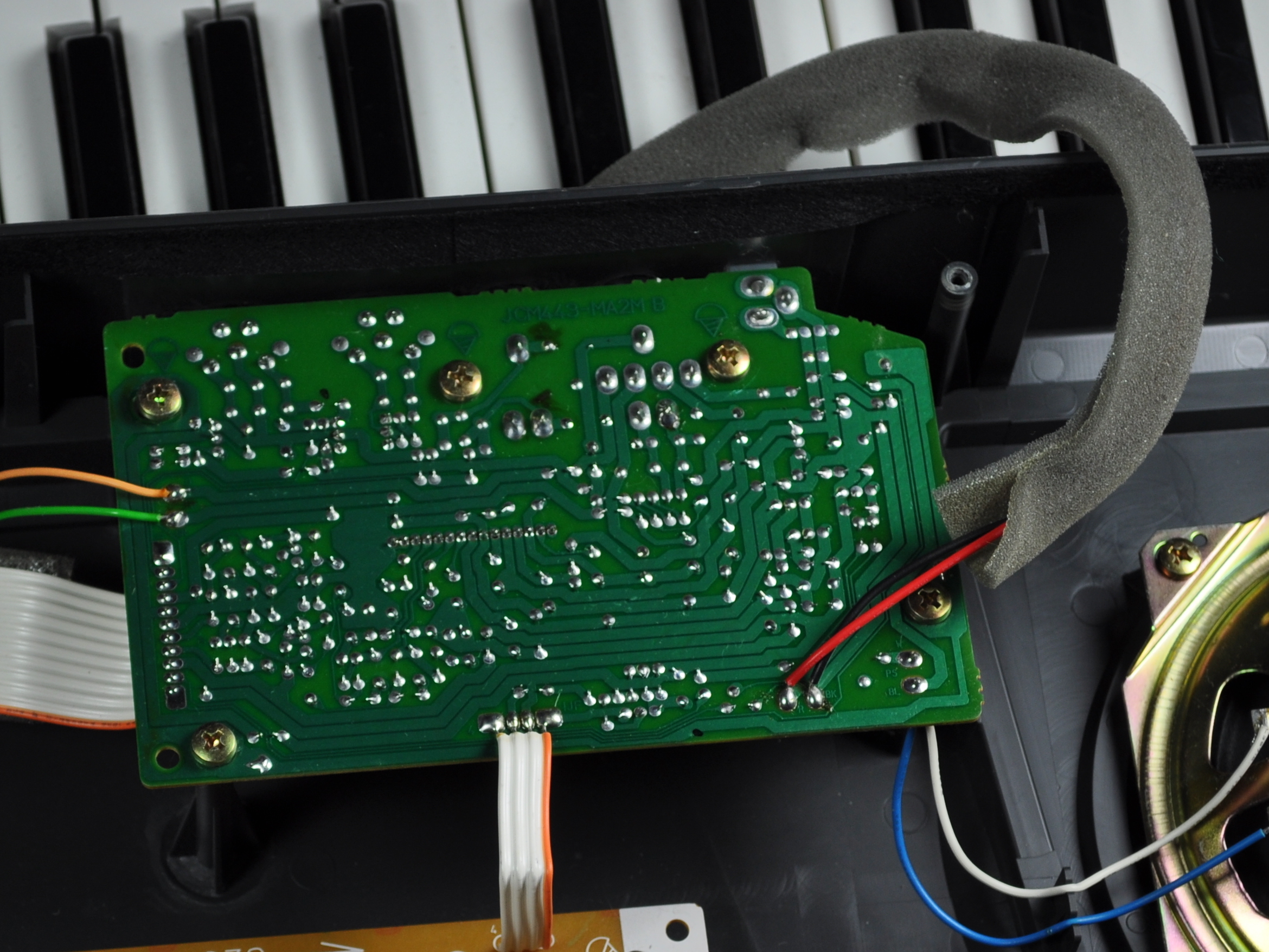

    • Unscrew the top green circuit board with black and red wires running through it.

  6. Casio CTK-501 Battery Connection Replacement: step 6, image 1 of 1
    • Heat up the solder covering the end of the wires connected to the circuit board.
    • Once the solder melts, remove the wires from the circuit board.
  7. Casio CTK-501 Battery Connection Replacement: step 7, image 1 of 1
    • Melt new solder with your soldering iron.
    • Then apply it over the tip of the wire resting on the circuit board.
  8. Casio CTK-501 Battery Connection Replacement: step 8, image 1 of 1
    • Once the wires are firmly attached, screw the circuit board back into the keyboard.
