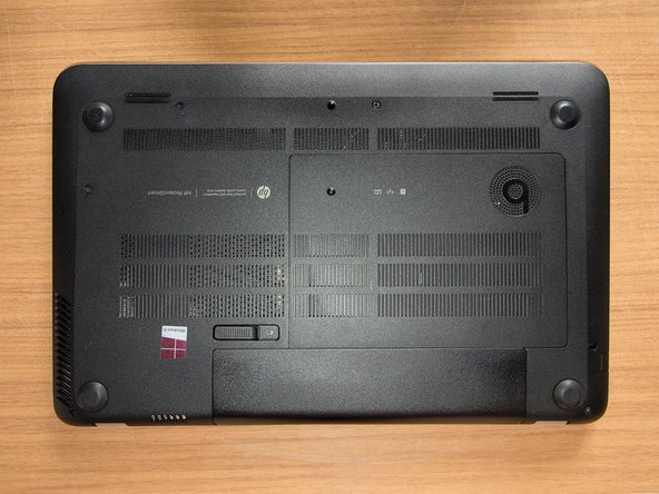

    • Turn the laptop upside down and gently lay it down on a flat surface.
    • Slide the battery release latch to the right and the battery will pop up slightly.
    • While keeping the latch slid with one hand, grab the battery with the other hand and remove it by pivoting it upward.
    • At this point some users would turn the laptop upside down once again and press the power button a couple of times. They say that this should help dissipating all of the remaining electricity around the device. Up to you :)

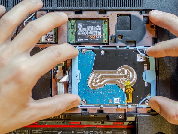

    • Are you grounded? If yes, using a spudger, flip up the small black locking flap of the hard disk's ZIF connector.
    • Afterwards, using a pair of tweezers, grab the HDD's SATA cable at the transparent tab and simply lift its end up, out of the connector.
    • By levering with an opening tool, pry the HDD out of its bay. Once it is on your hand, release its cable from its retaining hole obtained on the base enclosure and finally leave the HDD aside.

    • Are you grounded? If yes, grab the SSD as it is shown in pic#1 and align it to its connector holding it at an angle of +/- 40°.
    • Now start to gently push the SSD inside, maintaining its inclination. Follow the light blue arrow's direction and go slowly.
    • On top of the previous movement - and always maintaining the SSD tilted - you have to lightly move the module back and forward as the blue arrows show: think of a pendulum.
    • STOP when you feel you can not go any further and you can see that most of the yellow part of the connector is inside.
    • Now, pushing in the middle of it with a finger, slowly press the SSD down. The small black plastic wedge depicted has to pass through the bottom hole of the SSD in order to centre its position.
    • When pushing down, if you see that this wedge does not pass through the bottom hole of SSD, it means that you need to push the SSD further inside! (please go back to the movement of the blue arrows)
    • STOP when you feel you can't push the module any further. You should notice that the SSD is not perfectly horizontally laid, that is good. Now, using a PH#00 screwdriver and the Phillips PM 2.0x2.5 screw you got before starting this guide, secure the SSD to the base enclosure of the laptop, don't overtighten this screw.

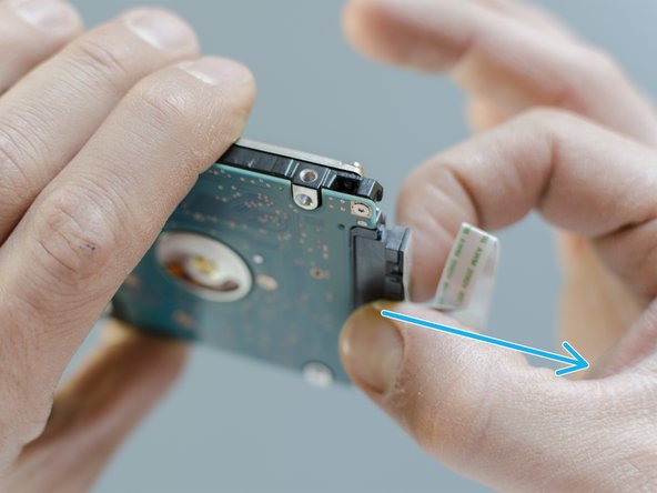

    • Now hold firmly the HDD with one hand and, with the other one, grab the SATA connector in the middle - leaving freedom of movement to its cable - and pull it out straightly and forcefully!
    • Following backwards the previous two paragraphs of this step, take now your new HDD and assemble it with the case and with the SATA connector you just disconnected.
    • The SATA connector can only be mounted in one way. In order to start off the assembling of the new HDD on the right foot, you could align it with the SATA connector as it is shown in pic#3. In this way you should be able to recognise on which side they do match: both, the long and the short sections of the connector have to face each other
