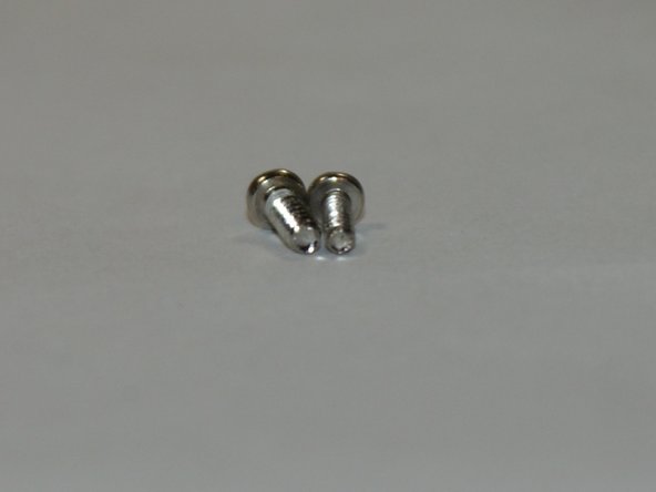

    1. Infant Optics DXR-5 Camera Lens Replacement, Camera Lens: step 4, image 1 of 2 Infant Optics DXR-5 Camera Lens Replacement, Camera Lens: step 4, image 2 of 2
      • Using a Phillips #2 screwdriver, remove the two 6.0 mm Phillips screws that hold the camera lens on.
      • These two screws have a different thread than the four screws that secure the camera unit's housing.
