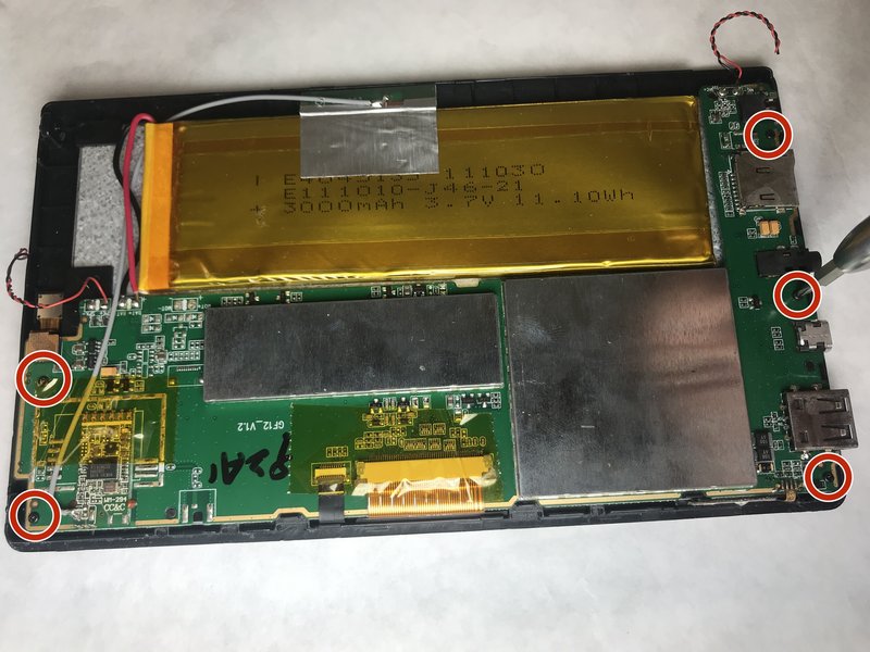

    1. Impression i7 USB Port Replacement, USB Port: step 7, image 1 of 1
      • Remove the five 5 mm screws from the motherboard, using the #0 Phillips Screwdriver.
