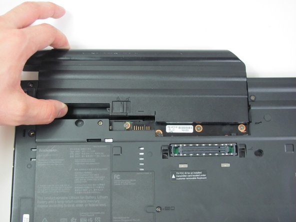

      • Turn the computer over to see the small tab on the battery located near the top of the Thinkpad.
      • Use your finger to slide the tab to the right to unlock the battery.
      Ask FixBot
    2. IBM Thinkpad T60 Wireless Card Replacement: step 2, image 1 of 2 IBM Thinkpad T60 Wireless Card Replacement: step 2, image 2 of 2
      • Once the tab is in the unlocked position (far right), pull the battery outwards away from the Thinkpad.
      • The battery is now disconnected.

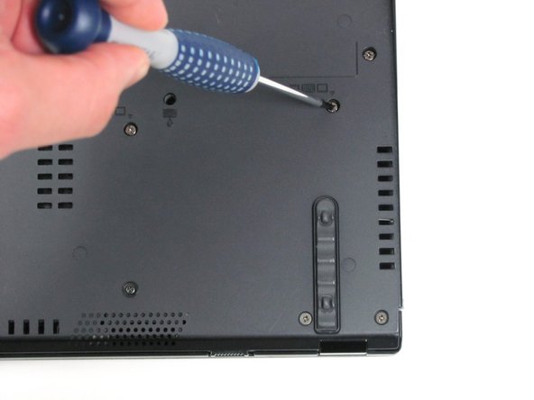

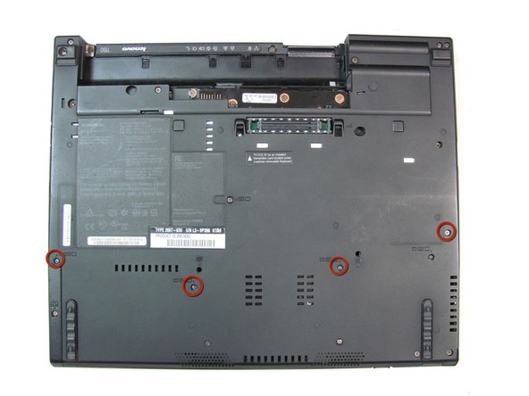

    1. IBM Thinkpad T60 Wireless Card Replacement, Palm Rest: step 3, image 1 of 2 IBM Thinkpad T60 Wireless Card Replacement, Palm Rest: step 3, image 2 of 2
      • Using a #0 Phillips screwdriver, remove the four 17.0 mm screws.

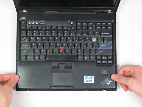

    2. IBM Thinkpad T60 Wireless Card Replacement: step 4, image 1 of 1
      • Turn the computer back over, so the keyboard is facing upwards.
      • Open the display to access the palm rest. Apply pressure to the sides of the palm rest so that it bends upwards in the middle. Gently lift away from the computer.

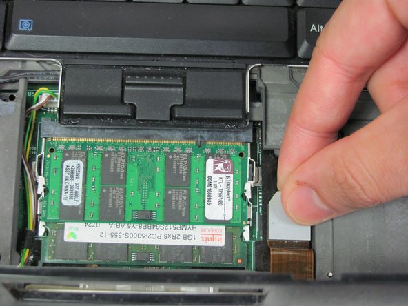

    3. IBM Thinkpad T60 Wireless Card Replacement: step 5, image 1 of 2 IBM Thinkpad T60 Wireless Card Replacement: step 5, image 2 of 2
      • Slightly lift the palm rest away from the computer.
      • The touchpad's data cable connects the palm rest to the base unit. BE CAREFUL!
      • Detach the connector by pulling upwards on the white tab.

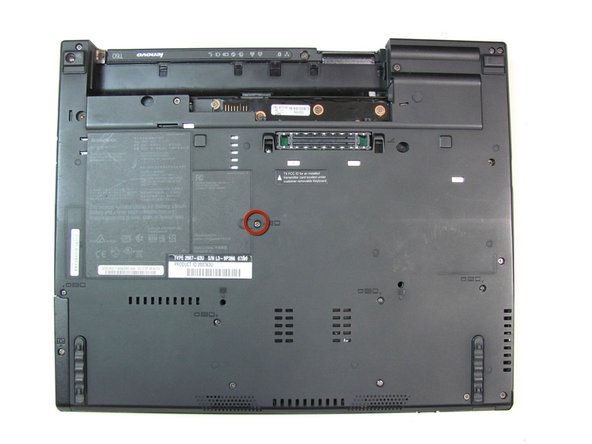

    1. IBM Thinkpad T60 Wireless Card Replacement, Keyboard: step 6, image 1 of 2 IBM Thinkpad T60 Wireless Card Replacement, Keyboard: step 6, image 2 of 2
      • Turn the Thinkpad over so you can see the bottom.
      • Using a #0 Phillips screwdriver, remove the 17.0 mm screw.

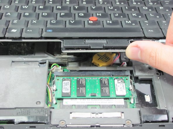

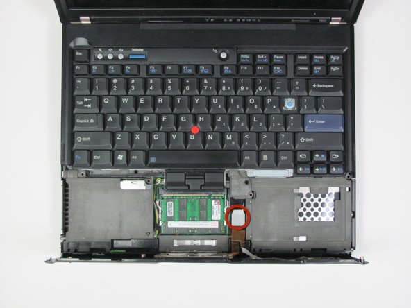

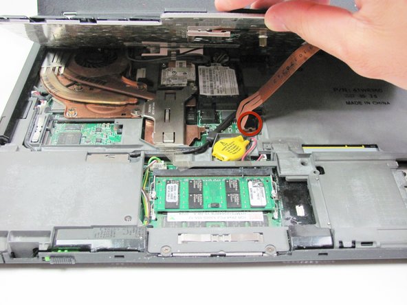

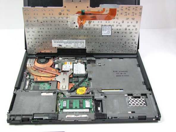

    2. IBM Thinkpad T60 Wireless Card Replacement: step 7, image 1 of 2 IBM Thinkpad T60 Wireless Card Replacement: step 7, image 2 of 2
      • First, flip the laptop back over. Next, use your fingers to pry the keyboard upwards slightly.
      • Lift the keyboard until you are able to see the wire connection
      Ask FixBot

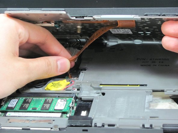

    3. IBM Thinkpad T60 Wireless Card Replacement: step 8, image 1 of 2 IBM Thinkpad T60 Wireless Card Replacement: step 8, image 2 of 2
      • Pull upwards on the connector to disconnect the keyboard.
      • The keyboard is now disconnected.

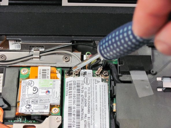

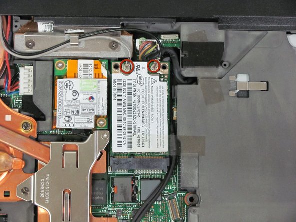

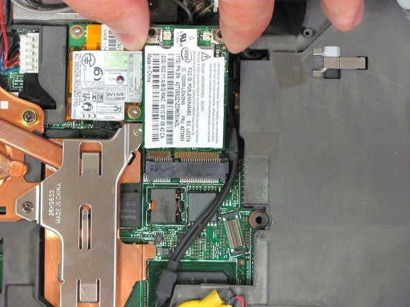

    1. IBM Thinkpad T60 Wireless Card Replacement, Wireless Card: step 9, image 1 of 2 IBM Thinkpad T60 Wireless Card Replacement, Wireless Card: step 9, image 2 of 2
      • Using a #0 Phillips screwdriver, remove the two 10.5 mm screws.
      Ask FixBot

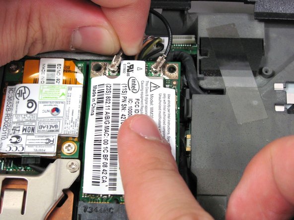

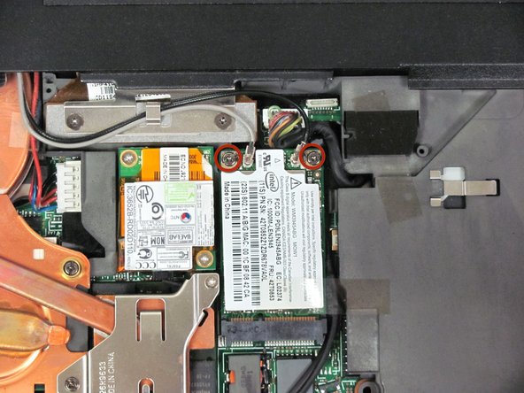

    2. IBM Thinkpad T60 Wireless Card Replacement: step 10, image 1 of 2 IBM Thinkpad T60 Wireless Card Replacement: step 10, image 2 of 2
      • Disconnect the two connectors by pulling upwards on the base of the grey and black cables.
      Ask FixBot

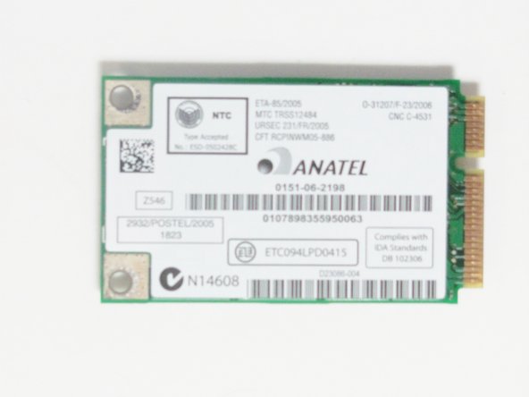

    3. IBM Thinkpad T60 Wireless Card Replacement: step 11, image 1 of 1
      • Grasp the sides of the card and pull perpendicular to the slot.
      • The wireless card is now disconnected.
