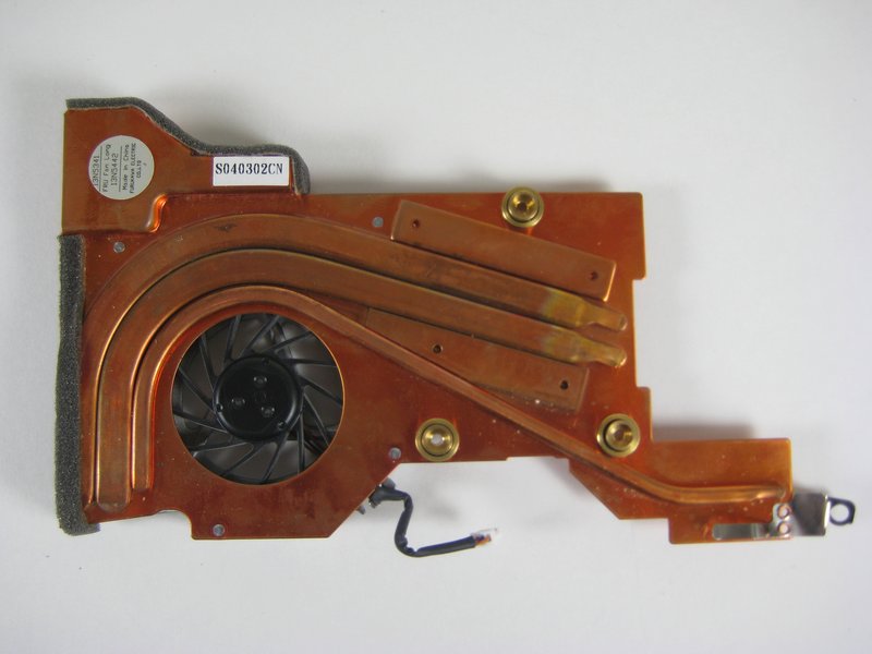

    1. IBM ThinkPad T41 Fan Replacement, Fan: step 26, image 1 of 1
      • Unsnake the black cable from the black plastic frame.
      Ask FixBot
    2. IBM ThinkPad T41 Fan Replacement: step 27, image 1 of 1
      • Remove the sheet metal piece, which was underneath the modem.
      Ask FixBot
    3. IBM ThinkPad T41 Fan Replacement: step 28, image 1 of 1
      • Remove the rubber microphone cover in the upper left hand corner by lifting up the gray metal frame.
      Ask FixBot
    4. IBM ThinkPad T41 Fan Replacement: step 29, image 1 of 1
      • Lift away the gray metal frame.
      Ask FixBot
    5. IBM ThinkPad T41 Fan Replacement: step 30, image 1 of 1
      • Remove three screws near the edge of the computer, holding the optical bay and HDD covers.
      • Remove three other screws on the other side of the covers.
      • You should have six screws in total, three of one size and three of another size.
      Ask FixBot
    6. IBM ThinkPad T41 Fan Replacement: step 31, image 1 of 1
      • Lift out the optical bay and HDD covers.
      Ask FixBot
    7. IBM ThinkPad T41 Fan Replacement: step 32, image 1 of 1
      • Lift out the black plastic frame.
      Ask FixBot
    8. IBM ThinkPad T41 Fan Replacement: step 33, image 1 of 1
      • Unplug the fan from the motherboard.
      Ask FixBot
    9. IBM ThinkPad T41 Fan Replacement: step 34, image 1 of 1
      • Remove the three screws on the fan.
      Ask FixBot
    10. IBM ThinkPad T41 Fan Replacement: step 35, image 1 of 1
      • Lift the fan out.
      Ask FixBot
