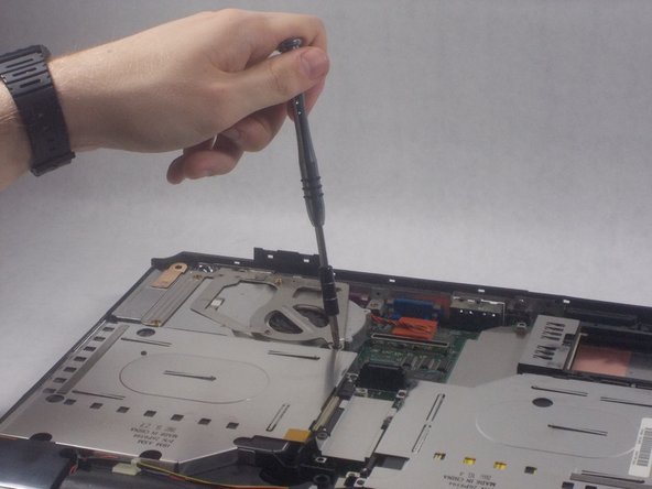

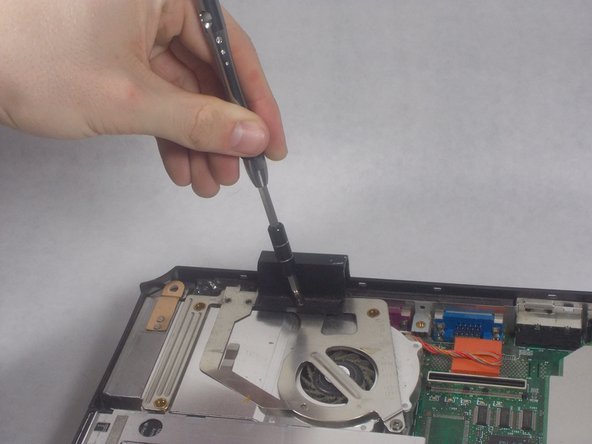

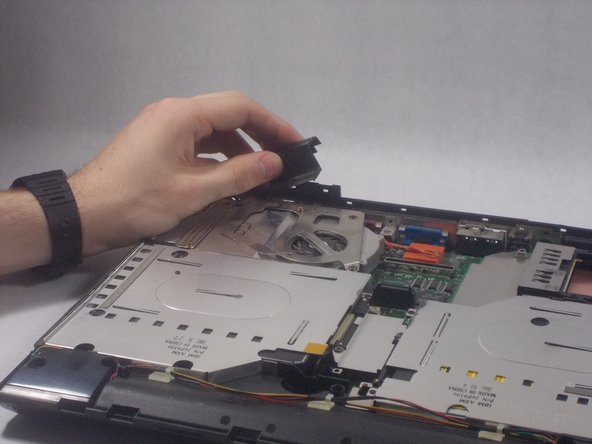

    1. IBM ThinkPad A31 CPU Replacement, CPU: step 11, image 1 of 3 IBM ThinkPad A31 CPU Replacement, CPU: step 11, image 2 of 3 IBM ThinkPad A31 CPU Replacement, CPU: step 11, image 3 of 3
      • Remove the 6mm screw
      • LIft the bracket out
      Ask FixBot

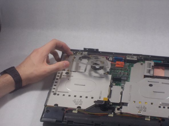

    2. IBM ThinkPad A31 CPU Replacement: step 12, image 1 of 3 IBM ThinkPad A31 CPU Replacement: step 12, image 2 of 3 IBM ThinkPad A31 CPU Replacement: step 12, image 3 of 3
      • Remove one 6mm screw
      • Remove 3 18mm screws
      • Take off the bracket on the CPU fan
      Ask FixBot
